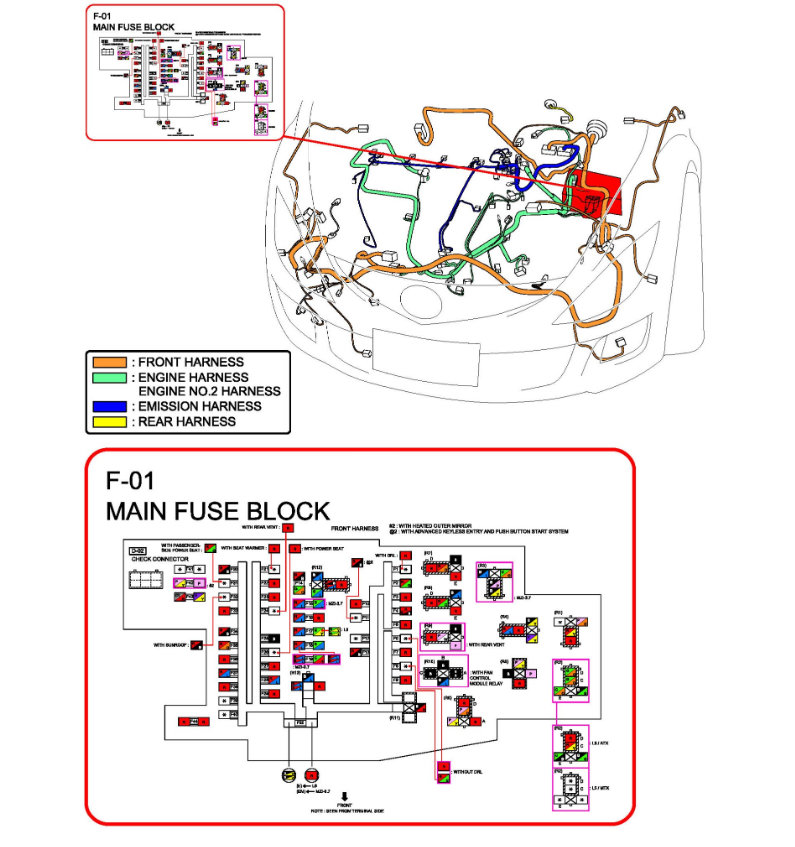

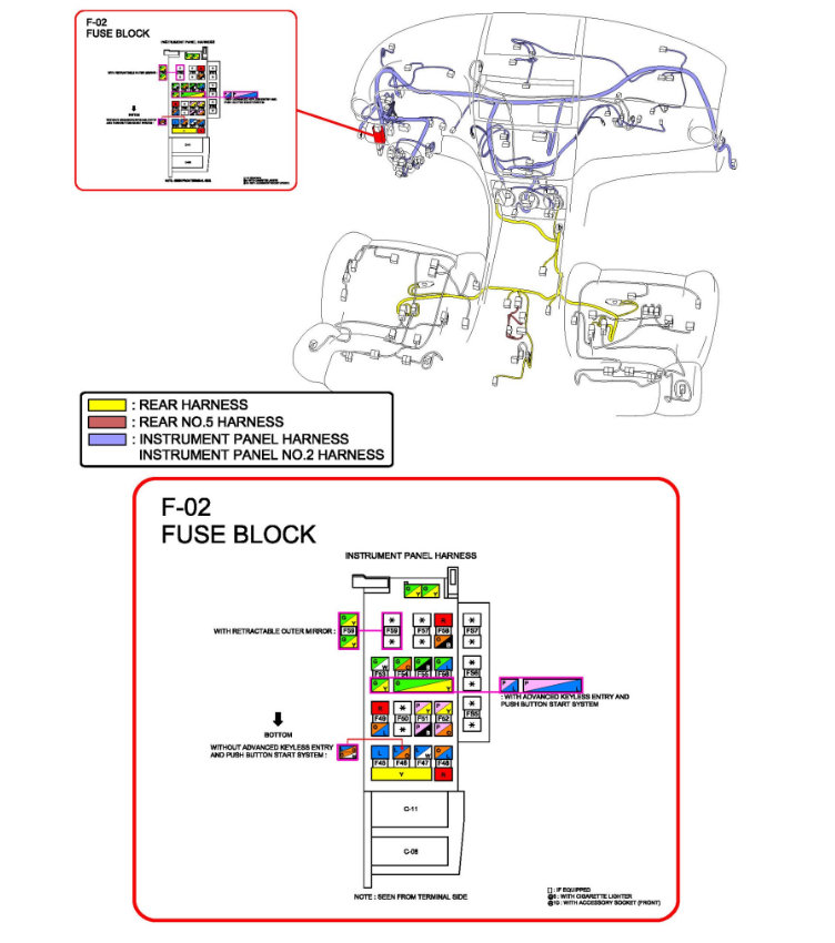

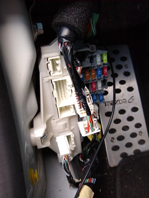

Hi Group!
I read in many forums that the possible cause could be the BCM.

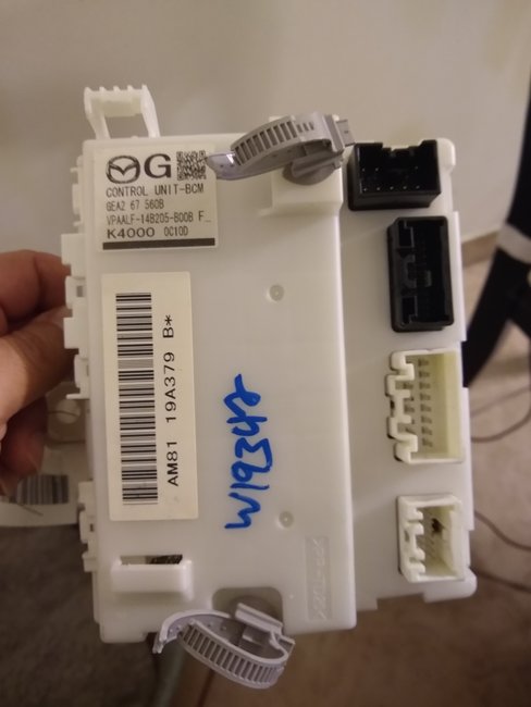

After checking the fuses and light bulbs I went ahead and bought a used BCM.
I installed it but the problem persist, now I put my original BCM back in the car.
I'm not sure where else to look.
Please help.
Thanks!
Apr 18, 2020 at 11:38 AM
  • 55,273 POSTS

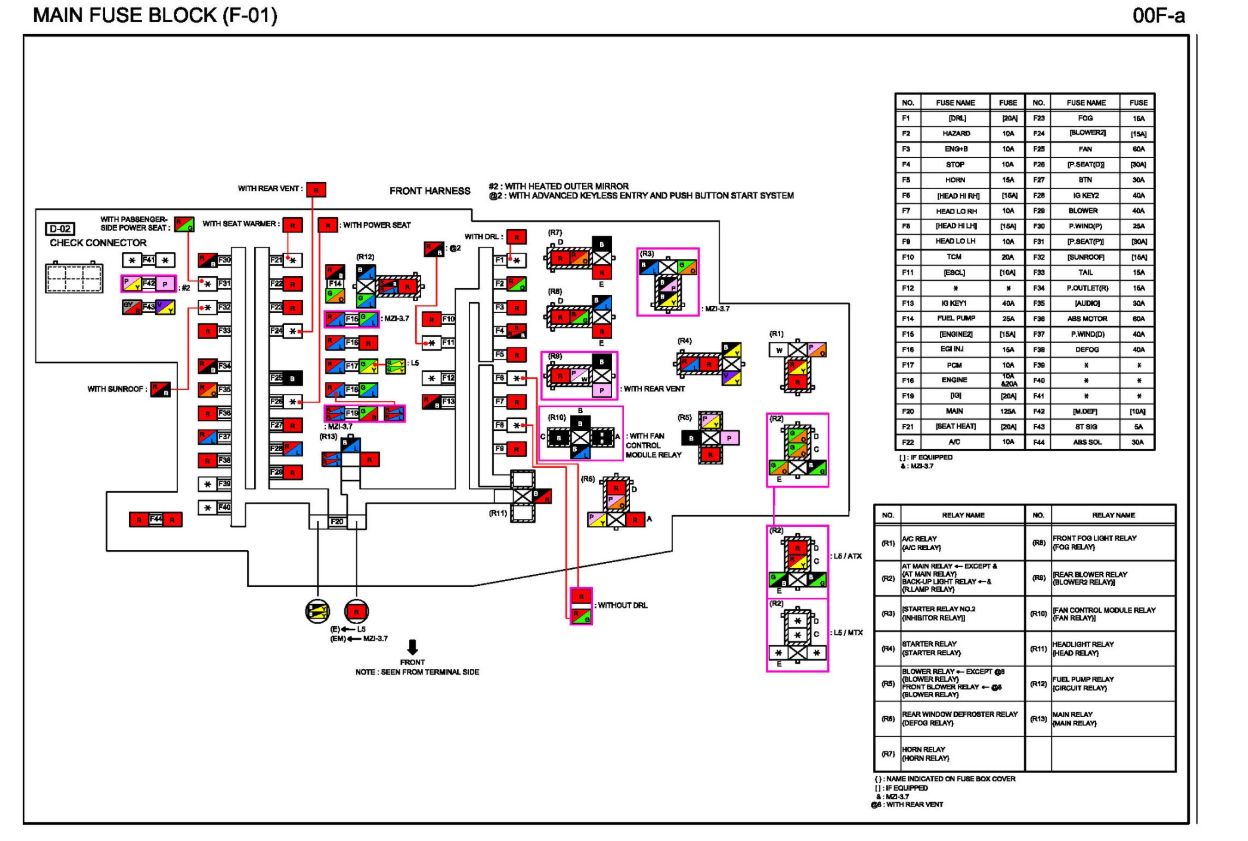

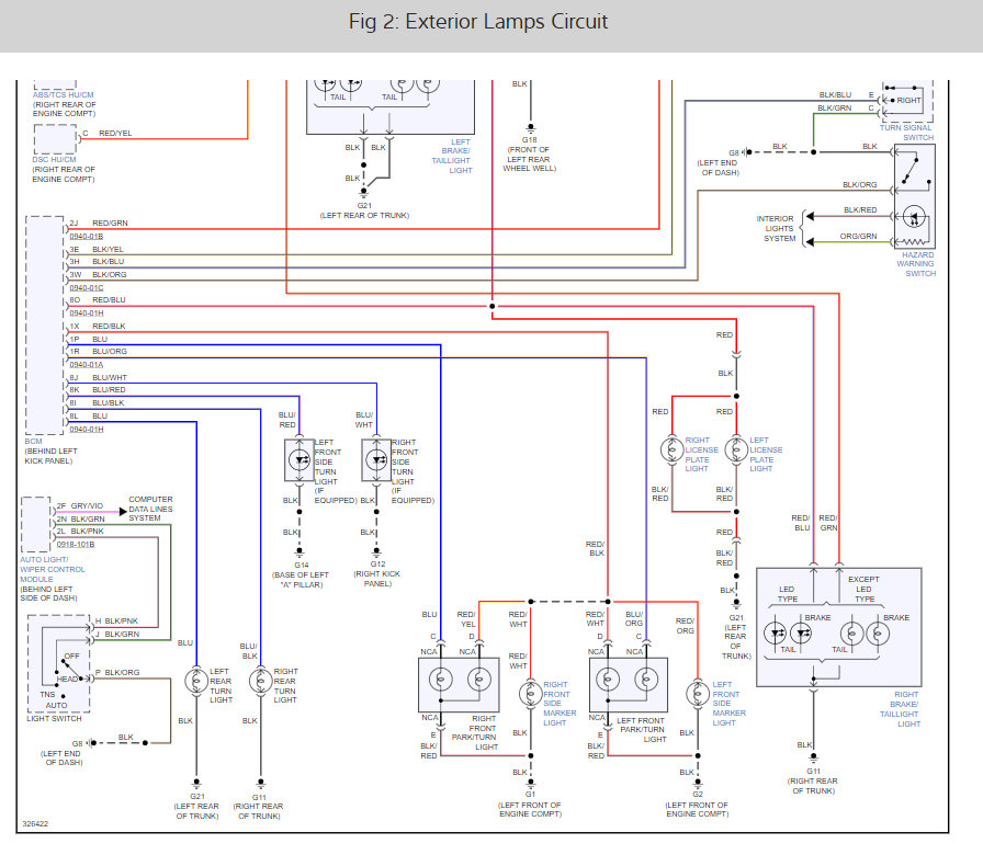

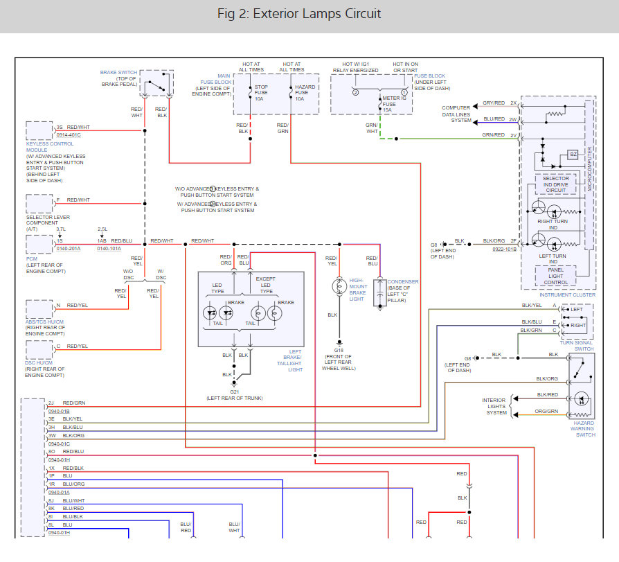

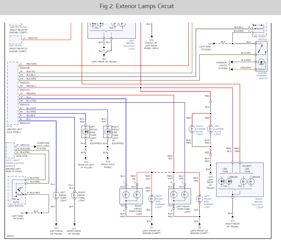

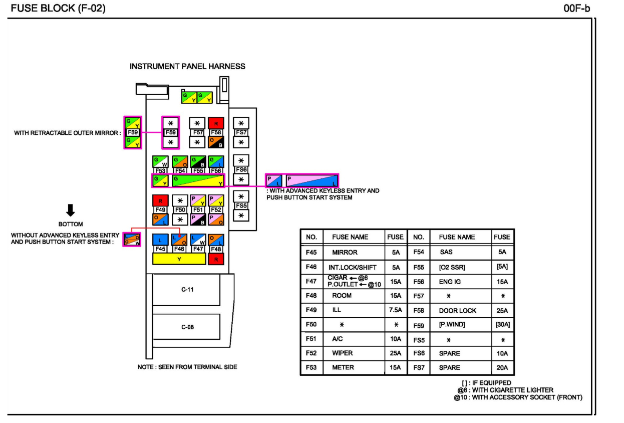

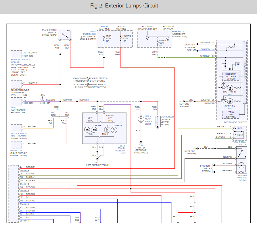

Lets start by making sure there is power at the stop and hazard fuses. here is a guide to help you, the key should be on before you begin. Also I have included the fuse location and the blinker and hazard light wiring diagrams so you can see how the system works.

Hello group,
I went and got another continuity tester and tested the fuses again and this time the hazard fuse did not work.
Learning lesson: Use more than one tester.
May 2, 2020 at 1:45 PM
  • 55,273 POSTS
When you replaced the fuse did it work? Tester can mislead us when they dont work DOH!
