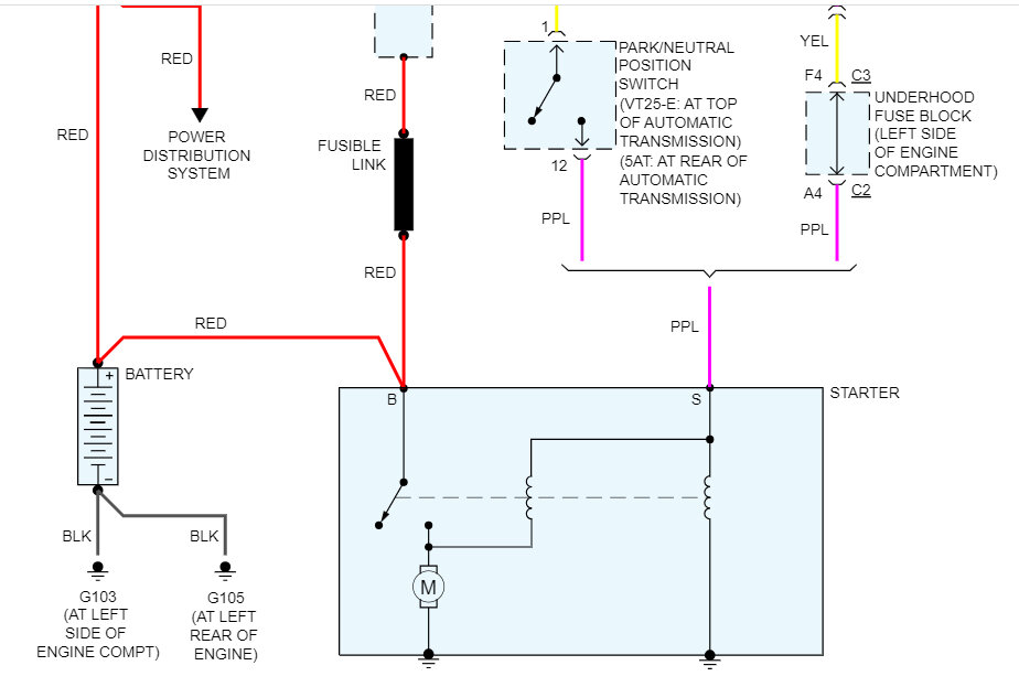

I saw wires that have no coating, could they be shorting out my starter. I'm having difficulties with my vehicle trying to start. At first it did start but then it clunked, turned off the ignition, started again, no problem. Now it does not start, I heard a click. Then no more. Random. Battery, electronic ignition module the coil pack, the alternator all good or brand new.
I'm wondering if these wires are not causing the problems, if maybe shorted out starter.

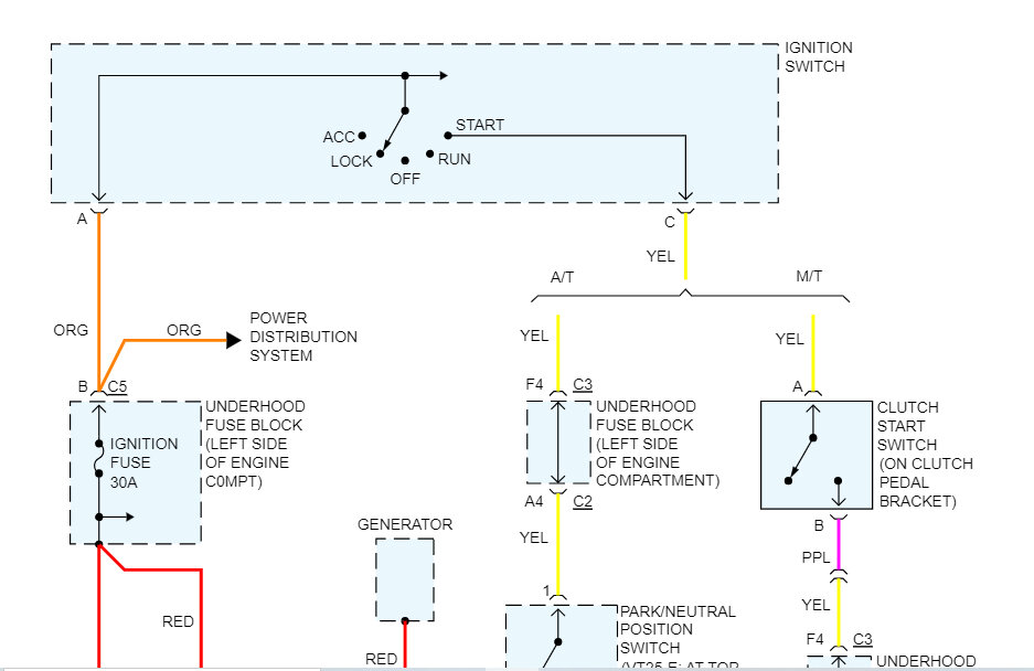

In addition, there are multiple problems with my ignition switch. It was recalled and I replaced it three times. I need to replace it again. It keeps shredding my keys. I'm a concerned that maybe my engine locked up?

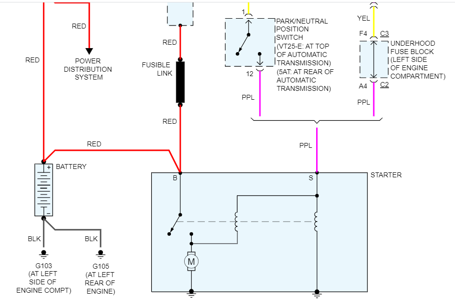

For some reason, the pics didn't upload. Where are they located and if there is any insulation left on them, what color is it?
I attached the starter circuit wiring schematic below so that you have a reference. Are any of the wires on the schematic match what you are seeing?
See pics below. Note: I had to cut the schematic in half to make it readable. I did overlap the two.
