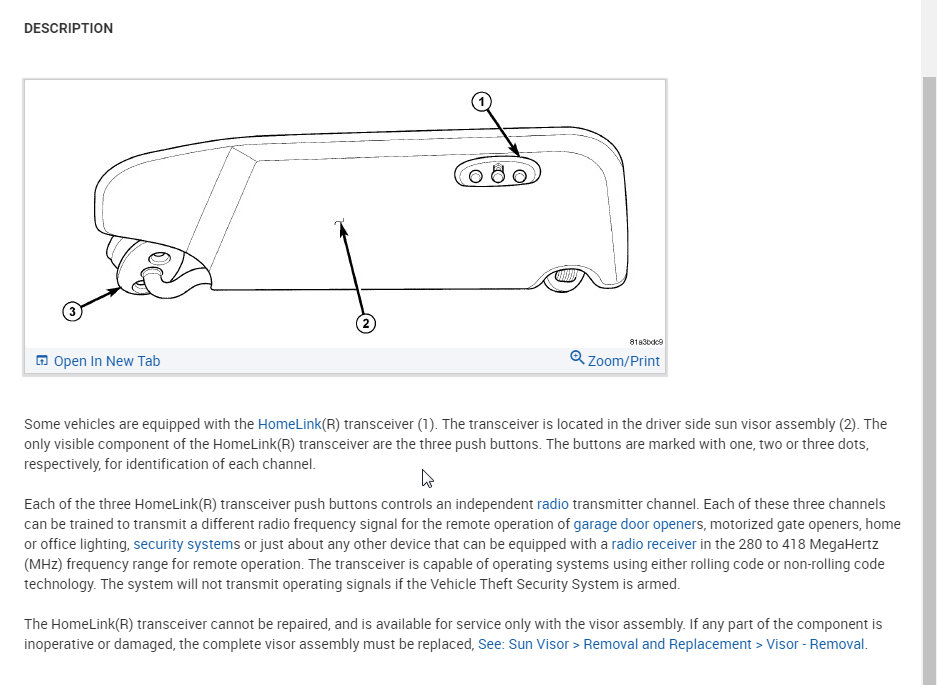

You may be right on with this one. When you open the door to the vehicle and disarm the theft system is when the home link system is active. If the theft system is on, this doesn't not operate. I suspect the button is shorted causing these crazy issues.

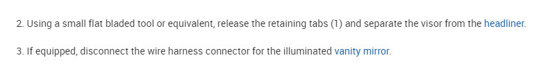

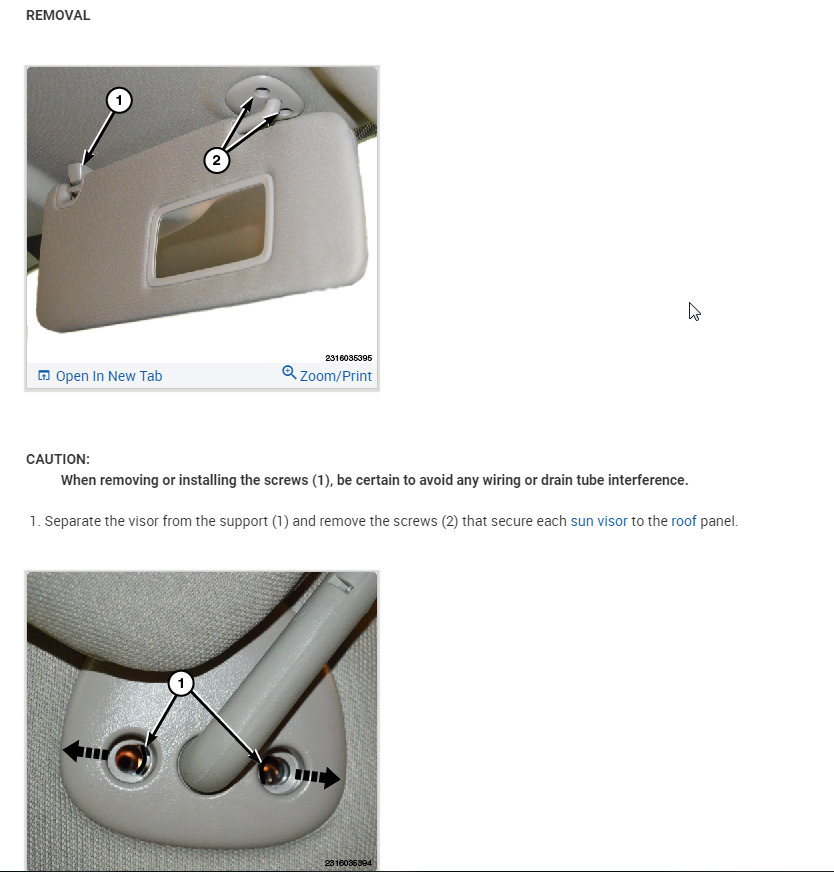

The only thing that you are a little off on is this is not linked to the BCM. This system operates by itself in the visor. It is simply a radio frequency that the garage door picks up. I attached the info about this system but in order to correct it, you would need to replace the visor.
I agree with you that I would clear the codes and see if that stops the crazy behavior. If not, it is because the radio frequency that the visor is putting out is the same as your door. So you could change the code for your door and other remote and see if that does the trick.
Let me know if you have questions. Thanks
