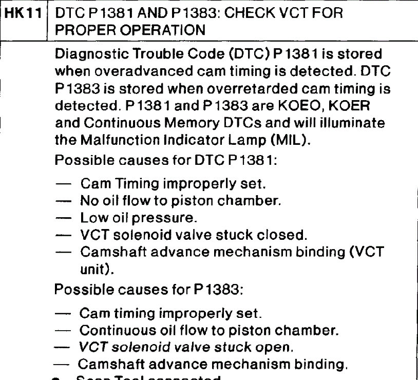

1998 Ford Contour how do I fix code p1383?
Sunday, March 8th, 2020 AT 10:10 AM
  • 109,885 POSTS
If you look at pic 1, it shows possible causes for a P0383.

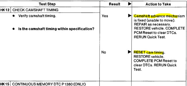

I read through several repair / pinpoint checks for you and the first thing that is suggested is to check the cam timing. That means checking the timing.
Before we jump the gun, is the engine oil clean and full? Has it been serviced on a regular basis or does is it possible that it could be sludged up inside? This could be a low oil pressure related issue, that's why I ask.
Let me know. Also, as far as testing the catalytic converters, yes to removal of the O2 sensor. It has to be one before the converter. I tell people that all the time. Here is a link that shows in general how to test one, but I believe it recommends removal. Keep in mind, the O2 sensor will only allow a small amount of air to exit, so it won't be perfect. However, if the converter is the issue, you should notice a difference.

Throwing code p1383 how do I fix it? It says timing too far retarded.
Monday, March 9th, 2020 AT 12:00 PM
  • 109,885 POSTS
Here is a list of possible causes. Let me know if you have checked any of them.
Cam timing improperly set
VCT solenoid valve stuck open
Camshaft advance mechanism stuck
