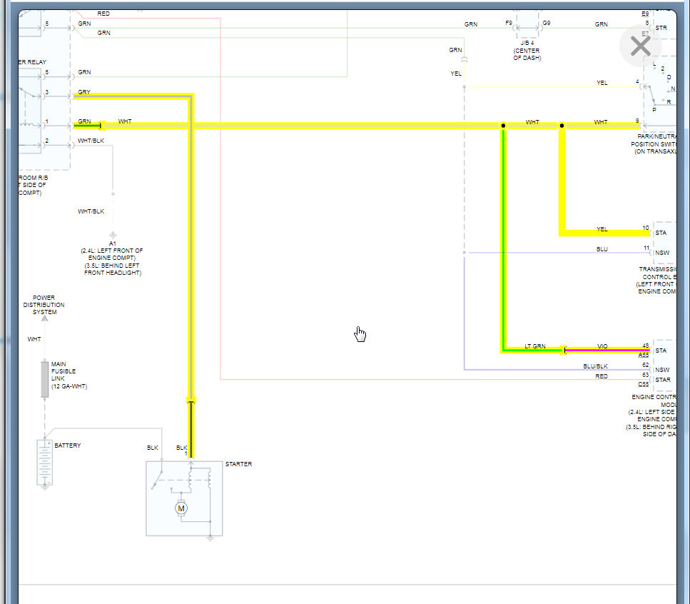

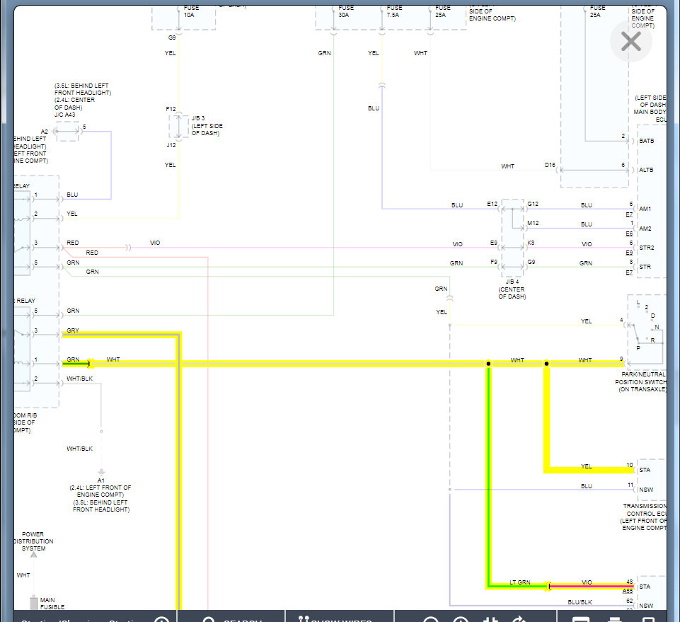

If the starter is not working then I would start with that. Assuming this vehicle has smart key and not a hybrid here is the diagram for the starting system.
Here is a guide that helps with this as well:
We need to test for voltage on the control wire and when it is not there when cranking we go back to the relay and find out if you have signal from the ECM to ground the relay to engage the starter.
Below is the wiring diagram. Let us know what you find with this. Thanks

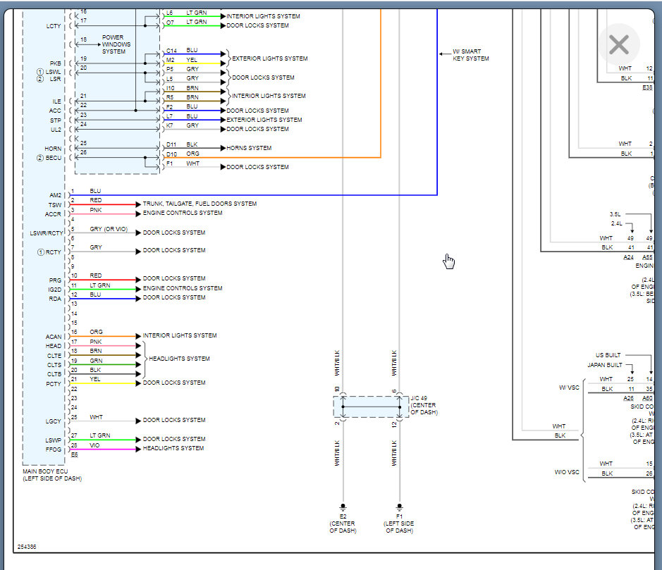

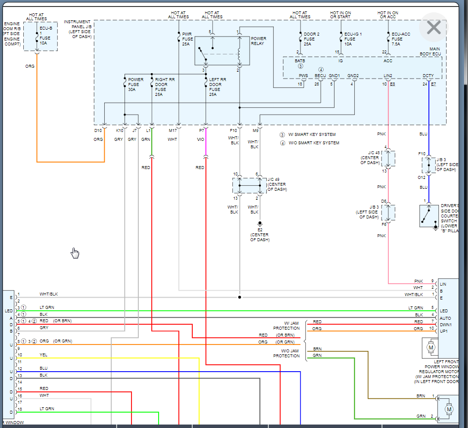

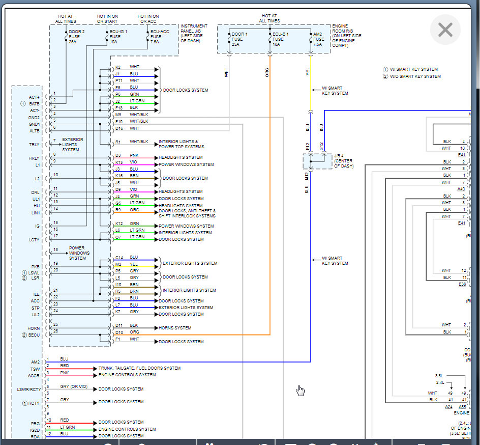

The only thing that these have in common is a main body ECU on the left side of the dash. So again, I would pick one of these systems and check for voltages coming from the ECU. If none, I would replace it and retest all the systems.
See the wiring diagrams below.
