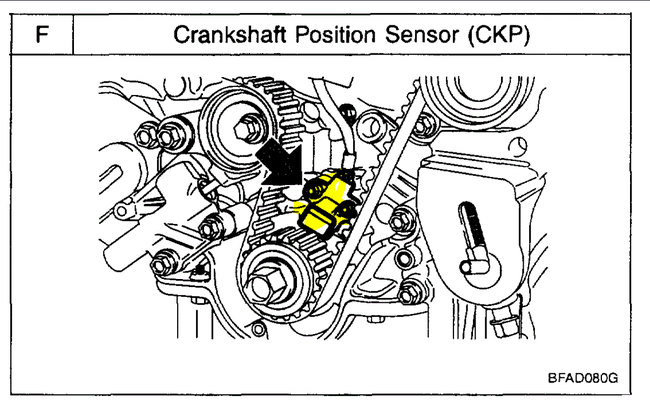

They broke a bolt in the harmonic balancer, we got bolt out, put new harmonic balancer on. Now it will not start. It will turn over like it wants to start, but it won't start. The fuel pump is not priming itself but when you try to start it the fuel pump is pumping fuel. Please any ideas??

When this happened, was the timing belt cover removed?
What I need you to do is check for ignition spark to the plugs. I have a feeling something was missed on reassembly or the crankshaft position sensor is unplugged. That would cause loss of spark and fuel on this vehicle.
Here is a link that explains how to check for spark:
If you have a scan tool that can read live data, check to see if there is an RPM signal when cranking the engine. Also, if you haven't already, scan the computer to see if there are any diagnostic trouble codes stored in the system.
I also need to know if the bolt broke while the engine was running.

They were trying to change the harmonic balancer when bolt broke, so I'm going to say, no the engine wasn't running. The timing belt cover was never off. I'm going to go check the crankshaft position sensor.

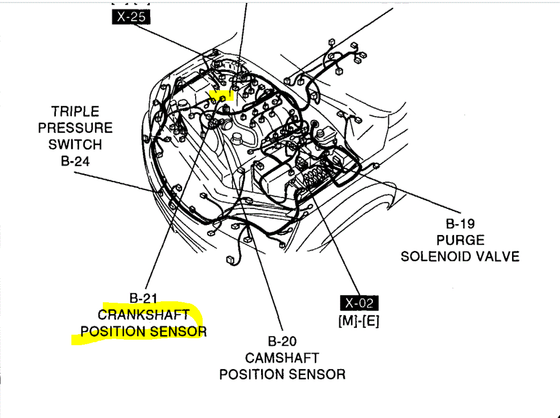

I attached two pics below. Note the sensor is behind the timing cover. Pic 2 shows the connection location.
If you can, check to see if there is spark to the engine.
