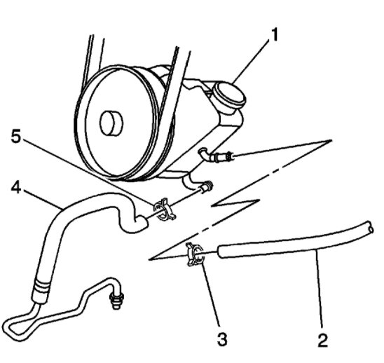

Hey, just recently it became hard to turn when idling. If I am driving and get the rpm's up a little bit it makes it easier. Just trying to figure out if the pump that is a year old is going out again or if its something like the rack and pinion or box. Fluid is good, it only has a small whine if i turn it completely and hold it besides that doesn't make a noise. thanks

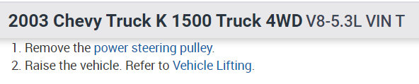

That sounds like a pump issue as opposed to the steering gear. How many miles were put on the truck after you replaced the pump a year ago? When you replaced the pump was it new or re-manufactured? My 1989 K1500 only had 79,000 original miles and the same thing happened. If you want I can attached repair guides on how to replace the steering pump. Hope this helps and thanks again for using 2CarPros.

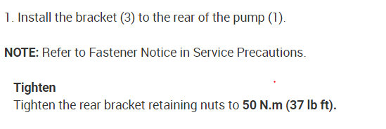

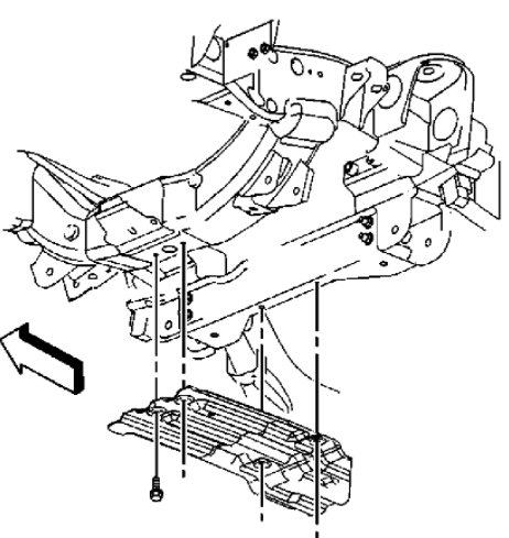

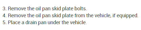

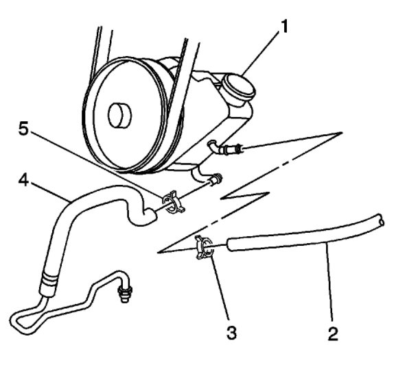

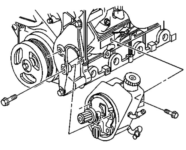

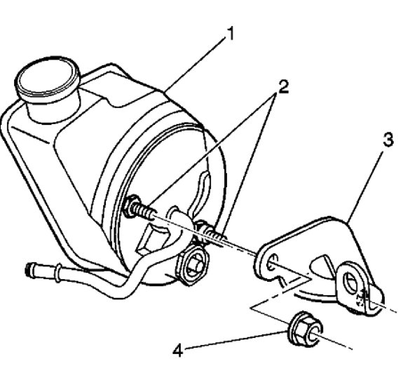

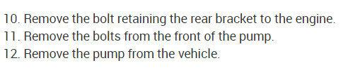

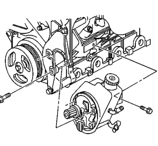

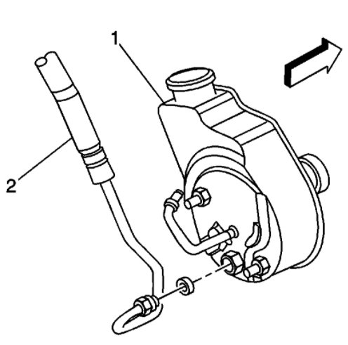

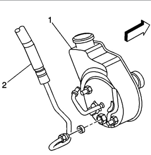

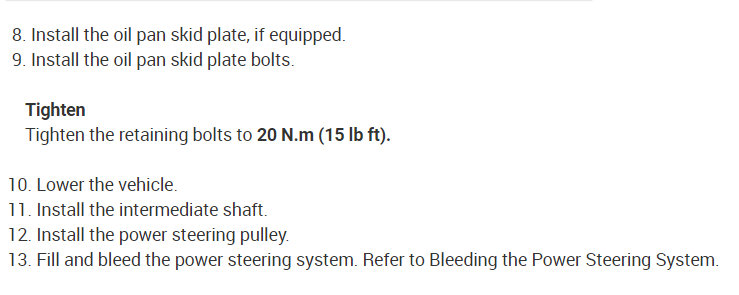

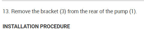

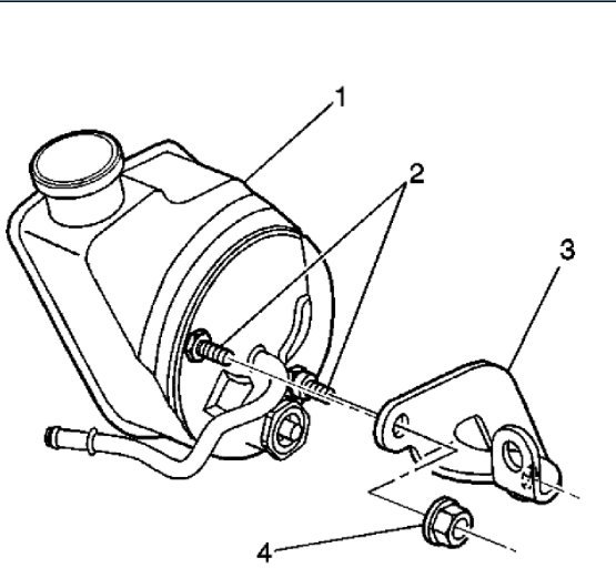

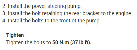

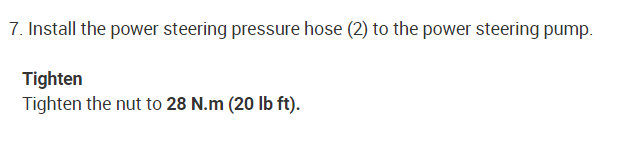

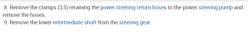

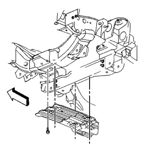

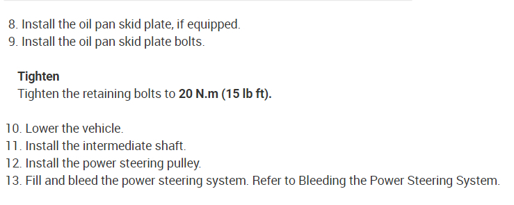

As far as bleeding the system I don't recommend leaving the cap off. Just turn the steering all the way left to all the way right repeatedly for about 10 minutes or until all air bubbles are gone. Just be sure to keep an eye on the fluid level to keep topped off. I've attached picture steps below for your truck if needed. Keep us updated and let more know if you have any further questions about this issue. Hope this helps and thanks again for using 2CarPros.
