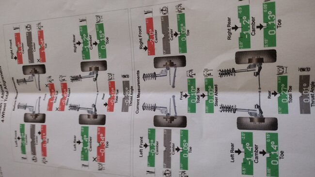

Here's the printout from the alignment. Please let me know if you receive it. Thanks. JC

The first thing I look at is how the computer is set up. I had all of my values show up with two places after the decimal point for more accuracy. The trade-off is it takes more time to set each adjustment with that much more precision. Your camber readings are only reading to one decimal place, but the right front is so far off, that isn't a concern now.
Over the years I've found most front-wheel-drive vehicles need 0.06 degrees more positive camber on the left wheel to offset "road crown". That's the tilt of the road surface so rain runs off. Most vehicles will drift to the right if that 0.06 degrees isn't adjusted in to compensate for it. When only reading to the tenth of a degree, you can have too little offset or too much, and both could get rounded off to a wrong difference.
In this case, you have minus 2.0 degrees on the right and minus 0.2 degrees on the left. That's a difference of 1.8 degrees which will cause a huge pull to the left. Remember, the tires want to pull in the direction they're leaning. The left wheel is tipped in a little on top, but it's within the allowable range of tolerance. It will cause a slight pull to the right. The right wheel is the problem. At 2.0 degrees, you should be able to stand in front of the car, look back at that wheel, and easily see that it's tipped in on top. That one will cause that really hard pull to the left.

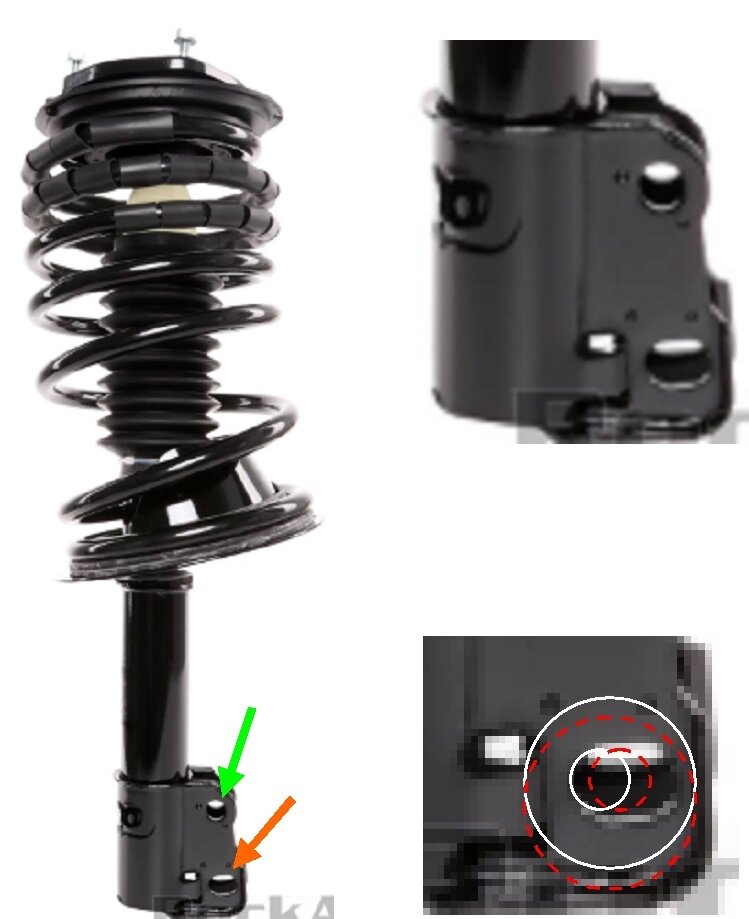

The photo below shows what your front strut assembly looks like. It's hard to see, but my red arrow is pointing to one of the two lower mounting holes that is oval-shaped to allow camber to be adjusted. Chrysler and GM use the lower hole. On GM vehicles, that lower hole has to be ground out to allow an adjustment to be made. Some mechanics won't take the time to do that. Once reassembled, those two bolts are loosened, the wheel is pushed or pulled to position, often many times before we call it "good enough", then the bolts are tightened. On Chryslers, the lower hole is elongated from the factory, and special "cam bolts" with offset heads are used. The adjustment can be set very precisely by rotating, then tightening that bolt.
At a minimum, camber can be adjusted on your car, but if it still has the original struts, that upper hole might have to be ground out. It's already elongated on this aftermarket replacement strut in the photo. Next, those offset cam bolts are available as an aid to the technician, but at extra cost if they didn't come with them from the factory. Either way, I could never justify sending a customer out with the right front wheel like that.
I see that he did fix left rear "toe". That's the direction the wheels are steering. I had my computers set up to read all toe values in inches. Here it's in degrees. One inch of toe-in is the same as two degrees, so starting out with minus 0.34 degrees on the left rear, that equates to 0.16 inches. That wheel is steering away from the center of the car, meaning to the left.
The right wheel is also steering to the left. The positive number means it's turned toward the center of the car. When you add the two rear toe readings, you get the minus 0.19 degrees shown for "total toe". That is the only one that matters as far as tire wear for that angle. Total toe always affects both tires equally on that axle. That's going to show up as a choppy pattern on both tires, more-so on their inner edges. After the adjustment, you have 0.27 degrees toe-in / 0.13 inches. That's very close to 1/8" which is a little higher than I'd like, but it's well within specs for your model. The idea of starting with a little toe-in is road forces are going to tug the wheels back while driving. The goal is for them to have 0.00" toe at that time.
Before the alignment both rear wheels were steering to the left which causes "dog-tracking". They gave that an unusual name, "steer ahead". What that means is the computer looks at the two rear toe readings, then as the final step in the alignment, it tells us to set the steering wheel perfectly straight, then it shows us where to set the two front toe values to make them perfectly parallel to the rear wheels. That ensures we'll end up with a straight steering wheel, regardless of what we have for the rear wheels steering to either side. That's also why we always perform 4-wheel alignments, even on vehicles with solid rear axles. That compensates for any dog-tracking.
There's nothing to discuss about the two front toe "before" readings because we know those changed a lot with the new parts. They had to be better before. You have three things to look at in regard to the alignment. The first two are the straight steering wheel, and pulling to one side. You see those all the time, and you know right away when either of them changes. The third one is tire wear patterns. Those take some time to show up, so what you see now is how they were wearing before you replaced the parts. About half of the time after an alignment, bad wear patterns will clean up in a few thousand miles. Often the wear is so bad, even when the alignment is corrected, that wear causes the blocks of tread to keep on wearing the same way. To say that a different way, don't panic if you have bad wear patterns now and it doesn't clear up.
The right front tire is going to wear very quickly on the inner edge. To put this in perspective, a wheel that's perfectly straight up and down has 0.00 degrees camber. If you imagine a wheel laying on its side, that would be 90.0 degrees. A common camber spec is close to 0.50 degrees, give or take a little. That moves the vehicles weight to right over the larger inner wheel bearing on older cars, and it affects a number of things related to handling. Some older GM rear-wheel-drive cars from the '70s and '80s called for as much as 3/4 degree camber. That was quite a bit, but it provided best tire wear. Ford has always had design problems with their steering and suspension systems. By far the worst was with their early Escorts. They came from the factory with 2 7/16 degree camber on the front and seriously negative camber on the rear. We could straighten up the rear wheels with aftermarket repair kits, but there was no physical way possible to fix that horrible front camber. Tires on every one of them wore out in 15,000 miles. The dealer would tell you it's because they weren't rotated. Fact is on the front they wore the outer edges, and on the back they wore the inner edges, so you were still lucky to get 15,000 miles on a set of tires. They did that because it made them ride much smoother than their competitors' little cars, so they sold a pile of them. A lot of people got killed in those cars too because of the design of their tie rod ends.

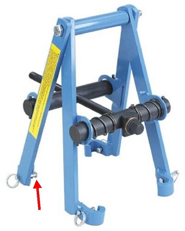

I can walk you through the job. You can most likely borrow a strut compressor from an auto parts store that rents or borrows tools. In my city, they make you buy the tool, then you get a full refund when you take it back. If you choose to keep a tool, you still take it back, then they give or order you a brand new one.
Once you remove the assembly, the spring only needs to be compressed less than an inch to remove the force on the upper mount. That upper mount has a rubber insert in it that can deteriorate, but you can't see that until after it is taken apart. If you need to order new ones, the car has to sit until they arrive, or you have to put it all back together, then start all over days later. I've had to do that more than once with customer cars. Same is true if there is a rubber "isolator" between the bottom of the spring and the metal plate it sits on. Chrysler used those to reduce the transmission of road noise, but here again, you can't really tell if they're worn until everything is taken apart. The new struts can be installed without those parts, but it lowers the front end by about 1/2". My parts department never stocked them because they showed no sales history for them. I pointed out there was no sales history because for years the previous tech was leaving out the worn ones rather than leaving that car torn apart on his hoist for days. Once they began keeping a pair in stock, I was using them on about one in ten strut jobs. Made for lots of customer satisfaction at very low cost. Be aware most car brands don't use those isolators, so this isn't an issue.

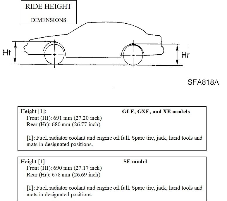

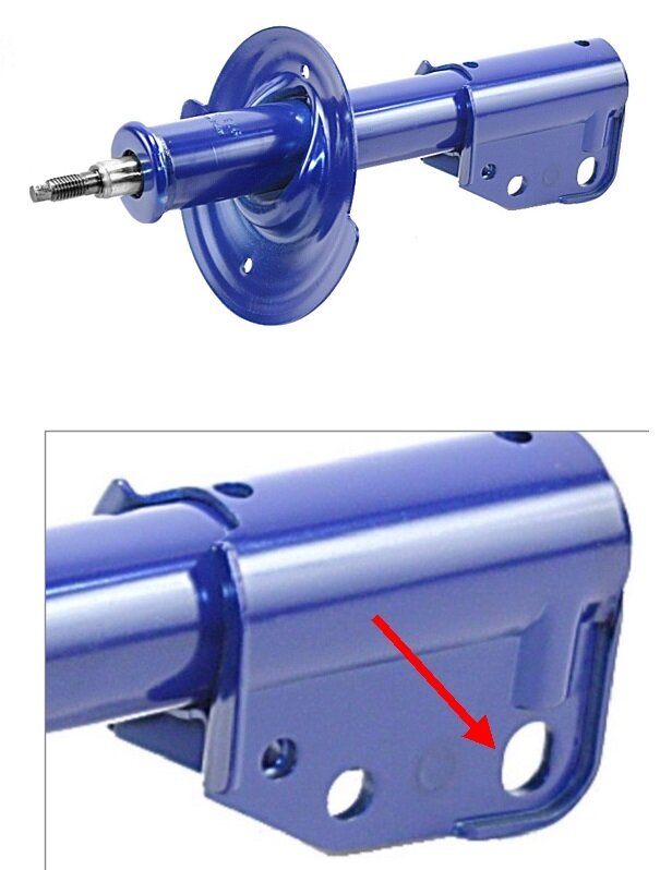

Before you go that route, measure the front ride height. The drawing shows to take them at the top of the wheel openings. This method does not account for non-standard tire sizes, so you have to make allowances for that. If you find one side is lower than the other, or if both sides are significantly lower than specs, the better value is to install a pair of "quick struts". Those are the struts, coil springs, upper mounts, dust boots, and those isolators if they are used, all in one package already assembled and ready to install. This restores ride height to specs, and you don't have to worry about the condition of the upper mounts or the safety concern of a spring popping out of the compressor. When you pay me to do this job, you save much more in labor time than the small higher cost over just the bare struts. I compare installing new bare struts with old, used springs and mounts to buying new shoes, but using old, ragged shoelaces to hold them to your feet.
Even with either new bare struts or quick strut assemblies, you can't be sure one of the mounting holes will come elongated. As I mentioned, those on Chrysler and Chrysler replacement struts are always oval-shaped, and original GM ones are always not. The holes in aftermarket replacement GM struts usually are, but if not, you have to grind them out. That job only needs to be done once to make them adjustable.
I think you're in for unnecessary misery if you try to drill the holes out. I could be wrong, as I never tried it that way, but the easier way is with a die grinder and metal-cutting bit. You can find them in electric models, but all I've ever used are air-powered. You can find them at Harbor Freight Tools, Walmart, or any hardware store. Be sure to wear safety glasses, and I recommend wearing disposable rubber gloves. I never wore the gloves, and always ended up with a few tiny metal slivers in my hands.
On Chryslers and GMs, the lower of the two holes gets elongated. I've had some import models where the adjustment can't be made that way due to the spindle bumping into the bottom of the strut body. I suspect that's why they show grinding the upper hole for your car. The way to see what's taking place is to raise the front end off the ground, support it with jack stands under the frame, not the lower control arms, remove the wheel and tire, then remove the upper bolt, and finally, loosen the lower bolt. If things are rusted tight, you may need to loosen that lower nut a good full turn, then hit it with a hammer to push the head back a little to release the clamping force. Since the suspension is hanging freely, there won't be a lot of pressure on that lower bolt.
Now grab the bottom of the strut and pull it out toward you. Doing so makes the strut tilt in on top more than before, but it makes the spindle tip out on top, which is what we're after. As an educated guess, I'd say you want the top of the brake rotor to move outward roughly 1/4" Don't waste your time trying to measure that. It's just an estimate to get you in the ballpark. Once you pull it out that much, snug the lower bolt. If it wants to pop back in or out on its own, lightly snug the bolt first, leaving it just loose enough that you can pry it out a little, then tighten the bolt more to keep it there.
At this point you're going to find the upper holes are no longer lined up with the hole through the spindle and you can't get the bolt in. This is where you have to grind the holes on both sides of the strut until the bolt will go in. With a new, sharp cutting bit, that can be done in as little as a couple of minutes, or it can take longer, depending on how far you have to cut. You only need to cut the holes as much as is needed to get the adjustment you need. That's impossible to know by eye, so a good recommendation is to grind the holes 3/16" larger. That should be more than enough to get 2.0 degrees more camber.
As an alternative, if you look on the Rock Auto site, under "Suspension" for your model, they show two different styles of special bolts at the top of the list of parts. I'm not familiar with using either one, so hopefully they come with instructions. I still prefer grinding the holes.
Oh. yeah; don't get excited if the cutting tool suddenly starts flying around in the hole. Hold it tightly and vary the speed to help prevent that. It's one of the few miserable parts of the procedure.

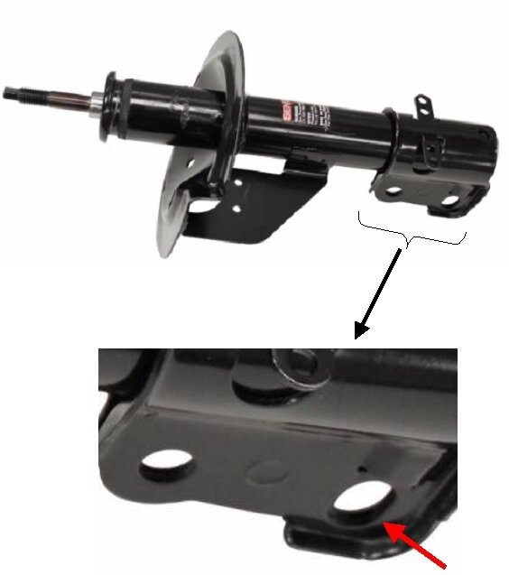

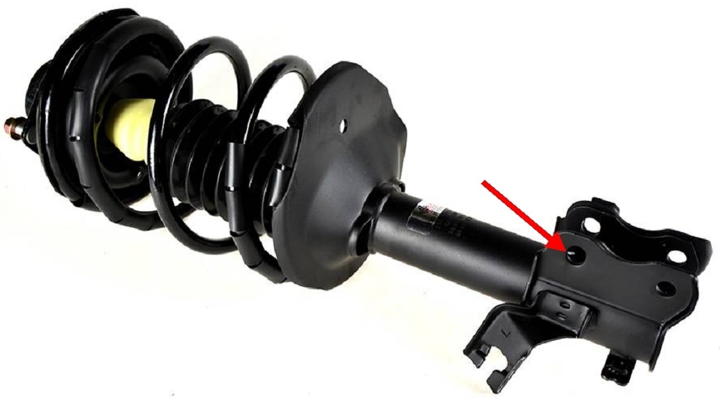

The second photo shows a front strut from a Caravan The third photo shows an aftermarket replacement for a Chevy Cavalier. On both of these, the lower holes is elongated, and if you look right above it, you'll see a raised area that looks like a bump. Also, notice the lip on the bottom corner. Both are easier to see in the Chevy photo. That lip and bump form a pocket for an eccentric bolt to fit in. That's the bolt I mentioned with the offset head. As the bolt is rotated, that head is forced to sit in that pocket, so the shaft of the bolt moves back and forth. That pushes or pulls on the hole in the spindle to force it to move. Better yet, since it can't rotate or move once it is tightened, it really holds it in place well when driving over bumpy roads. Most Chrysler models come with those cam bolts. They have to be added on GM alignments, at extra cost, but only the first time they're needed. A lot of shops don't stock those bolts, so they just rely on the original ones to hold everything in place. That can be acceptable for your car too.

Don't do that before the spring is compressed. Each spring holds up over 1,000 pounds of car, so there's that much pressure on it as it is removed from the car. To remove the nut that way would send the upper mount airborne. It most likely would not take out an airplane, but it will do serious damage to heads. This step is avoided when installing quick struts.
On most struts, as shown on these two, but hard to see, there's a hex on top to hold the shaft from spinning while the nut is backed off with another wrench. That's fine when doing this once, but it takes way too much time for a professional. The way I get them off is to use a 1/2" air impact wrench, but I pulse the trigger repeatedly. To hold it steady will just spin the shaft endlessly and make it dizzy. By pulsing it, the shock backs the nut off a little each time I run them on the same way, but with new struts it's a good idea to do that rather slowly. The shaft spins a little each time, and spinning too much too fast can overheat and melt the rubber o-ring seal at the top of the strut body. Those are lock nuts, so they won't just spin on by hand. You'll need the impact wrench or two hand wrenches.
Once that nut is tight, the last step is to loosen the spring compressor. As you do that, observe the bottom end of the spring must be rotated to meet the raised section of the metal mounting plate. That's called "indexing" it. Any time you're reinstalling used struts, wipe off any dirt on that plate. That, and small pebbles that get caught in there can cause a crunching noise. Also note the top end of the spring indexes with a mating formed area under the upper mounting plate. That upper plate is in two parts with a bearing in between. That's to allow the strut to rotate with the steering system while holding up all that weight. It's not uncommon to find the three bolts on top don't line up with the three holes in the inner fender. Normal procedure is to lift the assembly up and insert the three bolts first, loosely install the nuts to keep it there, then rotate the strut by hand to line up the bottom with the spindle. You may have to grunt with both hands, but some struts turn rather easily.

Wow. That's a lot of information. I'll measure the front distance as shown in the photo I don't believe those struts are bad I measured both sides at each corner of the front end and came up with pretty much the same on both sides. I measured from the pavement to the top of the wheel well. And no particular difference in height. I also took a straight edge actually two-foot level and flat against the tire from top to bottom there's a one-inch difference in the two sides. The passenger side needs to come out at the top of the wheel one inch to match the driver's side... I think I'd prefer to try the special camber bolts if I can find them. And after hearing your story about the Strut exploding, I'll buy the fully assembled struts. To be on the safe side. If I can find the camber bolt's I may try using them with the original strut on the passenger side. Before buying a dye grinder and trying to elongate the strut hole. But I also want to let you know the warranty on my alignment is for as many times as needed for one year. They assured me that there was no problem. The reason the Tech. Didn't go out of his way to fix the issue with the strut was because I bought what's considered the economy. Alignment. The lifetime warranty was double the price and I didn't know then what I know now. I didn't realize how involved the alignment could be. I'm going to remove the wheels again and take a good look at my struts so far, I've seen no oil leaking there's no excessive movement in the struts there's no bounce in the front end. And I think if I'd needed new struts the car would not have handled as well as it did before the axel and control arm replacement. I'm very sorry for taking so much of your time, you've been great and explaining everything in precise detail. If I can avoid modifying the original strut, I may not be capable of that job I'm in my 70s and it's hard for me to getting up and down under this car. Not to mention the stress. I wish I could hop in the car and come to you and let you deal with this headache. Thanks Cardio, you are Great. JC

In case I wasn't clear, the strut doesn't have to be removed to grind out the hole. Only the top bolt has to be removed temporarily, and the bottom one loosened.
If you go with the special bolt, let me know which style you get and how it works. There's a good chance you'll find one at a local auto parts store. I have a suspicion you'll have to remove both bolts to get the top one installed. With just the top one removed, I don't think the spindle will tip out far enough. Maybe it can be installed right through the holes in the strut. As I said, I never used that style.
I didn't mean to scare about replacing struts. When it comes to that time, I have a number of suggestions. The first photo below shows the "clamshell" type of compressor. This is the type used when the two incidents occurred with springs popping out. If you look at my red arrow, this is the first one I've seen with the special locking pins to hold the arms to the spring. I didn't have those. They eliminate the safety concern.
The style you're more likely to borrow from an auto parts store is shown in the second photo. Here again, they have added a safety feature in the four J-bolts to hold the hooks to the spring. One big advantage to this style is they can be installed on the spring while the strut is still bolted to the car. If you use a floor jack to raise up the lower control arm an inch or two, you'll start to compress the spring / collapse the strut. Then you can tighten the nuts by hand. When the jack is lowered, the spring will already be compressed enough to remove all pressure on the upper nut.
With either of these designs, I recommend tightening the nuts by hand with a wrench. To save time, most professionals use an air impact wrench, but too often that seems to result in grinding away the threads on the tool's long bolt.

The front strut in this first photo is for my old '88 Grand Caravan, but the same part was used for over ten years on all their minivans and most of the front-wheel-drive cars. It's the best photo I could find. The bottom is enlarged in the upper right photo to show the elongated lower hole. Right now both holes in your struts look like the upper hole in these photos. To make yours adjustable, all that is necessary, at a minimum, is to grind the hole oval-shaped like this lower one, but on your car it would be the upper one. You actually might get the same results by grinding the lower hole too, but you'd have to experiment with that. There may be some reason they want that done on top.
You can see the lip to the right of the lower hole. Also notice the raised area to the left of the lower hole. Those form the pocket for the cam bolt to sit in.

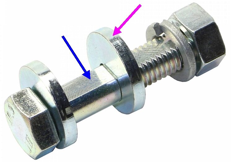

I hope I can make this understandable. The second photo shows a replacement cam bolt for this strut. The pink arrow is pointing to one of the two offset eccentric washers. On the original bolts, the one next to the head is machined as part of the bolt. It can't be removed, but it works the same way. The blue arrow is pointing to a flat area on the bolt. The holes in the washers have matching holes to key them to the bolt. That forces them to rotate along with the bolt as you turn it with a wrench or ratchet and socket.
Now for the fun part. In the bottom right, I expanded it even more, and added the red and white circles to show to location of the washer. As the bolt is turned, the washer has room to allow it to move up and down in that pocket. But as they rotate, the lip and raised area force the center hole to move left and right. The white circles show the washer is centered left to right in the pocket, and the shaft of the bolt is to the left as far as possible. Remember, the hole in the spindle is still round, so where the shaft of the bolt goes, so does the spindle.
The red circles show the bolt has been rotated a quarter turn. Left to right the washer is still centered in the pocket, but being off-center, it has moved down. More importantly, the hole has moved outward, (to the right in this photo). The bolt's shaft has moved there and taken the spindle with it. The washers have forced the bolt's shaft to move along with the hole in the spindle. When you don't have this cam bolt, as in when we grind the holes elongated on GM vehicles, the movement of the spindle in relation to the strut is accomplished by you pulling or pushing on the strut. Once you get it to where you want it, you tighten both bolts. More confusion on that in a moment.
There's two big advantages of this cam bolt design. The first is once you get camber to where you want it. the washers being trapped in the pockets holds the adjustment there while you gather up the tools to tighten the bolts. When you're reusing original regular bolts on GM vehicles, or on yours, there's nothing to hold it in adjustment while you tighten them, and I guarantee they're going to move from the weight of the car. I promise, more on that in a moment.
Where this is less important for you is no matter how far you get camber increased, it can only become better than what you have now, and you can get that with the wheel off and you tugging on the strut while you tighten the bolts.

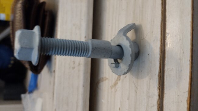

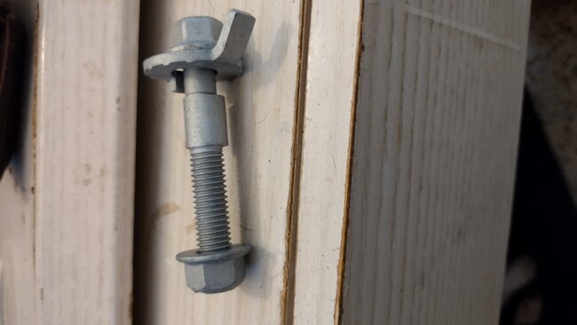

Cardio I'm sending you an update I went to the parts store and bought a set of bolts instead of waiting a week. Sending you the pic of what they look like.
Jun 2, 2023 at 11:04 AM
JC-842
  • 181 POSTS
Jun 2, 2023 at 11:05 AM
JC-842
  • 181 POSTS

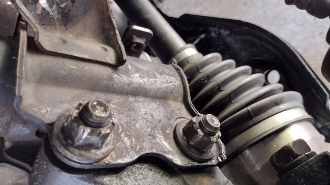

Hey, I think these Cam bolts are to small but parts say this is the right ones but I'm not too sure about that... JC
Jun 2, 2023 at 11:15 AM
JC-842
  • 181 POSTS

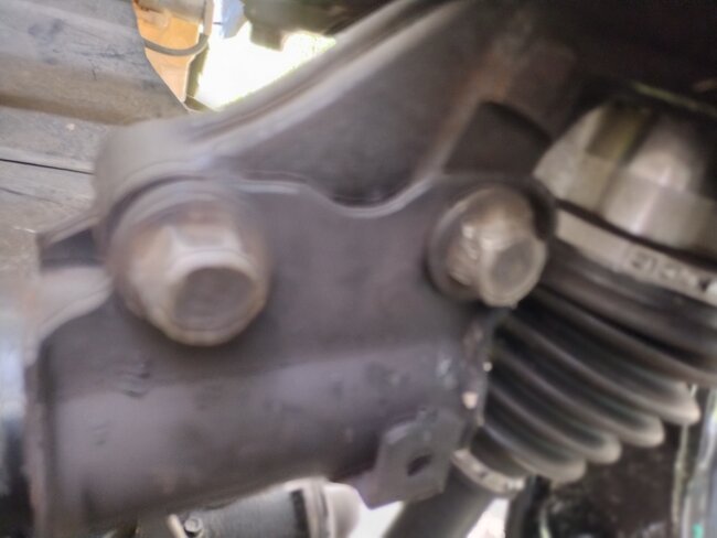

Old bolt's.
Jun 2, 2023 at 11:31 AM
JC-842
  • 181 POSTS
Cardio I'm having the worst luck..you just about have to go with part in hand. They say it's 14MM

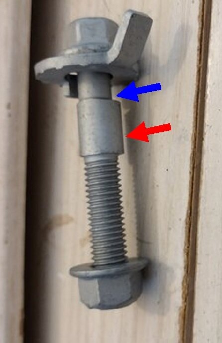

Okay, the threaded part of the bolt needs to be considerably smaller in diameter than the original bolt, otherwise it won't be able to move the spindle. It looks like the widest part of the cam, (red arrow) should be the same size as the original bolt.
One side of the strut is going to ride at the blue arrow. The other side will ride somewhere on the threaded area of the bolt. Thinking of that pocket formed on each side of the Chrysler strut, and the eccentric washers that sit in them, your original round holes in the strut become those pockets. If you want to get technical, where the eccentric washers on the Chrysler bolt pushes the strut in or out, on yours, the eccentric is inside the spindle and pushes it in and out. The result is the same, it tips the wheel in or out on top. They're saying if one bolt doesn't give you enough range, you can use a second one in the other hole.
To elaborate on my description of those eccentric washers, as you rotate the bolt, those washers can move up or down within the pockets, but as you continue to rotate the bolt, they push in or out on the strut to cause the change. Similarly, as you rotate your bolt, at two quarter turns, the inner eccentric will also drop down or move up and cause no change, but the next quarter turns, it will push the spindle in or out. Pop one of those bolts in and you'll see what happens as you rotate it.
If nothing moves as you rotate the bolt, you may need the larger of the two sizes listed. Don't forget that to allow this change to occur, the top bolt has to be loosened a little to eliminate its clamping force.

Okay, so the bolt goes into the bottom hole and not top hole? And I'm still not getting what that piece. over the bolt is.. it looks like something I've seen on tractor attachments that you turn to take up the slack in the attachment. In the photo it's in between the hump of the bolt. And the head Is that where it stays? I noticed it has little barb's on one side. Is that some sort of stop to lock the bolt when it's tightened down? You would think alignment shops would have these bolts at their disposal. Thanks for making me aware of bolt situation. I was going to return them tomorrow. So I guess I'll tackle this again in the morning. Enjoy your weekend and hopefully I can update you on Monday. And by the way I bought the little magnetic level/ degree reading tool. Looked like it could be useful in telling you how much adjustment to apply...Take care. JC
Jun 2, 2023 at 3:55 PM
CARADIODOC
  • 34,321 POSTS
Those Magnetic angle finders are a quick trick we don't really share because they are not precise enough for anything, but in this case all we're interested in is gaining 2.0 degrees. That can tell you you've moved camber the right way, and when you've moved it close to the correct amount. The secret is to attach it to the brake rotor, which is parallel to the wheel, and to install at least two lug nuts to hold the rotor solidly in position.
I've used that tool too when replacing struts when it's going to be necessary to drive the vehicle to the alignment shop. As long as nothing else changes between removing one strut and installing the new one, I set the angle finder to 0 degrees, switch the struts, adjust camber until it shows 0 degrees again, then tighten the bolts and move on to the second strut. You'll still end up with an off-center steering wheel, but camber on each wheel will be close enough to make the car drivable.
I don't have an answer about the tab on the washer. I looked at that multiple times, but never figured it out. Without playing with one of those myself, I don't know what it is supposed to do. I did forget to mention earlier that this type of adjuster is simply an aid in setting camber very precisely where you want it, but it's the tightening of the nut and its clamping force that is what is relied on to prevent it from shifting or slipping later while driving. Let me know if the torque spec for that nut is listed on the packaging or in any directions it came with. Normally I'd suggest "common sense" for the torque spec, but I do that from experience, with a long-handled ratchet. With those huge cam bolts on Chryslers, I'm too puny to over-tighten them or strip the threads. That may be possible with bolts of a smaller diameter. The good news is the final tightening is going to be done by the alignment specialist, so it's up to him to know how tight is tight. I'm pretty sure this won't be the first time he's seen this.

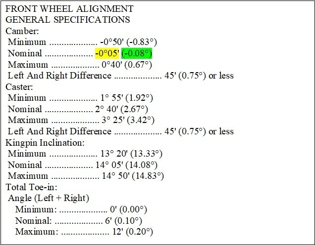

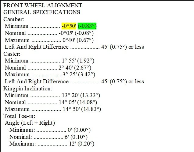

Right now your right wheel is at minus 2.0 degrees. The front alignment specs are shown below. The number I highlighted in yellow shows front camber in degrees and minutes. I could set my computer up to read that way, but I have no frame of reference for that type of measurement. The number highlighted in green is the same value in degrees and hundredths of a degree. That I understand, and it shows "perfect" is minus 0.08 degrees. Back in the '80s, with old mechanical equipment, we were lucky if we could read to the eighth of a degree, but that was close enough for big heavy rear-wheel-drive vehicles. As I mentioned earlier, we need to read to the hundredth of a degree today, and only the computers are accurate enough to let us do that. They can also be set to read to just the tenth of a degree. That gets less accuracy but takes less time.
While it's surprisingly not as common as you'd think, 0.00 degrees, perfectly straight up and down, is not a real common spec for front camber. Most of the time we want just a fuzz of positive camber, but here, given the wide range of tolerance, I would aim for 0.00 degrees on the left front wheel, and that minus 0.08 degrees they call for on the right wheel. That would give me a 0.08 degree pull to the left to offset road crown. I found if I could sneak up to exactly 0.06 degrees pull to the left on all Chrysler front-wheel-drive models, I would not have a customer come back with a complaint of pulling either way. Most GM front-wheel-drive models were more tolerant, and wouldn't pull either way with a larger difference, within reason. With Fords, most of their models couldn't be bothered to even provide camber adjustments, so you just took what you got and let the owners put up with the pulling.
The tolerance for camber for your model allows for it to be as low as minus 0.83 degrees. That means as low as that, the value will still be in green on my computer, meaning it's "in specs". To the average car owner, they would think that's good, but I couldn't let a car go like that in good conscience. My computer has a button that can be pressed only once during an alignment to "Reduce tolerances". When I do that, the acceptable range that shows up in green tightens up to somewhere around -0.08 plus or minus 0.25 degrees. That just means I have to set it much closer to perfect before that number will turn green. That means more work for me, more time spent on that alignment, fewer jobs completed that day, but a happy customer. I left that dealership with a reputation of being one of the slowest mechanics in the shop, but the one with by far the fewest "comebacks". I never once in ten years got hollered at for working too slowly. By the way, comebacks'get worked on a second or third time at no additional charge to the car owner, and no pay for the mechanic, so shoddy workmanship has its own checks and balances.
As far as, "will one bolt be enough", it depends on how far it will increase camber. If it means it can raise camber 1 3/4 degree from where it is now, I guess I'd be happy with that. On the other hand, that more likely means it provides a 1 3/4 degree range, meaning it might only raise camber up one degree, and lower it 3/4 degree, from where it is now. Part of that 1 3/4 degree range might lower camber from where it is now. Chrysler's cam bolts provided well over a 3.00 degree range from lowest to highest, but there was also some play in there. If turning the cam bolt didn't bring camber up high enough, I could also pull out on the top of the tire to get some more, then hold the tire there with one hand, and my foot pushing in on the bottom, while I reached behind it to feel for the bolt head and socket with my second hand, and turn the ratchet with my other hand. Fortunately I didn't have to use all three hands very often. (There's other ways around that which don't require using three hands), but that doesn't humorize the story.
What I would suggest is to use the magnetic angle finder on the brake rotor and adjust it to read "0" so it's easy to remember your starting point. From here on, don't raise or lower the car or shift anything that will change that reading. Now remove the top bolt and install the new cam bolt in its place. There should be some play, but if you rotate it, it should only turn a little before it gets tight. Now loosen the lower bolt to remove the clamping force. Rotate the cam bolt some more and see if the brake rotor tips out on top. If you rotate the cam bolt far enough, it's going to start to bring camber back down. Keep rotating it until camber comes up as much as possible. If you can see anything close to a 2.00 degree increase, I'd call it good and head back to the alignment shop. If you can only get an additional degree or less, use the second cam bolt in the lower hole.
While unlikely, if you can't get close to enough camber increase with two cam bolts, I'd pursue grinding one or both holes in the strut, and forget about the cam bolts. Remember, those are just an aid to make it easier to make the adjustments during the alignment. After that, they just need to provide the clamping force, and the original bolts can still do that.
