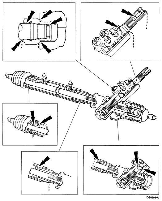

External Leak Check-Typical Power Rack-and-Pinion Steering Gear
Pic 1
External Leak Check - Typical Power Rack-and-Pinion Steering Gear
6. External Leak Check
- With the ignition switch at CIII, wipe off the power steering pump, power steering hose assembly, power steering return hoses, power steering fluid cooler, and steering gear.
- With the engine running, turn the steering wheel from stop to stop several limes. Do not hold steering wheel at stops. Check for leaks. Repair as necessary if leaks are observed.

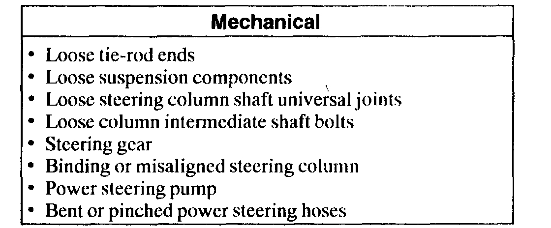

7. Turning Effort Check
pic 2
8. Visually inspect for obvious signs of mechanical damage
9. If an obvious cause for an observed or reported malfunction is found, correct the cause (if possible) before proceeding to the next step.
10. If the fault is not visually evident, determine the symptom and proceed to the following symptom chart. See: Steering > Symptom Related Diagnostic Procedures > With Conventional Suspension
