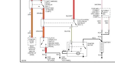

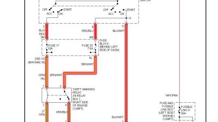

Hi I have 1998 maxima that at times will not start, it does not even crank. I changed the starter and the problem seemed to go away for 7 months. Battery good. When I turn key you can hear a clicking coming from a valve or switch that is located on top of the engine. Thanks
Monday, June 24th, 2019 AT 10:14 AM (Merged)
  • 75,992 POSTS
If you can replace the starter then you can trace the problem see EWD below-start with the fuses then the clutch switch and the relays-Good Luck
