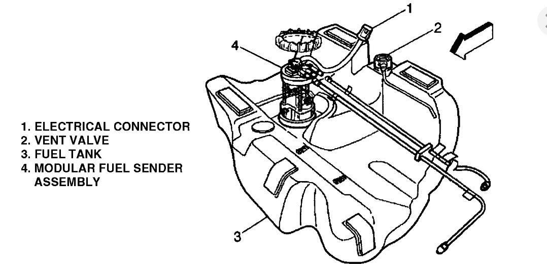

Car starts very hard when it sets overnight. Have to crank a lot to start, once it does start it runs okay and will restart okay until it sets for more than six or more hours. Has new plugs. Car sat for two years without starting and running.

I would suspect the fuel pump is losing its prime overnight.
I would start by checking the fuel pressure before starting the engine in the morning. If it is low or 0, replace the fuel pump.

As I am not a mechanic, I am inclined to believe that your answer to my problem may be correct. But, could it be a fuel relay that has quit working? A fuse maybe gone bad?

I doubt the relay or a fuse is the issue as it does start and once it does, it stays running all day long.
Check the fuel pressure.
Removal Procedure
Notice: Numbers in text correspond to numbered components in image.
1. Relieve the fuel system pressure. Refer to Fuel Pressure Release.
2. Drain fuel tank. Refer to Fuel Tank / Service and Repair.
3. Remove fuel tank (3). Refer to Fuel Tank / Service and Repair.
4. Remove the locking nut using J 39348 by turning counterclockwise.
Important: The modular fuel sender assembly may spring up from its position. When removing the modular assembly from the fuel tank, be aware that the reservoir bucket is full of fuel. Tip the modular assembly slightly during removal to avoid damage to the float. Have a shop towel ready to absorb any leakage.
5. Remove modular fuel sender assembly from the fuel tank (4).
6. Remove fuel sender seal (lip). Slide the fuel sender lip seal downward, past the reservoir and carefully over the float arm assembly.
7. Discard the fuel sender lip seal.
