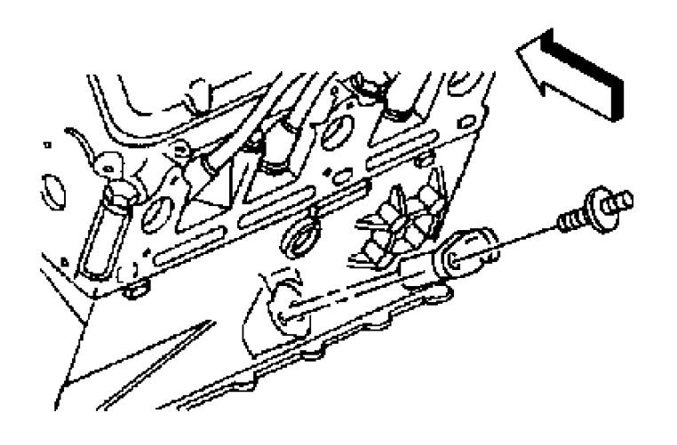

when it does not start, does the tachometer work on the dash showing engine RPM? There is a second crank sensor in the back of the motor that controls the fuel injectors.
https://www.2carpros.com/articles/engine-cranks-excessively-before-starting
You would need a full scan tool to monitor the signal from it to the ECM.

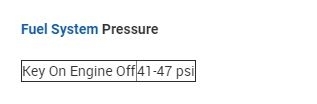

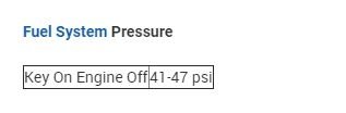

I am concerned about the fuel pressure. It should be around 45 pounds as a target. I attached the spec below for you.

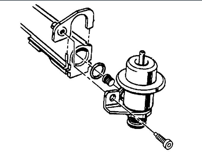

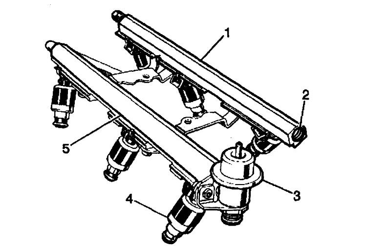

The other possibility is the pressure regulator. It is on the end of the fuel rail by the throttle body. Remove the hose and see if there is any fuel in the hose. This is a common failure for hard start hot as you have.
Removal Procedure
1. Relieve fuel system pressure. Refer to Fuel Pressure Release.
2. Remove the upper intake manifold. Refer to Engine / Intake Manifold.
3. Remove the fuel pressure regulator vacuum line.
4. Remove the fuel pressure regulator retaining screw.
5. Using a shop towel to catch any spilled fuel, lift and twist the fuel pressure regulator in order to remove the fuel pressure regulator from the fuel rail.
6. Remove the retainer and spacer bracket from rail and discard.
7. Remove the fuel pressure regulator from engine fuel return pipe.
8. Remove the fuel pressure regulator inlet O-Ring and discard.
Crank sensor
REMOVE OR DISCONNECT
1. Negative battery cable.
2. Crank steering wheel fully to the left.
3. Raise vehicle on hoist.
4. Sensor electrical connection
5. Bolt/screw.
6. Sensor from engine.
7. Inspect for the following:
7.1.Inspect the sensor for wear, cracks, or leakage. Replace the O-ring if necessary.
7.2.Lubricate the new O-ring with clean engine oil before installing.
INSTALL OR CONNECT
1. Install the sensor to the block.
2. Install the bolt to hold sensor to block face and tighten to 8 Nm (71 lb in).
3. Connect the electrical connector.
4. Lower the vehicle.
5. Connect the negative battery cable.

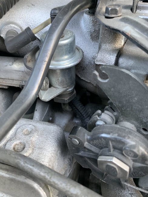

When you say fuel in the hose, are you talking about that vacuum line or the steel line coming out of the bottom? I've attached a picture.
May 2, 2020 at 4:28 PM
Okay, I was referring to the rubber line.

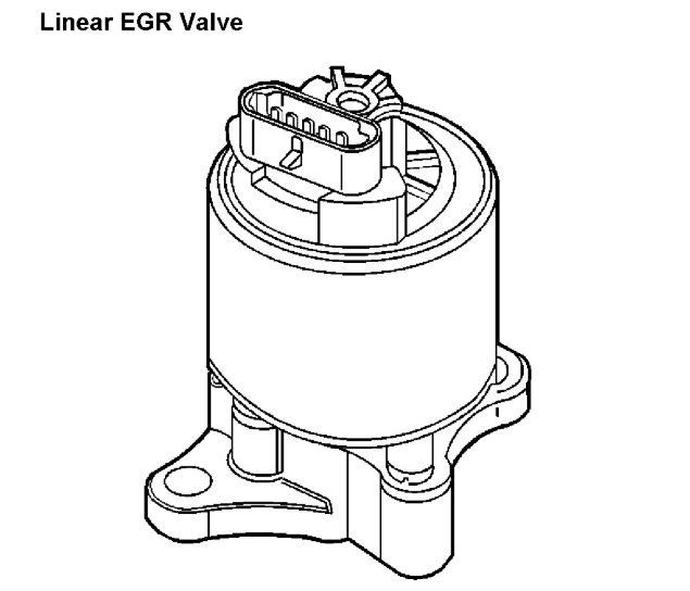

What about the EGR valve? I would remove the EGR and check to be sure the pindle is not being held open by a piece of carbon
I attached a picture for you to view. It has one electrical connector and 2 10mm bolts that hold it to the intake.

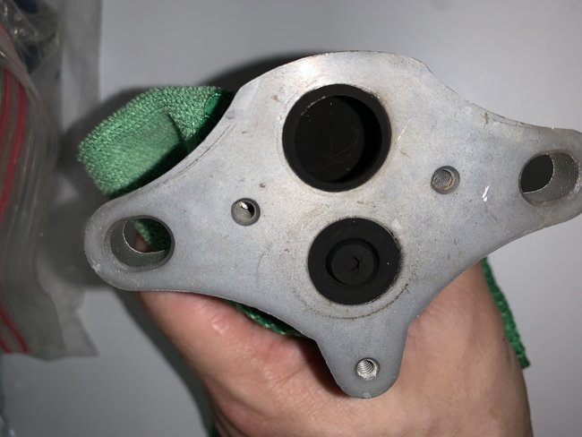

Okay, took off the EGR valve but I am not sure what you mean by check the pindle/pintle? If it is what I think it is, star head on the left in the picture, it appears to be closed. I can push it in and a spring pushes it back out. Lots of carbon coating on the walls but nothing holding it open.
May 21, 2020 at 4:33 PM
That is correct. Carbon chunks were common to not allow the valve to close and it causes a massive vacuum leak.

Okay, 41 is the bare minimum. If you are that low, either the pump or the regulator is the issue.

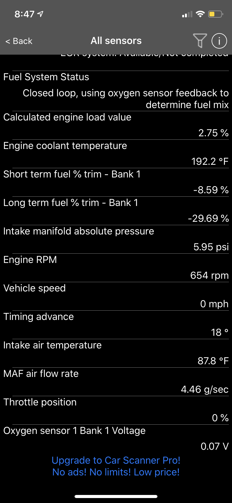

Okay, still need to check fuel pressure but here is the idle trim value:
May 26, 2020 at 4:56 AM
-29 tells me there is not enough fuel in the engine.
Did you recheck the fuel pressure? What was the pressure?
The other possibility is injectors. If they are clogged or restricted, this will be the result.
https://www.2carpros.com/articles/how-fuel-injection-systems-work
There no additive that will clean them. You need to have the fuel system disabled and the injector cleaner added directly into the rail and engine running on nothing but the cleaner.

You were right about the injectors. Turned the key to "on" with the plenum off to see what the injectors would do. 3 started internally leaking. Replaced them and it starts brand new. The spark plugs would be wet which of course was causing the hard start.
