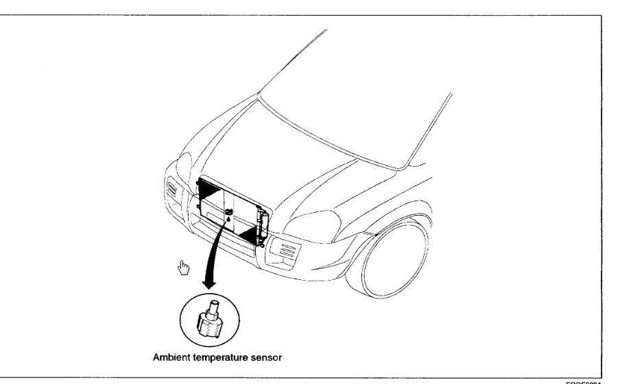

Hard start and fuel fills the air
2006 HYUNDAI TUCSON
156,000 MILES • 2.0L • 4 CYL • 2WD • MANUAL
JILOWA ISAAC
Starts okay when outside temperature is about 18 degrees Celsius, hard start when outside temperature is above 25 degrees Celsius.
Oct 9, 2019 at 1:45 AM
More than likely you have a temperature sensor issue and I would suspect it is the ambient temperature sensor.
I attached the location but more than likely this is not reading properly which means it is going to through off the air fuel mixture creating a hard starting issue when the temp is warmer.
If this is the issue then we need to start going through these items laid out in this guide and go from there.
