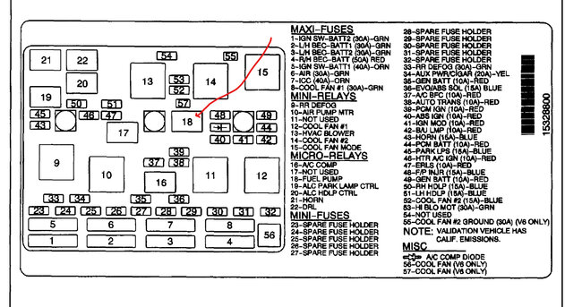

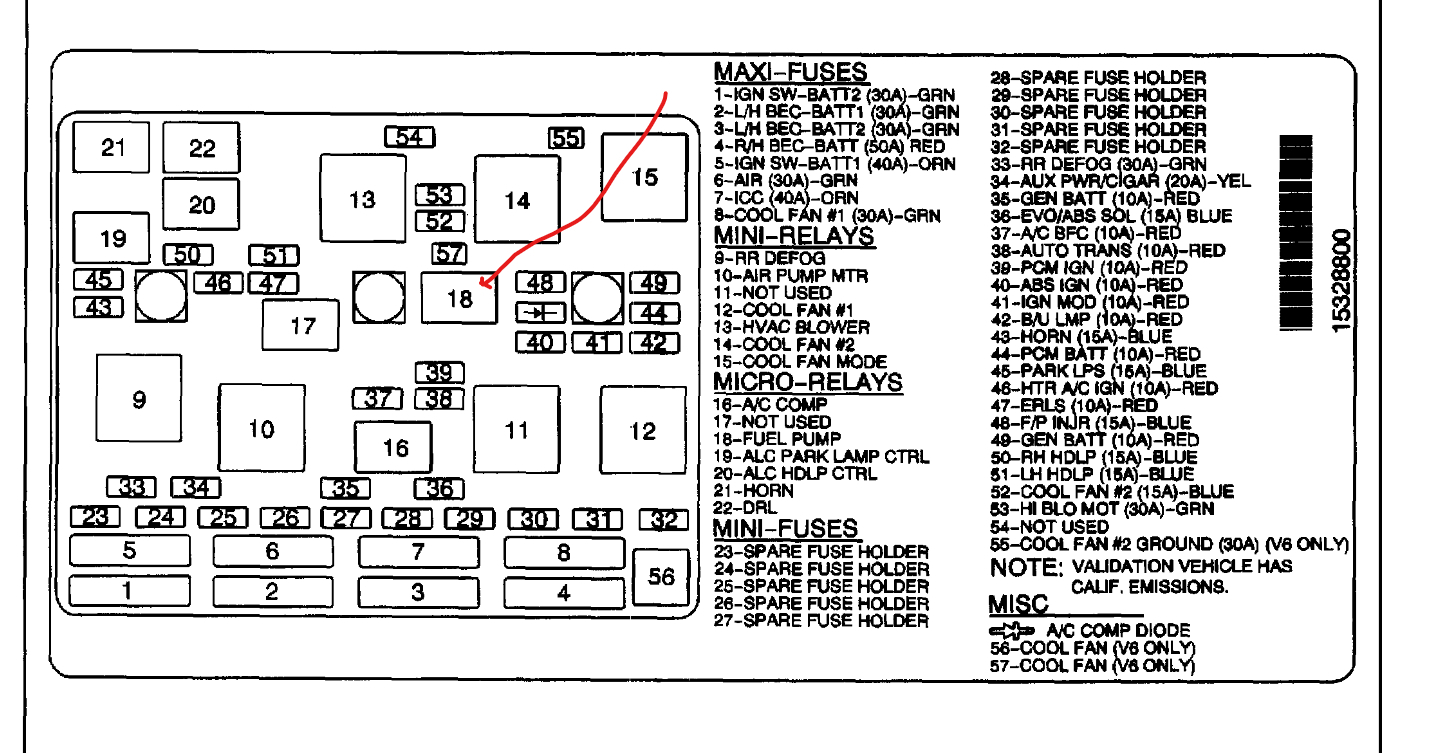

My car has been sitting for about 6 weeks. I tried to start it. It cranks but doesn't start. Any suggestions?
Dec 26, 2022 at 3:39 AM
  • 55,721 POSTS

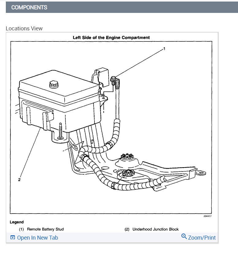

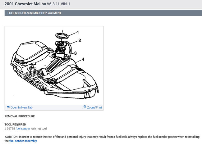

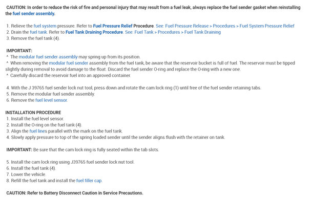

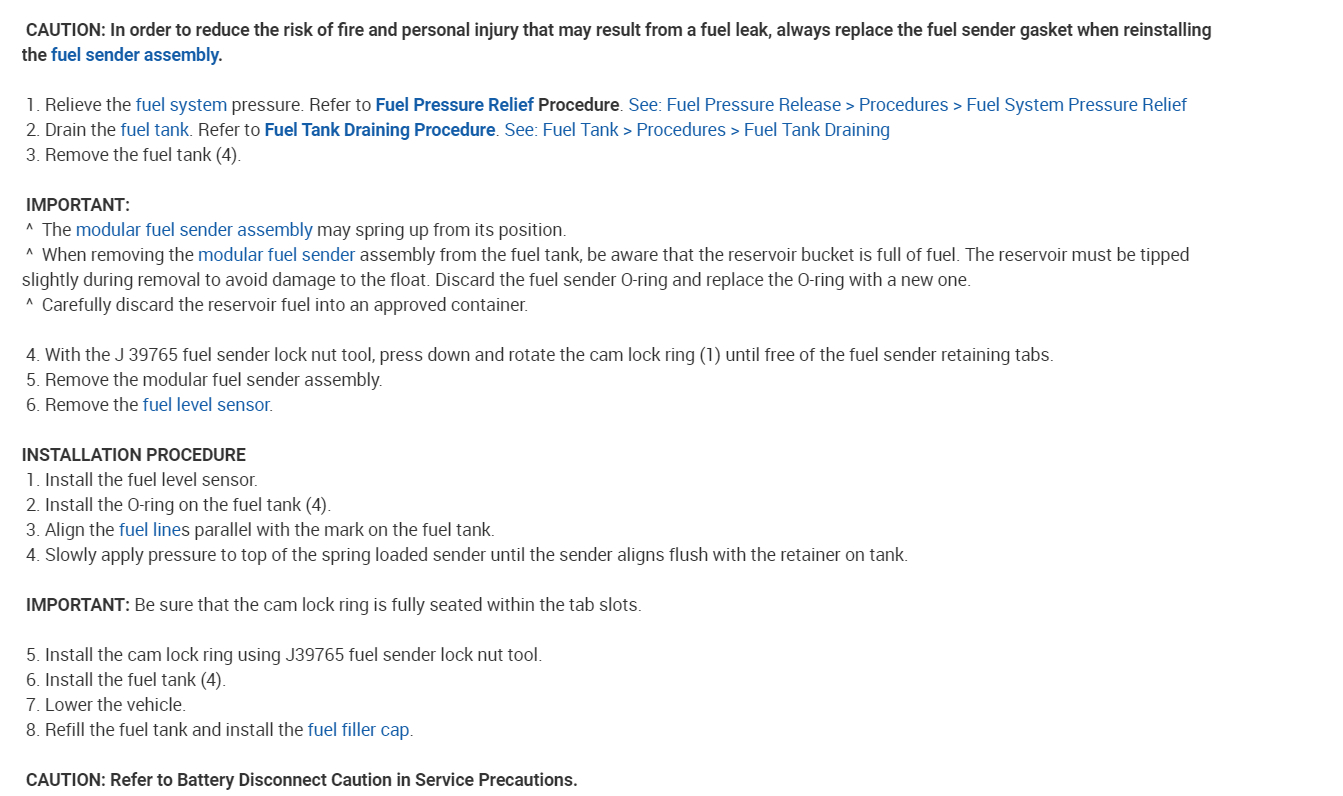

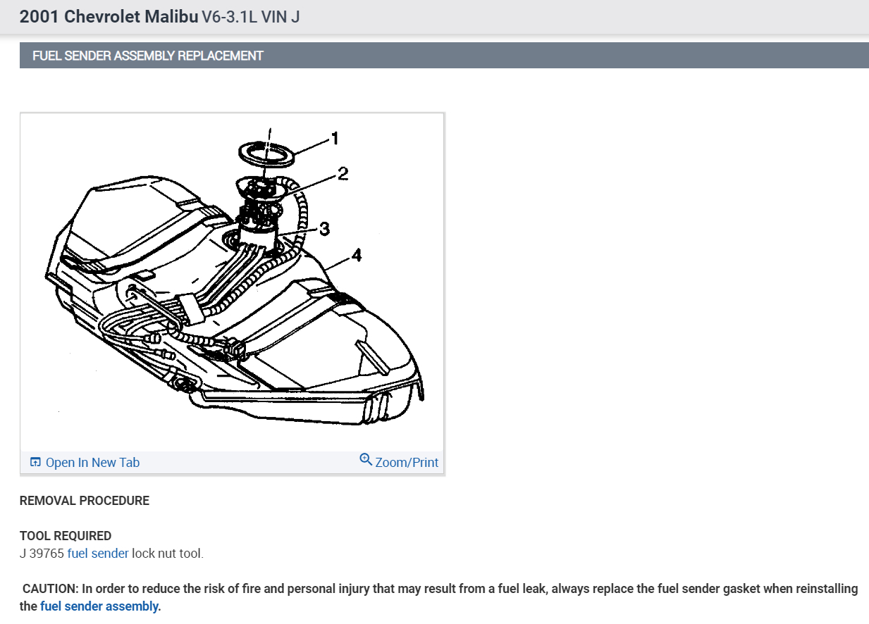

If you turn the key to the on position without cranking the engine over, can you hear the fuel pump on in the tank for about 5 seconds? If not, we can use starting fluid to confirm it is a fuel problem. If the engine run, I would replace the fuel pump and the fuel pump relay. Here is the location of the relay and how to change out the fuel pump. Here is a generic guide that can walk you through the steps with instructions below for your car.
https://www.2carpros.com/articles/how-to-replace-an-electric-fuel-pump
and
This guide can help as well:
https://www.2carpros.com/articles/car-not-running-advanced
Check out the images (below). Let us know what happens and please upload pictures or videos of the problem.
