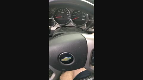

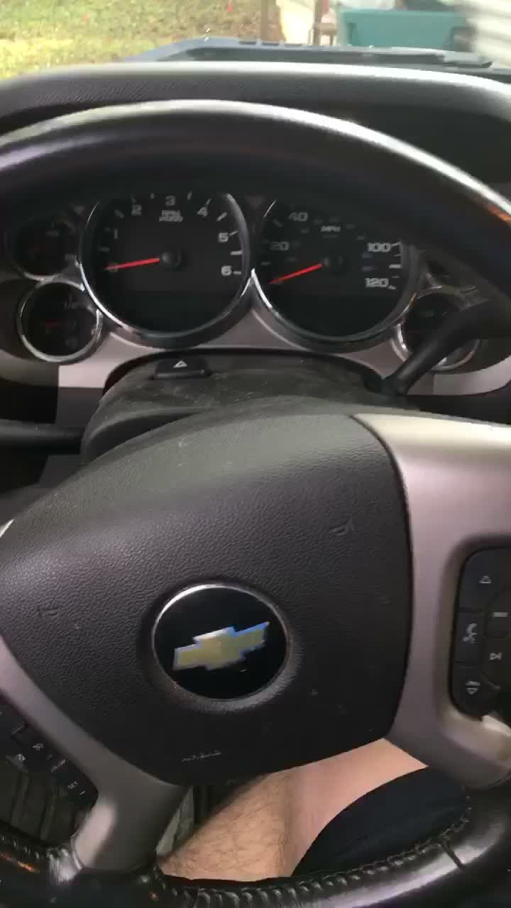

After my truck sits for about six or more hours it acts like it will not start, just keeps cranking. I put the pedal to the floor and it fires right up. It will idle up and down for a little bit until it warms up a bit. After that it fires right up. It will even start right up after sitting for two to three hours. I took it to the mechanic and he told me I needed my fuel injectors cleaned out. That did not work, just costed me money. I am getting a p0172, p0175, p0455, p0446, and a p0420. Any advice would help! Thanks in advance. I will post a video of what it does in the morning.

Good morning.
Good video.
The first thing I would do is check the fuel pressure when it is cold and the issue is present. The fuel pump may be draining down overnight and there is no pressure present and the system has to prime.
I see the crank sensor is working as the tachometer is showing RPM when it does not start.
The 172,175 codes are for rich running. the 455,456 are evap codes which could be related to the first two codes.
The 420 is a catalytic converter code. You need a catalytic converter.
