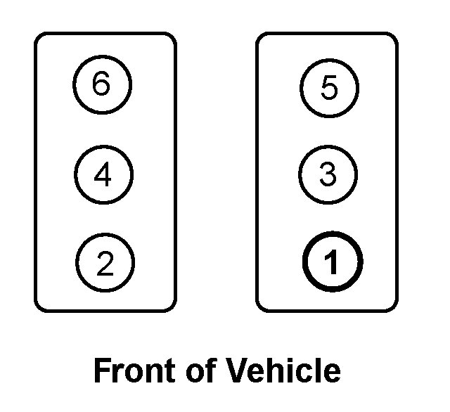

I have had this truck for about a year and a half with very little trouble. I never changed the spark plug until today. I made sure all plugs was gaped properly and spark plug wires is snapped on like they should be. Now the truck runs really bad. It runs good at idle but while driving it runs badly with no pick up or anything like that. I can hear a slight knocking sound while driving about 40 mph. What can be doing this? It was running fine before I changed the spark plugs. I changed them and now its running worse than ever before.

The plug wires and distributor cap was changed about a month or two ago. So they should be in good condition.

A few things may have happened. First, make sure the firing order is correct. You may have switched a couple plug wires. Here is the firing order and the attached picture shows cylinder location.
Firing Order .................... 1-6-5-4-3-2
If that is correct, I would next suggest that you scan the computer to see if one or more of the cylinders are misfiring. This is an obd 1 system and is very easy to get codes from. Follow this link. Also, all you need is a short jumper wire or even a paper clip to get the codes.

If that shows a specific cylinder misfire, remove the plug and confirm that the spark plug gap is properly set and the plug is good and not damaged.
https://www.2carpros.com/articles/how-to-change-spark-plugs
One last thing. If everything checks good, wait until dark, open the hood, and start the engine. Watch for sparks arcing from the plugs, plug wires, or distributor cap.
Let me know what you find.

I found the culprit. A bad plug wire. I will change them all tomorrow.
