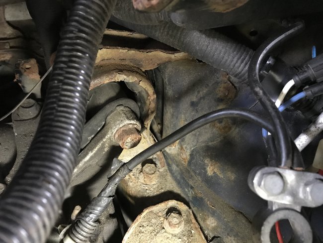

Discovered a strange problem with my auto. When I first start the car up and begin to drive, the car will almost drag on in the first gear, until finally slamming into second with a violent buck. However, for some reason, when the engine has warmed, this violent buck disappears and the car transitions smoothly. The fluid has been changed recently with clean recommended fluid, however, I read that there is also a solenoid that can become clogged near the top of the transmission. The transmission mount bushing is also a bit rough looking. Would this cause the issue despite engine temperature playing a factor?

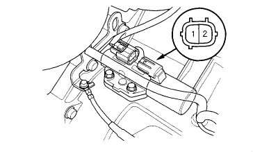

Remove the air cleaner housing.
Disconnect the A/T clutch pressure control solenoid valve A connector.
Measure A/T clutch pressure control solenoid valve A resistance at the solenoid valve A connector. STANDARD: About 5 ohms
If the resistance is out of standard, replace the A/T clutch pressure control solenoid valve A.
Connect the battery positive terminal to the No. 1 terminal of the A/T clutch pressure control solenoid valve A connector, and connect the battery negative terminal to the No. 2 terminal. A clicking sound should be heard.
If no sound is heard, remove the A/T clutch pressure control solenoid valve A.
Check the fluid passage of the A/T clutch pressure control solenoid valve for dust or dirt.
Connect the No. 1 terminal of the A/T clutch pressure control solenoid valve A connector to the battery positive terminal, and connect the No. 2 terminal to the battery negative terminal. Make sure the A/T clutch pressure control solenoid valve moves.
Disconnect one of the battery terminals and check for valve movement.
NOTE: You can see valve movement through the fluid passage in the mounting surface of the A/T clutch pressure control solenoid valve A body.
If the valve binds or moves sluggishly, or if the solenoid valve does not operate, replace the A/T clutch pressure control solenoid valve A.

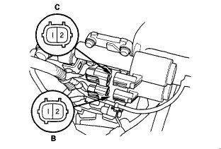

Vehicle » Powertrain Management » Transmission Control Systems » Pressure Regulating Solenoid » Testing and Inspection » A/T Clutch Pressure Control Solenoid Valves B and C Test
A/T CLUTCH PRESSURE CONTROL SOLENOID VALVES B AND C TEST
Test
Disconnect the A/T clutch pressure control solenoid valves B and C connectors.
Measure A/T clutch pressure control solenoid valve B resistance at the solenoid valve B connector, and measure A/T clutch pressure control solenoid valve C resistance at the solenoid valve C connector. STANDARD: About 5 ohms
If the resistance of either A/T clutch pressure control solenoid valve is out of standard, replace the A/T clutch pressure control solenoid valves B and C.
Connect the battery positive terminal to the No. 1 terminal of the A/T clutch pressure control solenoid valves B and C connectors, and connect the battery negative terminal to the No. 2 terminal. A clicking sound should be heard.
If no sound is heard, remove the A/T clutch pressure control solenoid valves B and C.
Connect the No. 1 terminal of the A/T clutch pressure control solenoid valves B and C connectors to the battery positive terminal, and connect the No. 2 terminal to the battery negative terminal. Make sure the A/T clutch pressure control solenoid valves B and C move.
Disconnect one of the battery terminals, and check valve movement.
NOTE: You can see valve movement through the fluid passage in the mounting surface of the A/T clutch pressure control solenoid valves B and C body.
If either valve binds or moves sluggishly, or if the solenoid valve does not operate, replace the A/T clutch pressure control solenoid valves B and C.

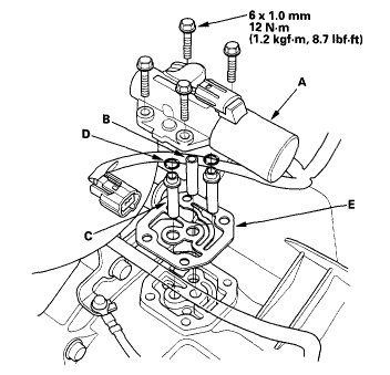

If you determine one is bad, here are the directions for replacement.
2004 Acura RSX L4-2.0L

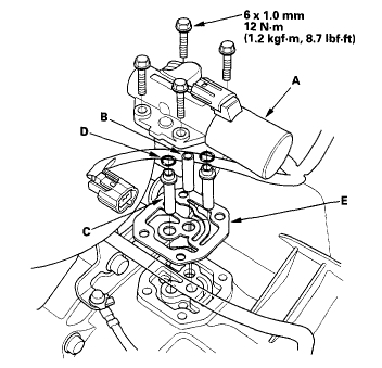

Vehicle » Powertrain Management » Transmission Control Systems » Pressure Regulating Solenoid » Service and Repair » A/T Clutch Pressure Control Solenoid Valve A Replacement
A/T CLUTCH PRESSURE CONTROL SOLENOID VALVE A REPLACEMENT
Replacement
Remove the mounting bolts and the A/T clutch pressure control solenoid valve A.
Remove the ATF pipe (B), ATF joint pipes (C), O-rings (D), and gasket (E).
Clean the mounting surface and fluid passage of the A/T clutch pressure control solenoid valve A and transmission housing.
Install the new gasket on the transmission housing, and install the ATF pipe and ATF joint pipes.
Install the new O-rings over the ATF joint pipes.
Install the new A/T clutch pressure control solenoid valve A.
Check the A/T clutch pressure control solenoid valve A connector for rust, dirt, or oil, then connect it securely.
Install the air cleaner housing.

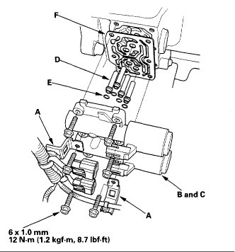

CONVERSION CALCULATOR

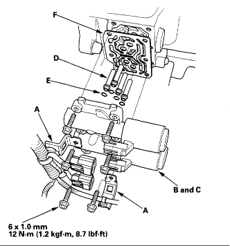

Vehicle » Powertrain Management » Transmission Control Systems » Pressure Regulating Solenoid » Service and Repair » A/T Clutch Pressure Control Solenoid Valves B & C Replacement
A/T CLUTCH PRESSURE CONTROL SOLENOID VALVES B & C REPLACEMENT
Replacement
Remove the mounting bolts, harness clamp brackets (A), and the A/T clutch pressure control solenoid valves B and C.
Remove the ATF joint pipes (D), O-rings (E), and gasket (F).
Clean the mounting surface and fluid passages of the A/T clutch pressure control solenoid valves B and C and transmission housing.
Install the new gasket on the transmission housing, and install the ATF joint pipes.
Install the new A/T clutch pressure control solenoid valves B and C, and harness clamp brackets.
Check the A/T clutch pressure control solenoid valves B and C connectors for rust, dirt, or oil, then connect them securely.

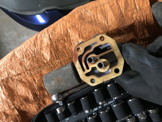

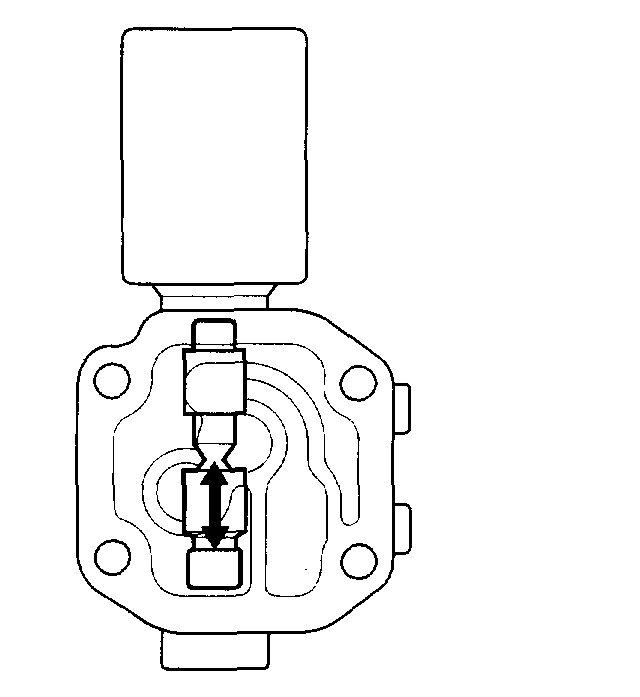

I have received my car back from the garage (finally), happily passing with flying colors. I have had the chance to check solenoid A, which has made a very loud audible clicking when connected with my improvised alligator clips. I still removed it to take a look inside and it is spotless. Also checked the ATF and it is right up on the top level of the etched portion of the dipstick. Very clean as well. Here is a photo of both the mount and solenoid A’s internals. I will be sure to update you when I do B and C, but I will likely remove it to do the test as the alligator clamps are a little too close together for my liking (risking a short circuit). I will follow up with more photos as I explore.

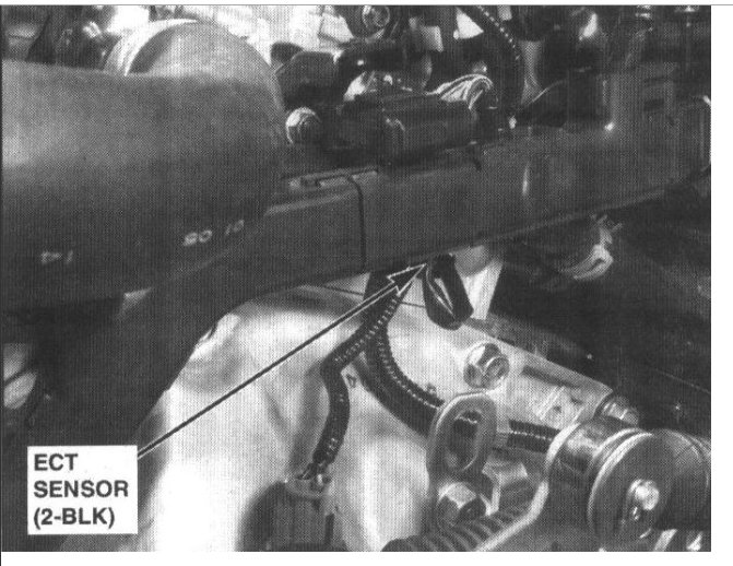

You are getting closer. I am wondering if you have an engine coolant temperature sensor causing the issue. If the sensor is off the PCM can enhance the shift to match the driving conditions.
Here is a guide to help you see what you are in for when changing the sensor out:
https://www.2carpros.com/articles/coolant-temperature-sensor-cts-replacement
Here is where it is on your car (below).

Finally got around to solenoids B and C, after testing they did make a clicking noise but very lowly. After removing the solenoid I discovered a residue built up around the input/output tubes. After spraying with cleaner, and placing the tubes back one by one, I have driven the car back and forth to work the past few days. Progressively the shifting has gotten much smoother with more use, and now there is no violent buck at all and shifting occurs at a much faster pace. It seems that may have been the solution to the problem. I will be sure to do a coolant flush later as I am not too sure what kind of coolant was previously used. All in all, thank you both JacobandNickolas and Ken, your knowledge was of great help. All the best.
