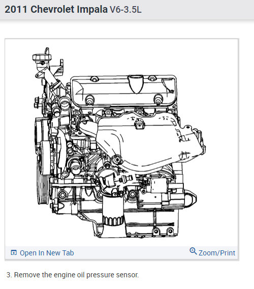

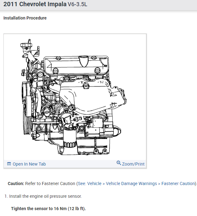

Does my car have an oil shut off switch by chance? When we noticed the issue yes we contacted the shop and was given the run around of he would meet with my husband and take it back to the shop, but never would show up when we figured out what the problem was. the oil was barley registered on the dipstick.
Aug 26, 2021 at 1:49 AM
SQM
  • 6,383 POSTS

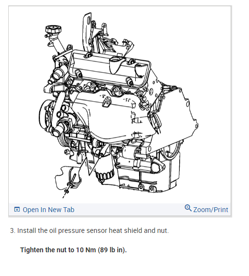

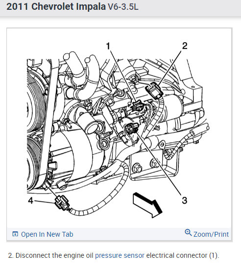

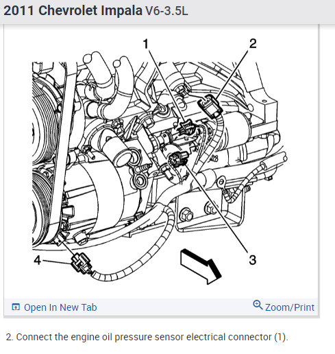

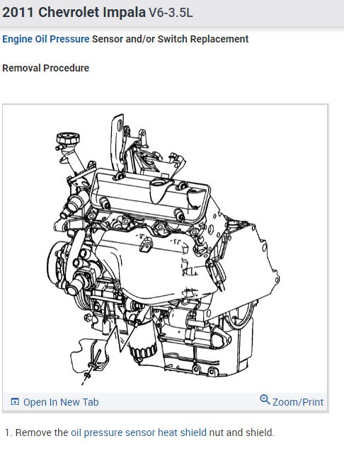

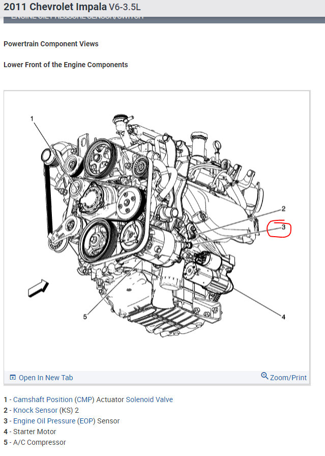

It does have a oil pressure sensor, which could trigger the no start due to not sensing oil pressure. It will send a signal to the computer of no pressure and the computer will not allow the engine to start.
The biggest issue is when an engine gets started with no or very low oil the internal friction of the engine components will create hot spots and could lead to severe damage. And you won't know what the damage is unless the engine gets taken apart.

Okay, would the oil pressure sensor reset itself once oil was put in it or does that have to be done manually?

It will depend on the error code that got generated by the sensor. Might have to clear the code before trying to start it again, after you add oil.
Just keep in mind there could be internal damages due to the start with no/low oil.
And if the engine is seized it will not start regardless of the sensor.
