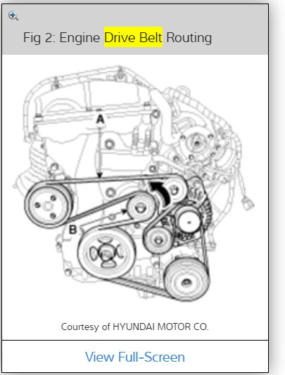

To me it sounds like the serpentine belt, or the heater core has an air bubble in it. I would wait until the engine is cold and then open the radiator cap to check the coolant level. Also, if the replacement belt is of a low quality, I would swap it out for a new one. While the engine is running inspect the belt operating, if there is a lot of vibration the tensioner can be bad as well. Check out the images (below). Please upload pictures or videos in your response to the problem so we can see what's going on.
