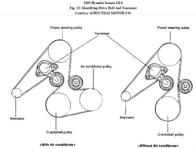

Six cylinder two wheel drive automatic 58,000 miles.
Anyone know where I can find a serpentine belt routing diagram for my vehicle?

Let me know if that is what are you looking for.
https://images.2carpros.com/forum/automotive_pictures/99387_hyun_1.jpg
