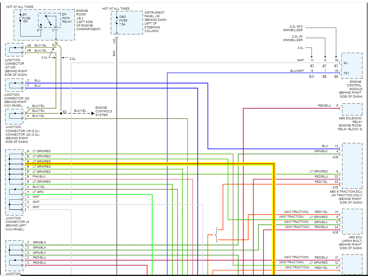

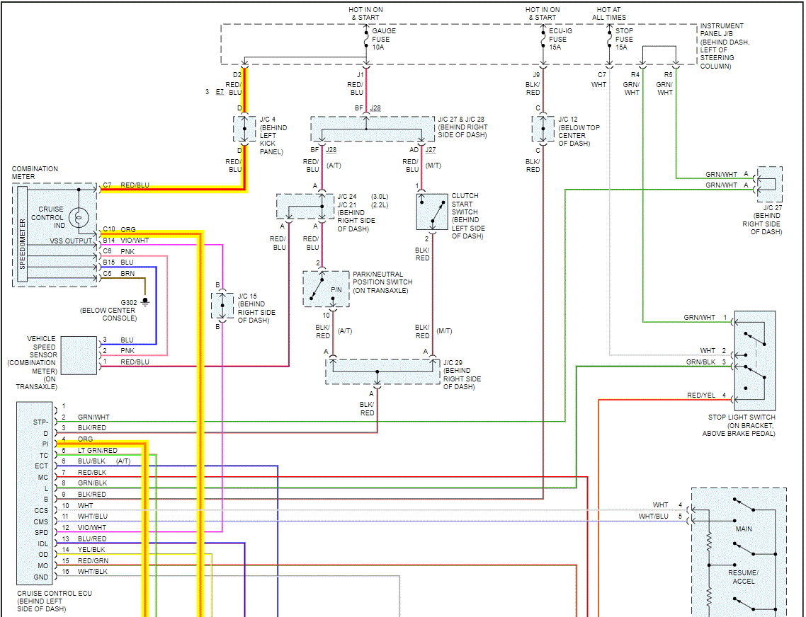

If it is flashing and won't reset by turning it off and then back on, it could be several things. I attached the wiring schematic below. It's possible that a wire is disconnected or damaged in one of the kick panels or under the dash in the CC ECU.
Make sure the brake lights are working and there are no burned-out bulbs. A faulty brake light switch could cause issues. Also, it could even be a wheel speed sensor. Is there anything you can think of that may have led to it happening?

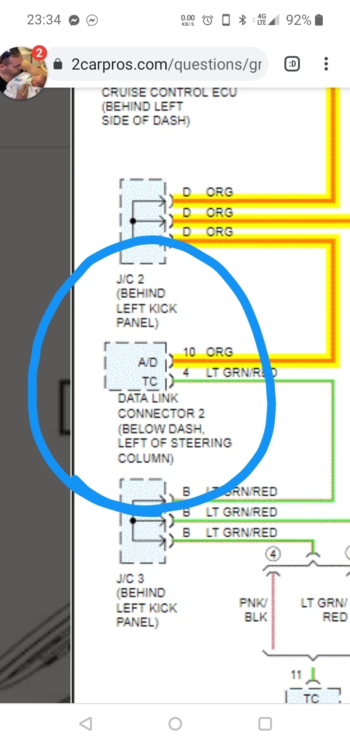

Looking at the wiring diagram you sent. I believe that one of the connecter is the one I can't find to plug back in. I circled it in the pic. Where does it go or plugged into?
Thursday, July 29th, 2021 AT 11:36 PM
LBCHIC562
  • 19 POSTS
This is the one connector I do not know where to plug it in at.
Thursday, July 29th, 2021 AT 11:49 PM

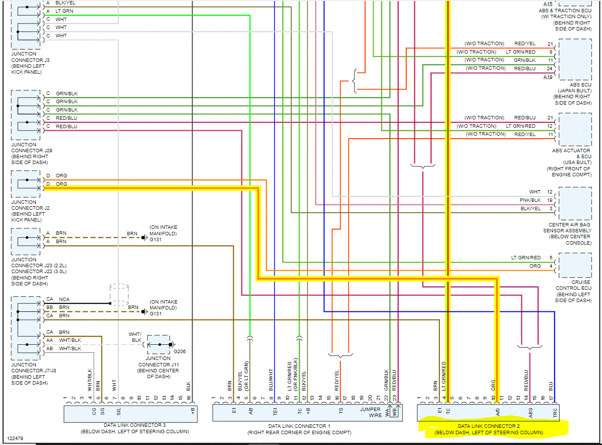

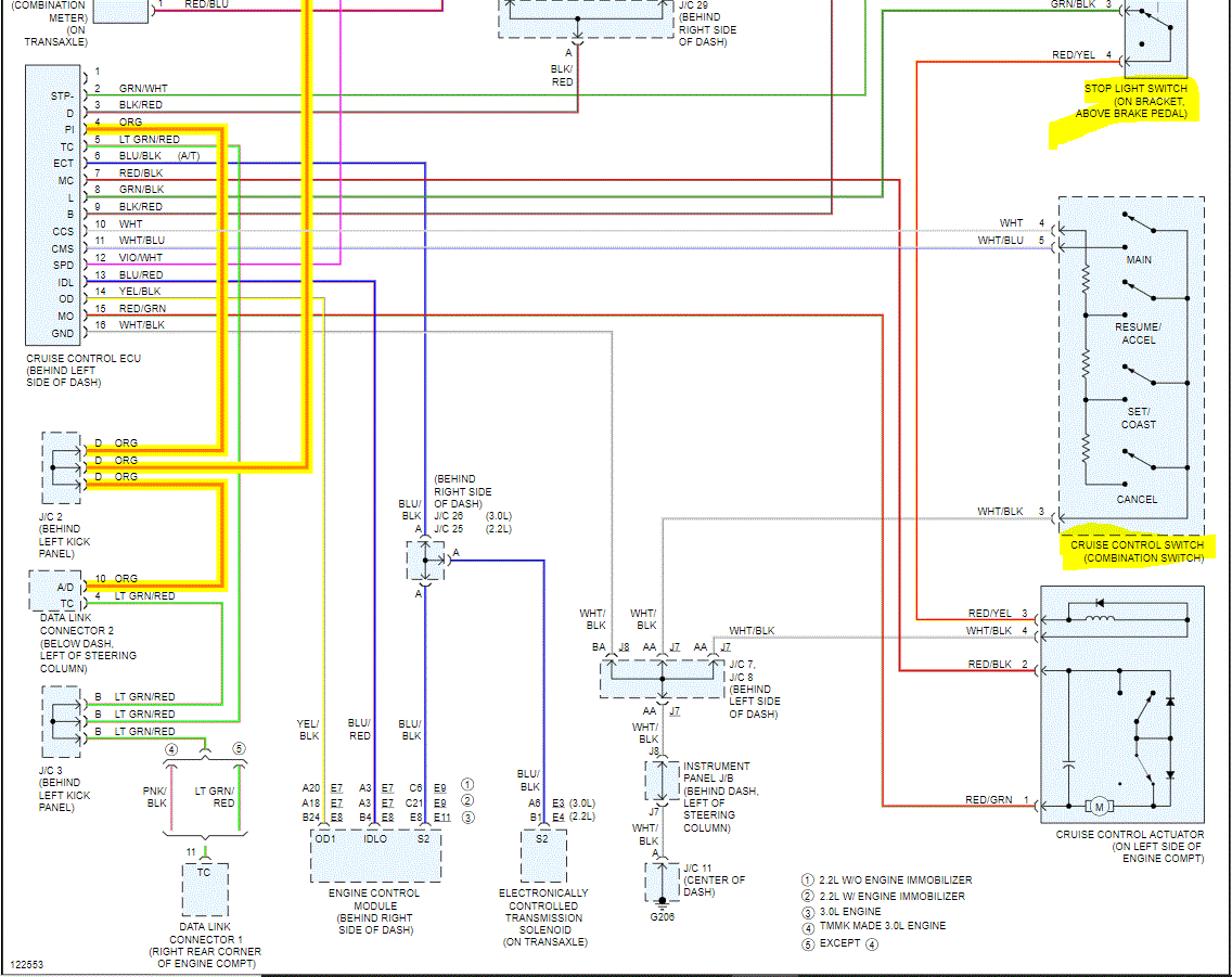

  • 109,867 POSTS
At the point you indicated, they are behind the left kick panel at a junction. At the opposite end, they plug into the rear of the data link connector under the dash.
I attached a schematic (cut in half) below. Let me know if that helps you.
Note: If you follow the orange wire, it runs to the cruise control module.
