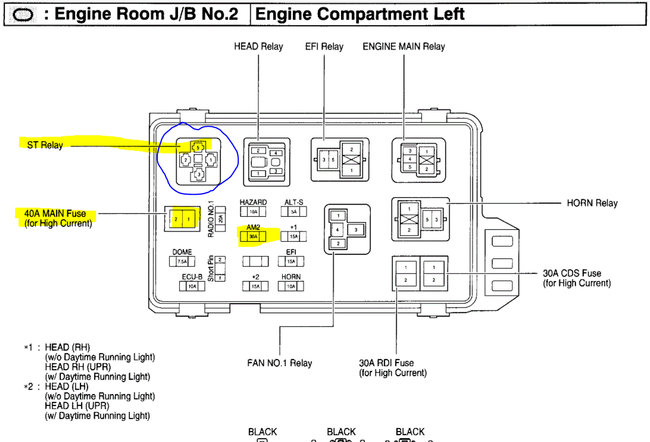

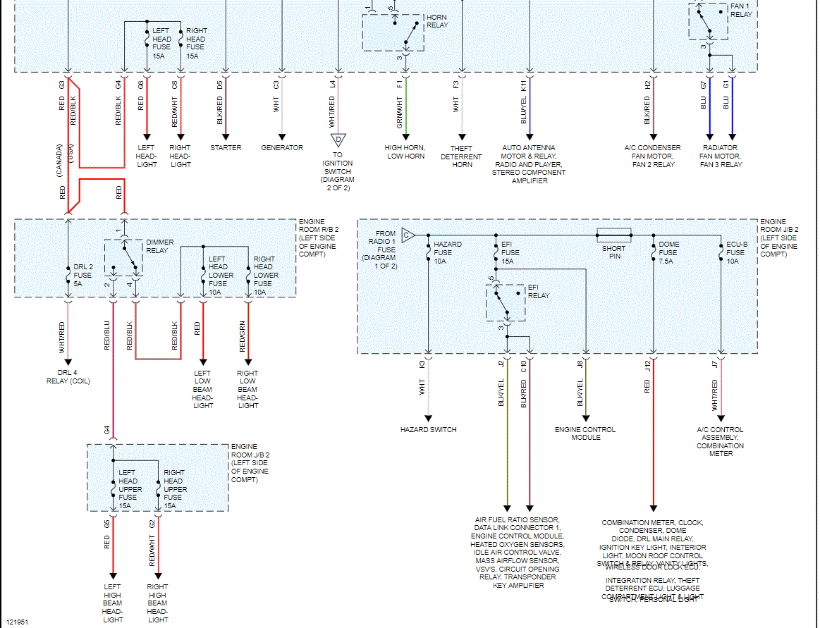

First, I'm not sure how you provided power to the fuses that were dead, but make sure they are safe from being damaged and shorted. Also, as far as the battery is concerned, you're lucky it didn't catch fire.
Regardless, I don't think the radio caused the problem and I don't know if it was an aftermarket anti-theft system removed. So, I have to start at the beginning.
Let's figure out why the starter won't engage and start the engine.

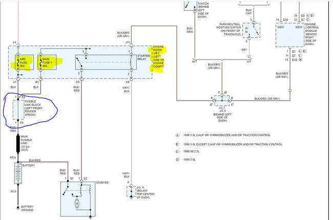

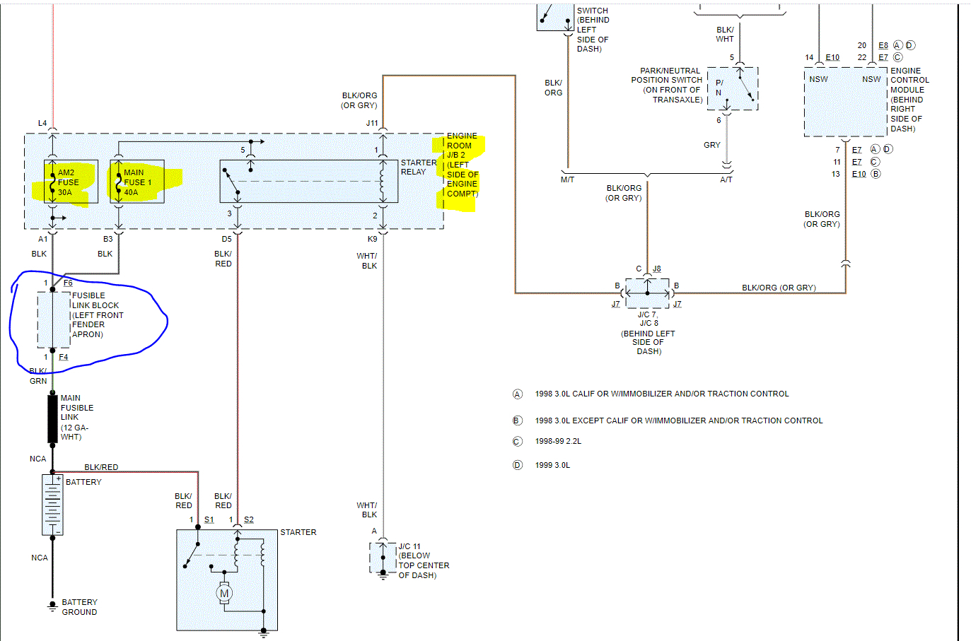

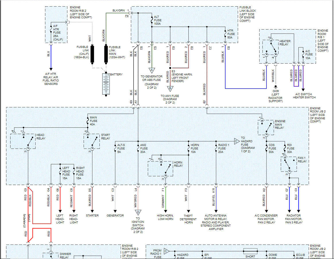

I attached the wiring schematic below of the starting system. The first thing I need you to do is check the AM2 fuse and the main fuse in the underhood fuse box. Now, in addition to checking the fuse, confirm there is power to and from them.
If the fuses are good and have power, switch the starter relay with a different one in the box having the same part number. If there isn't one, here is a link that shows how to test a relay:

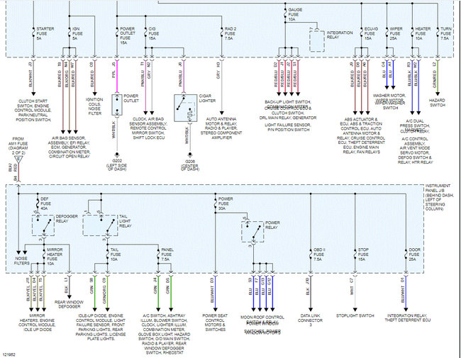

Pic 3 below shows the fuses and relay location in the box.
Check those and let me know what is found. Note: I had to cut the schematic in half to make it readable. I did, however, overlap them so you can follow from one to the next.

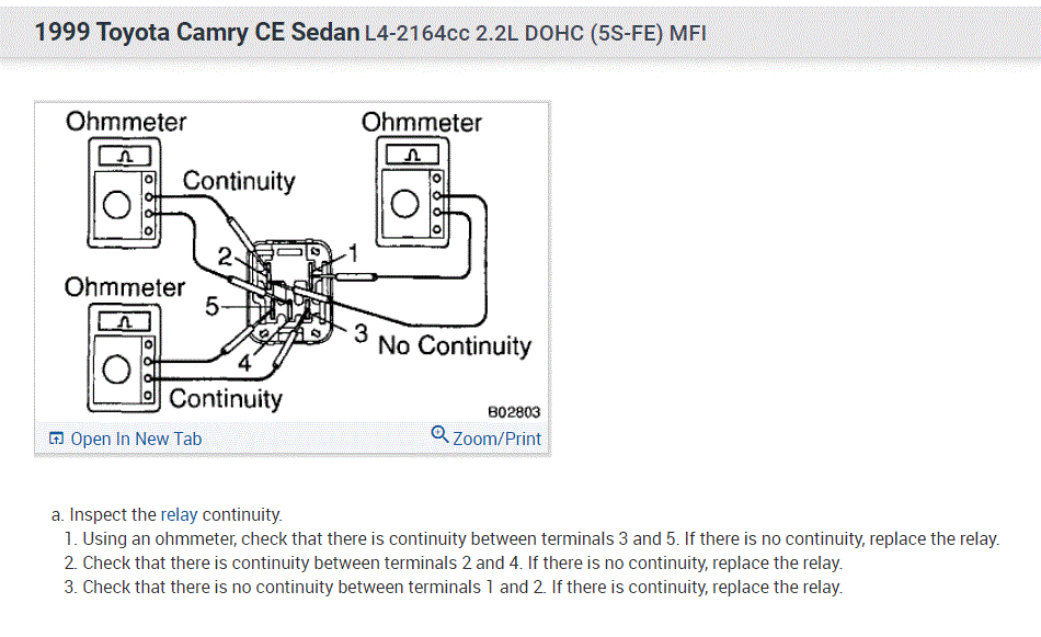

Hey Joe thanks for the info. So I check all of my relays by testing for continuity adding power and then checking continuity between 30 and 87 and also by the light testing it two of my relays has corrosion on them so I checked the circuits which they came out of I have no continuity coming from 30 terminal when applying power. what should I do next? the two relays are my head relay and my main engine relay.
Jul 12, 2021 at 1:17 PM
  • 110,244 POSTS
Are you not getting power to the relays? Is that what you mean?

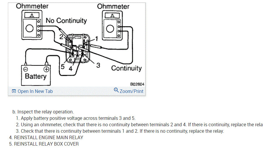

Do me a favor. Take a look at the attached pics below and let me know if that is how you tested the relay.
Jul 12, 2021 at 1:43 PM

That helped me out a lot. It's definitely a bad relay. Do you have that diagram for the head relay and efi and starter relays? also how would I check the part which they plug into that it is working.

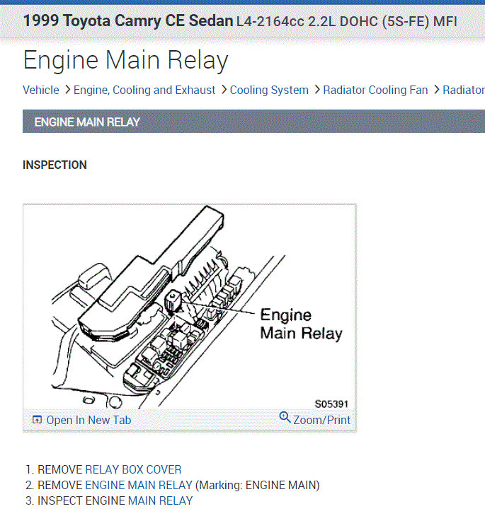

Are you looking for the location of those relays or do you want the wiring schematics? As far as the relays, here is a link that shows how to check one:

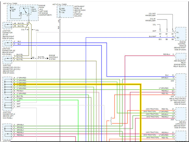

  • 110,244 POSTS

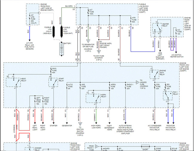

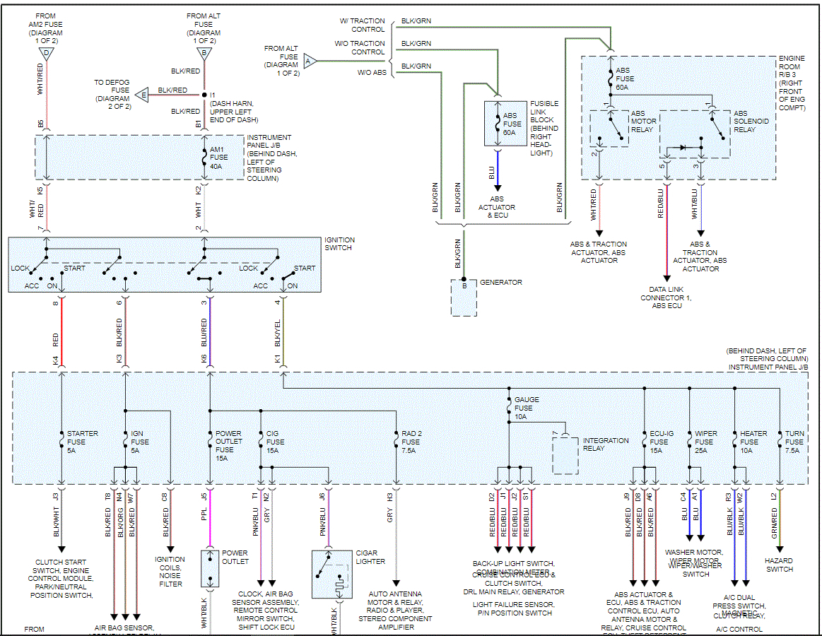

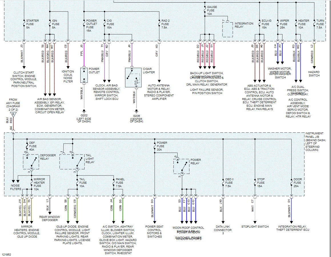

You're very welcome. I attached the power distribution wiring schematics below. I had to cut them in half to make them readable, but they are overlapped so you can follow them.
I hope this helps.
Jul 13, 2021 at 2:31 PM

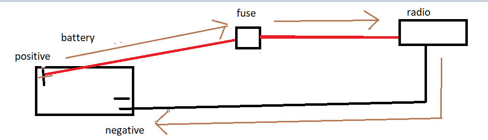

In this case, it is really based on what you are powering. In most cases, power (+) enters one side of the fuse and the opposite side goes to what is being powered. A ground is provided from a different supply.
If you were to hook positive on one side and negative on the opposite, you would be causing a direct short and it (hopefully) will blow the fuse.
I tried to draw a pic of what I'm saying. Don't laugh at it. LOL Look at the pic below and you'll see how the circuit could be completed. Power flows from the battery, through the fuse, to the component, and then to the ground. I used a radio as an example.
I hope this makes sense. Let me know if you understand.
See pic below.

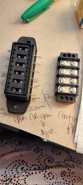

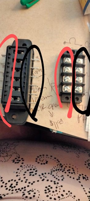

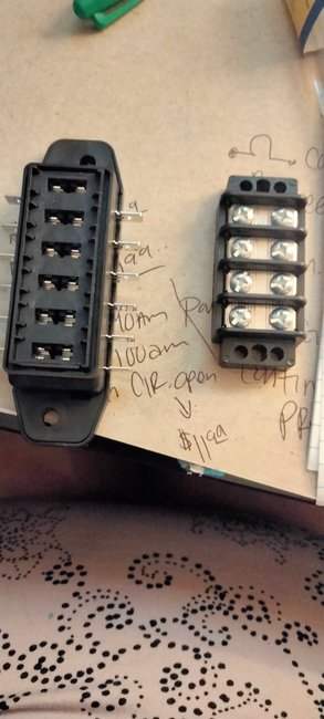

Great pic. I get the point of fuses I just don't know how I would wire the fuse block I sent the pic of. Like what do I connect to the spade outputs. On the fuse block.
Jul 18, 2021 at 2:21 PM
LBCHIC562
  • 19 POSTS
I circled in the colors that corresponds to the terminals on the battery for the screw (busbar) I know some people use separate bars for negative and positive but is it possible to use the same Bar for both? As for the fuse block would on side going to the positive of my battery and the other to the original circuit?
Jul 18, 2021 at 2:26 PM
  • 110,244 POSTS
If I understand correctly, no, you can use the same bar for both positive and negative. That will create a short.
I'm sorry if I misunderstood you. If you feel I have, let me know.
I just noticed that you had two posts. What are you going to power with each fuse?

Okay, I understand now I cannot use the same bar.
Jul 18, 2021 at 2:40 PM
LBCHIC562
  • 19 POSTS
Will this work?
Jul 18, 2021 at 2:51 PM
  • 110,244 POSTS
I believe that will work. You just don't want to hook a ground and positive up to the same bar.

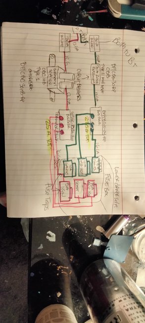

Okay, and if I wanted to add a circuit breaker and fuses. Would this diagram work? I drew it up hope you can make sense of it. I figure once the original fuses gain power back they will already be grounded to their original sources.
Jul 19, 2021 at 10:40 PM
  • 110,244 POSTS
It's really hard for me to understand what I'm looking at. As long as you take power through the fuse to the component it is to power, the ground should be provided by the component.

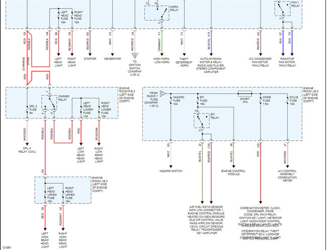

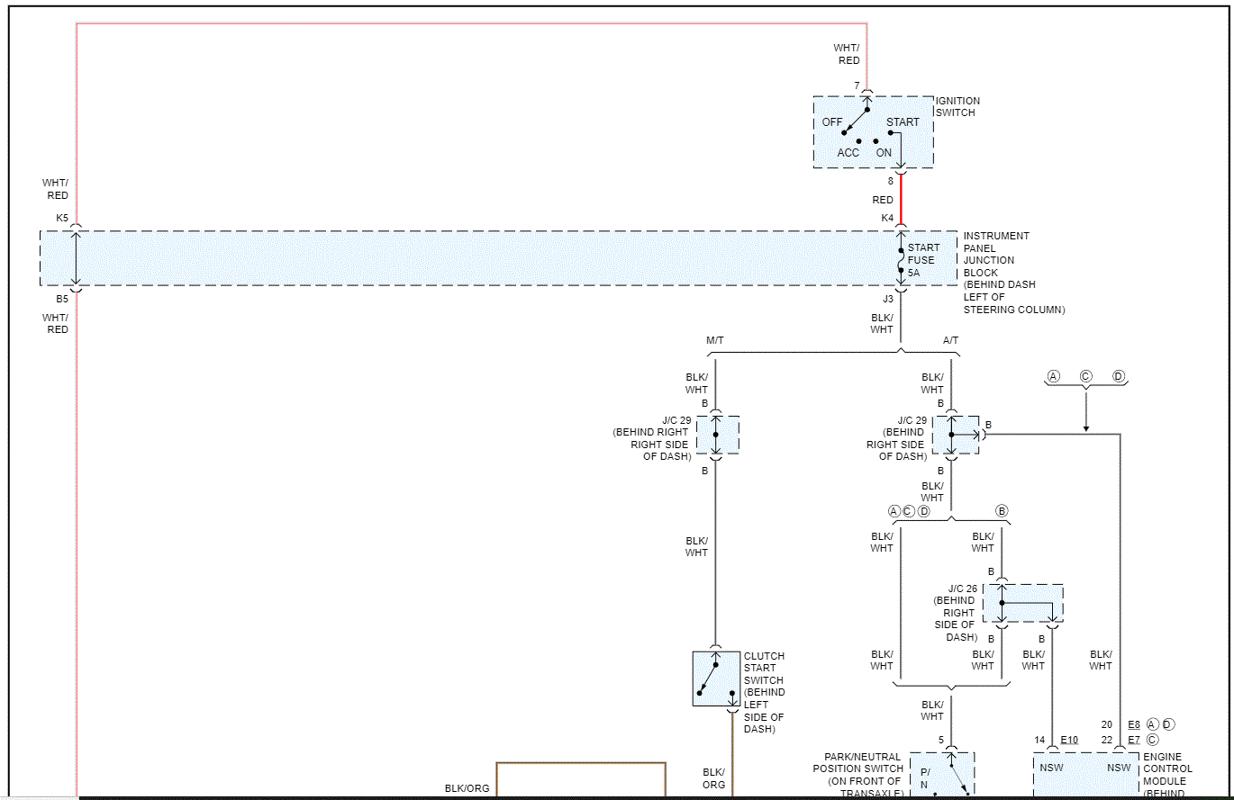

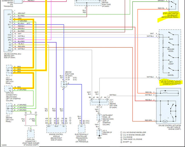

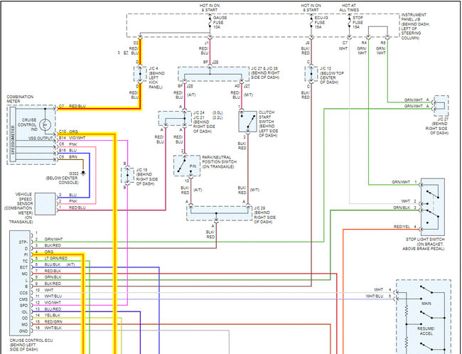

If it is flashing and won't reset by turning it off and then back on, it could be several things. I attached the wiring schematic below. It's possible that a wire is disconnected or damaged in one of the kick panels or under the dash in the CC ECU.
Make sure the brake lights are working and there are no burned-out bulbs. A faulty brake light switch could cause issues. Also, it could even be a wheel speed sensor. Is there anything you can think of that may have led to it happening?
Jul 29, 2021 at 12:37 PM

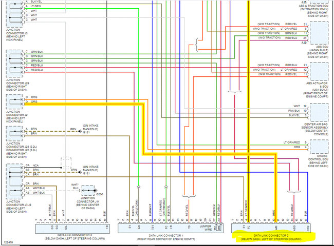

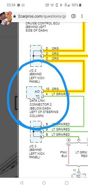

LBCHIC562
  • 19 POSTS
Looking at the wiring diagram you sent. I believe that one of the connecter is the one I can't find to plug back in. I circled it in the pic. Where does it go or plugged into?
Jul 29, 2021 at 4:36 PM
LBCHIC562
  • 19 POSTS
This is the one connector I do not know where to plug it in at.
Jul 29, 2021 at 4:49 PM
  • 110,244 POSTS
At the point you indicated, they are behind the left kick panel at a junction. At the opposite end, they plug into the rear of the data link connector under the dash.
I attached a schematic (cut in half) below. Let me know if that helps you.
Note: If you follow the orange wire, it runs to the cruise control module.
