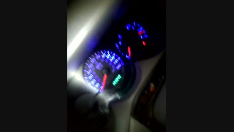

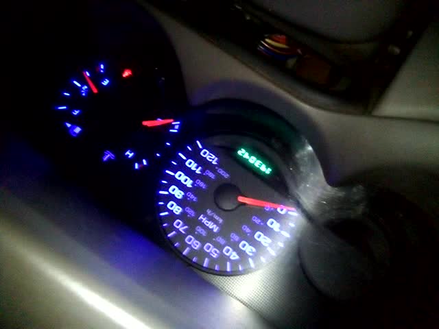

This is the noise its making and yes I do

Did you see the video
Wednesday, November 22nd, 2017 AT 12:00 AM
SATURNTECH9
  • 30,869 POSTS
Yes but I really couldn't tell much from the video did you try what I asked you to do?Even if I was there in person I would be still trying that.
