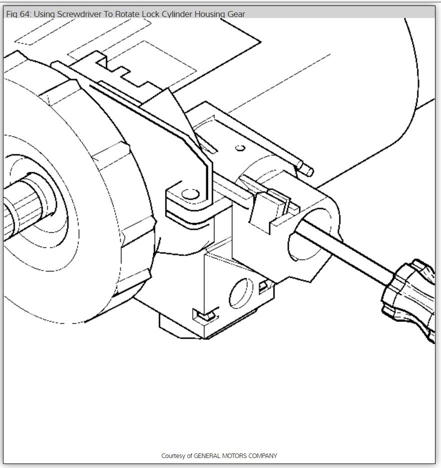

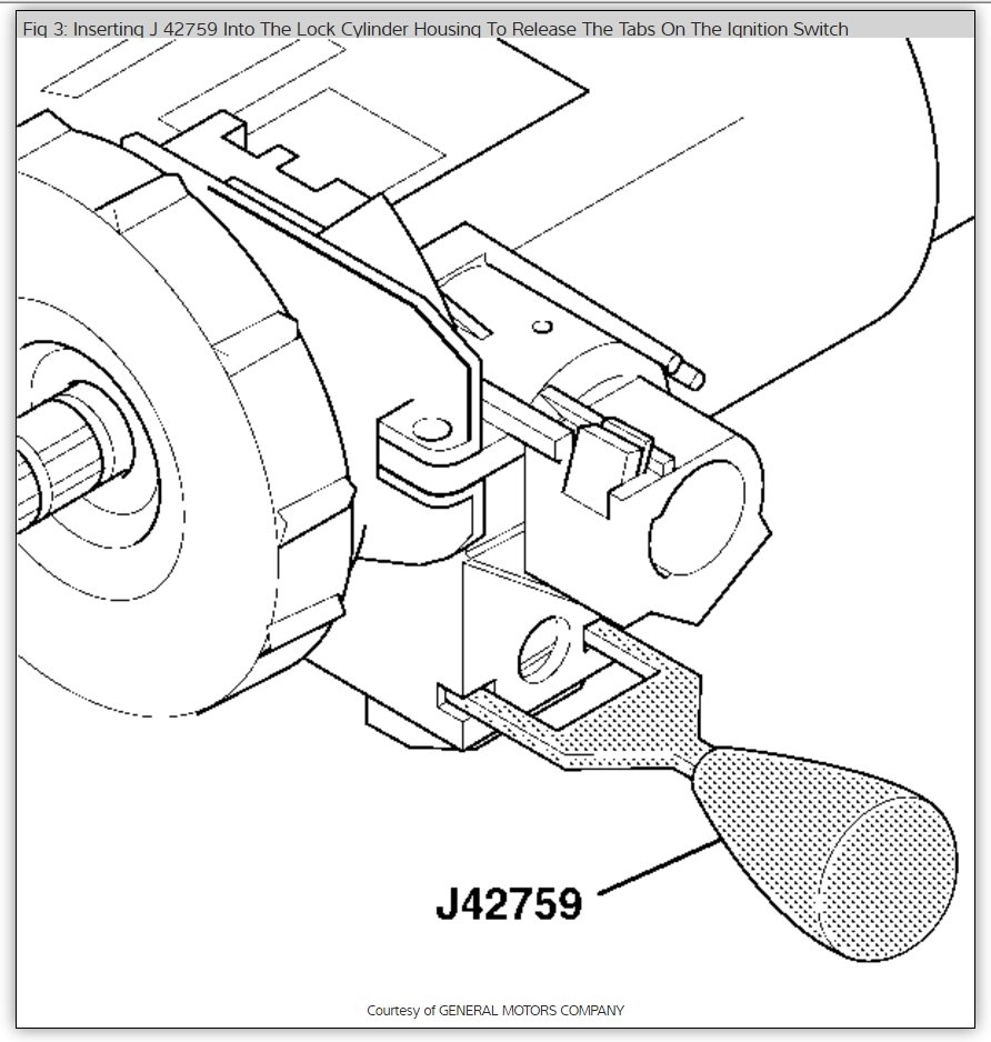

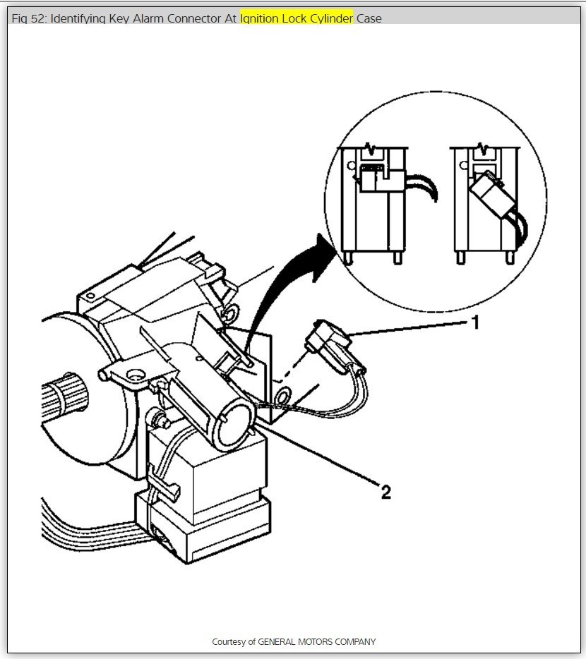

  • 55,649 POSTS

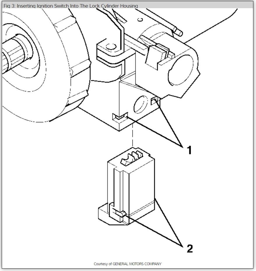

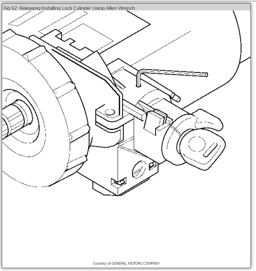

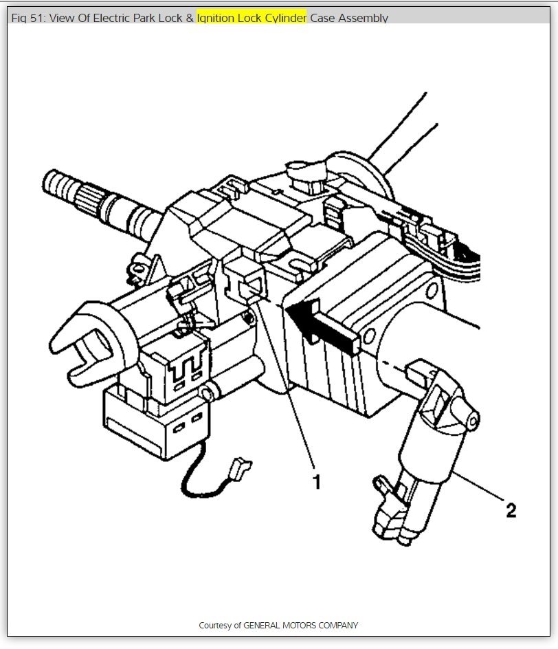

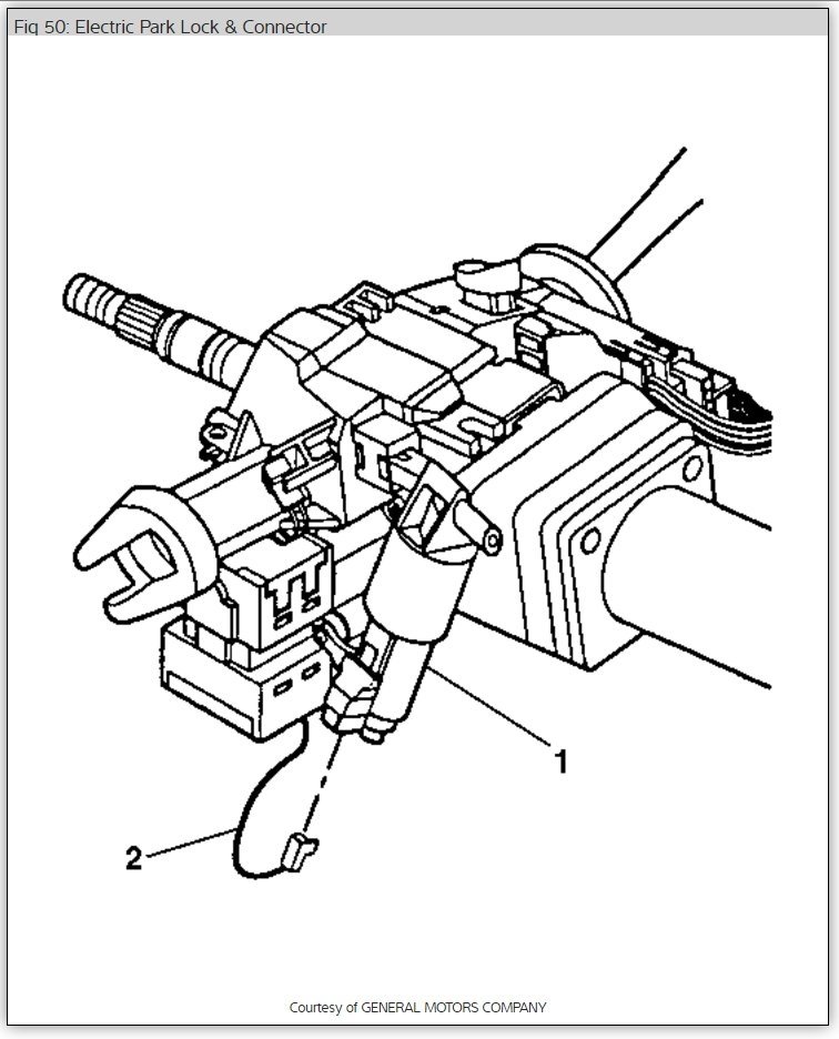

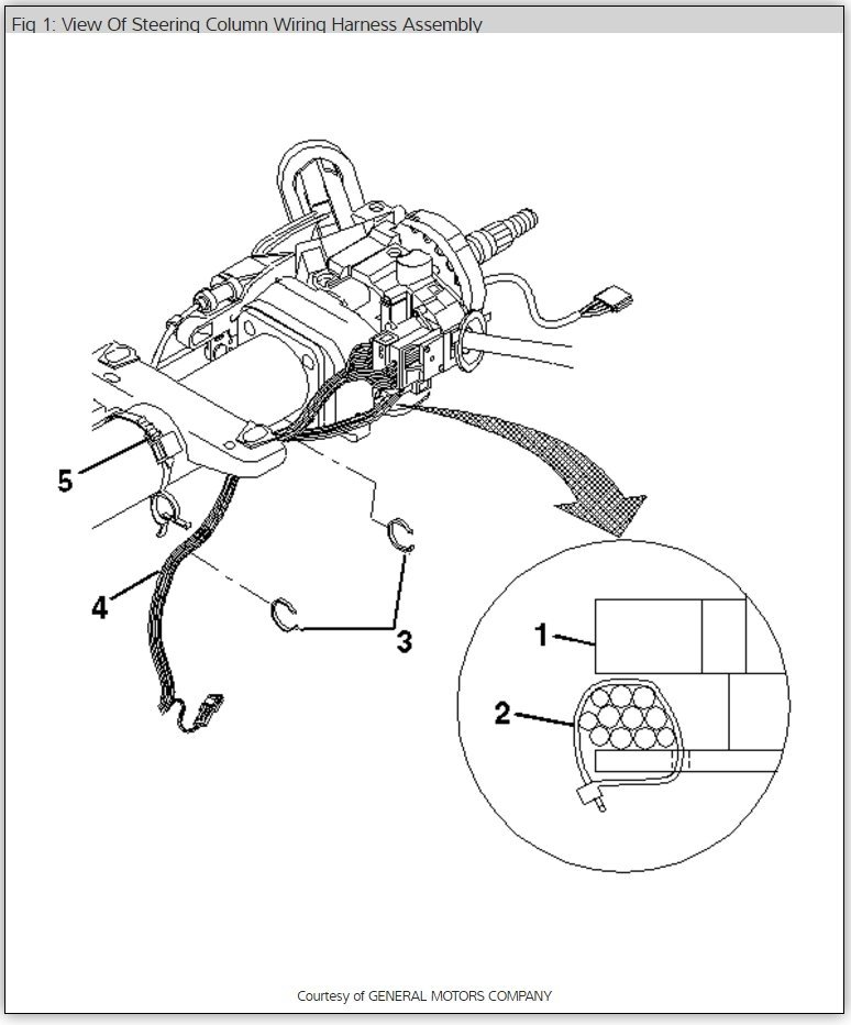

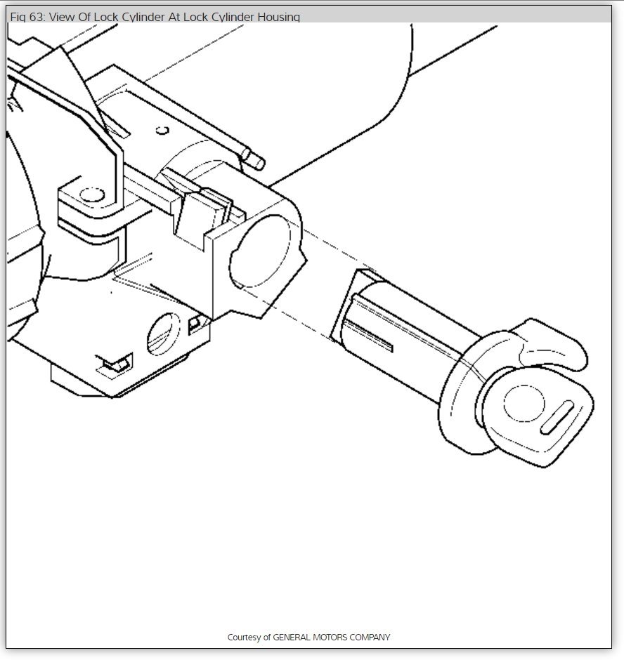

Here is how the job is done so you can change out the ignition key lock tumbler. Check out the images (below). Let us know what happens and please upload pictures or videos of the problem.
