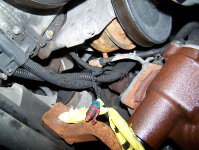

I also see a 2-pin connector just hanging about 8" off of the positive battery block (red plastic box) but can't see anywhere that it might go. I've tried looking at other Yukons but haven't found someone with the same year as mine.

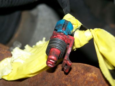

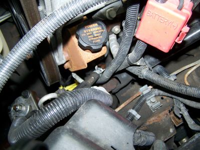

https://images.2carpros.com/forum/automotive_pictures/312976_Yukon_Loose_Connector_002_1.jpg
https://images.2carpros.com/forum/automotive_pictures/312976_Yukon_Loose_Connector_003_2.jpg
The 1st picture shows a closeup of the connector hanging from the battery block. The 2nd picture shows a view of the plug from underneath. And the 3rd shows the plug from the top. This photo also has the red battery terminal that it comes from. In this pic, you can see the plug at the bottom (I tied it to a yellow caution strap). Because of the way it looks, and the closeness to the belts/pulleys, I think it has to go somewhere. I just can't find ANYWHERE. Could this be the problem? I am taking the starter off in the morning....but hopefully can get an idea of what this plug would go before I have to take it off. Thank you very much. Thanks.

ok is there a sensor on the power steering pressure hose close to this connector?
