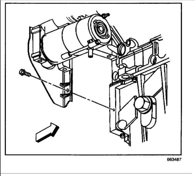

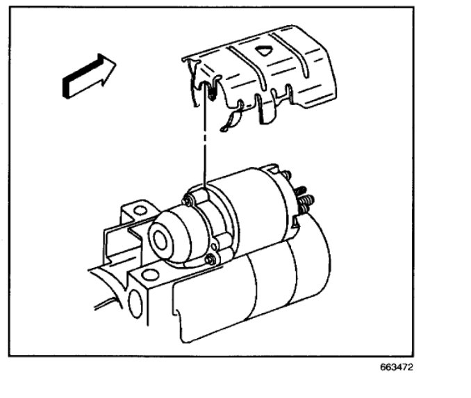

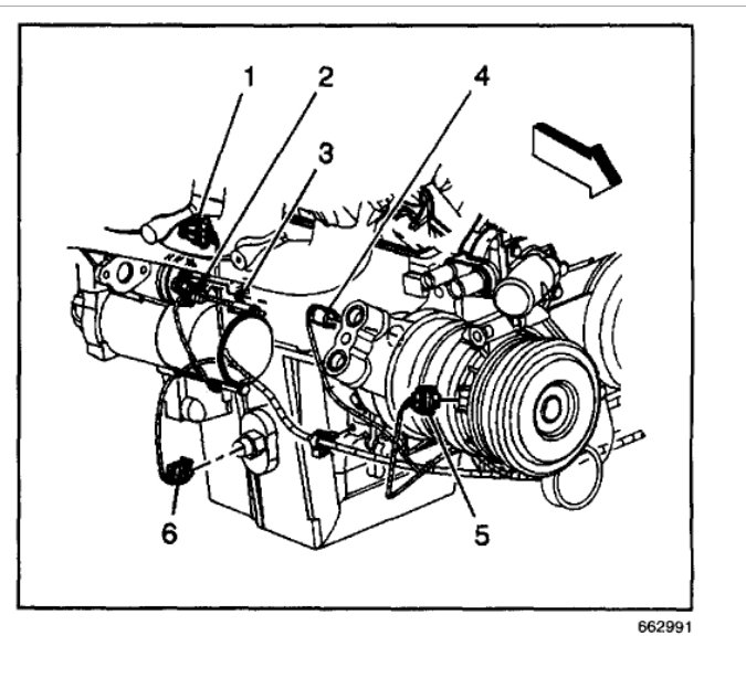

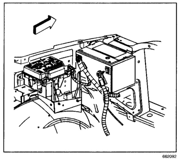

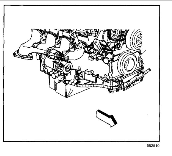

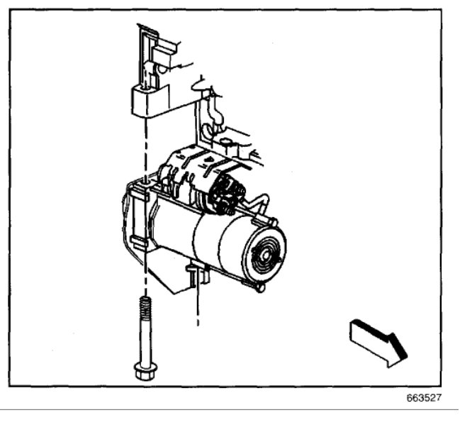

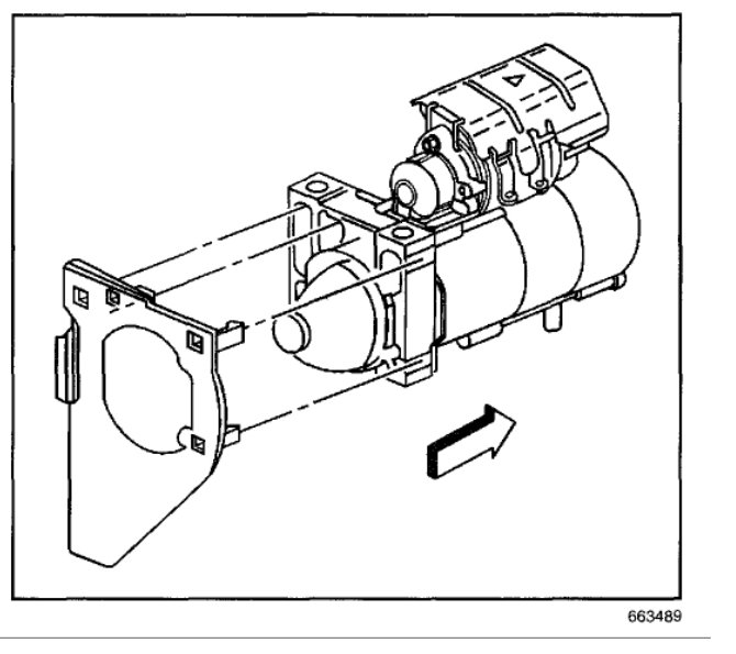

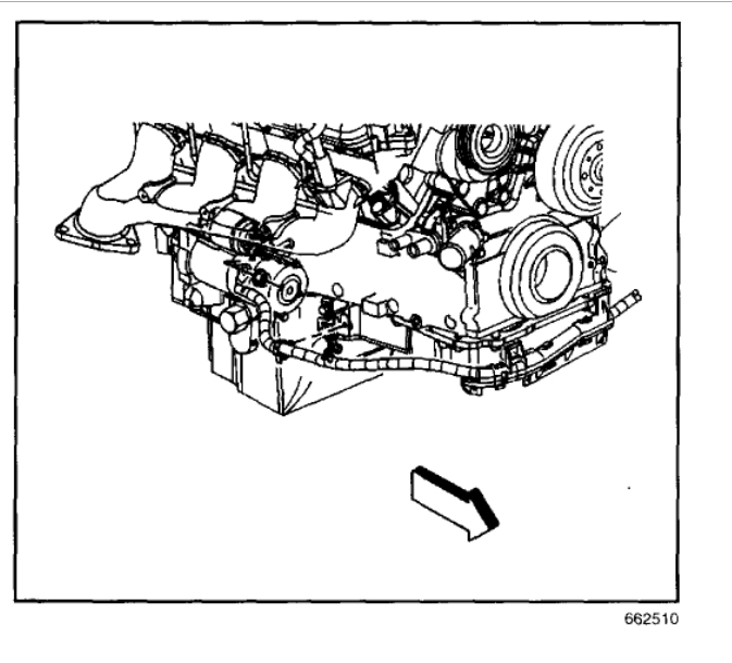

Cannot remove starter after removing starter bolts, oil sensor connector and trans housing bolt. Starter will not clear transmission. It must go forward about (1) inch more. Any Ideas?
Nov 13, 2008 at 8:08 AM
  • 55,694 POSTS
It should come out but if not remove the through bolt from the right side motor mount and jack the engine up a couple of inches.
Here is guide to help you see what you are in for when doing the job.
Here are some diagrams of what it is like on your car (below)
You will need to raise the car as well
