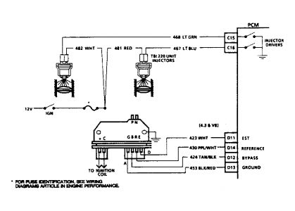

Ok does this thing spit or sputter or even try to start? I am thinking that we should look into the timing control module it is different and seperate from the ignition module. I can walk you through the test if you like. Here is pic of how it connected and such. So if you like I will walk you through the test. Get back to me

Yes it does try to start Ok I tested that and all other sensors that have to do with the starting system .
All seem to be good .
