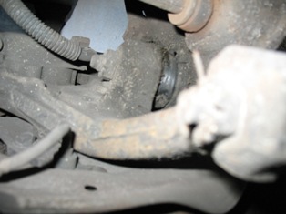

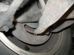

Hello I have a noise in the front end on the passenger side. Little bit of play but nothing serious I donot think. I looked underneath and did see that the lower control arm has dropped down (I Think) into the splash guard behind the brake rotor. It has cut into it pretty well. That is all I can see/ What do you think?

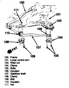

hello Trafficflow
https://images.2carpros.com/forum/automotive_pictures/46384_0900c152802505e5_1.jpg
the bolts 105 might got lose for the lower control arm. the insulator might be wore out.

Look at the pic below. I do not think that diagram was correct below There is no bolts holding that bar. I do not see no loose bolts or wore out bushings. I sent this earlier but the guy never came back. Should I donate again? But something is letting it sag Any other ideas? I am afraid to drive at a high rate of speed.

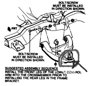

https://images.2carpros.com/forum/automotive_pictures/46384_0900c152802505f6_1.jpg
check for a brokken ball joint. there should be a ball joint that attach the lower control arm to the steering knuckle.that ball joint is the load carier one.it was either revited to the control arm, or pressed or threated or it was press fit. it is dangerous to have that vehicle in traffic. One time donation is enough. More questions? feel free to ask Happy thanksgiving

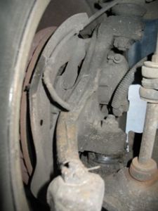

Hello, I have a few more pics and went up to Auto zone and they have the part and the tool to press it out. Do i need to compress the spring? Anrd then use a pickle fork to seperate it? I am doing Thanks giving today so I had to take the car off the jacks so I could use the garage. One other thing my friend up at Auto Zone was to check the bearing also. I know what you are going to say about AZ but this guy is a semi retire that I have got to know. Thanks

Thank you for the pics, they look clear.
you have a SLA ( short-long-suspension arm) with the spring resting from the lower control arm, that make our problematic ball joint a load carrying one.
damage to it could put more weight on the bearing as long as the problem is not fixed, so your friend is right about the bearings.
Here is the first thing to do for safety precaution:
-Reach across to jack the control arm from the opposit side of the vehicle. this will allow the jack to roll toward the inside of the vehicle as the control arm is lowered releasing spring pressure..
- remove the cotter pin from the ball joint nut and loosen the nut several turns.
-position the vehicle so that the coil spring is pushing on the ball joint.this will require lifting the vehicle or allowing its weight to rest on the wheels
- use a hammer to pound sharply on the steering knuckle on the outside of the tapper.This will deform the tapperand spring pressure will separate the ball joint from the steering knuckle.
if it does not work, use a pickle fork to separate the ball joint.
tell me how far you have come.
