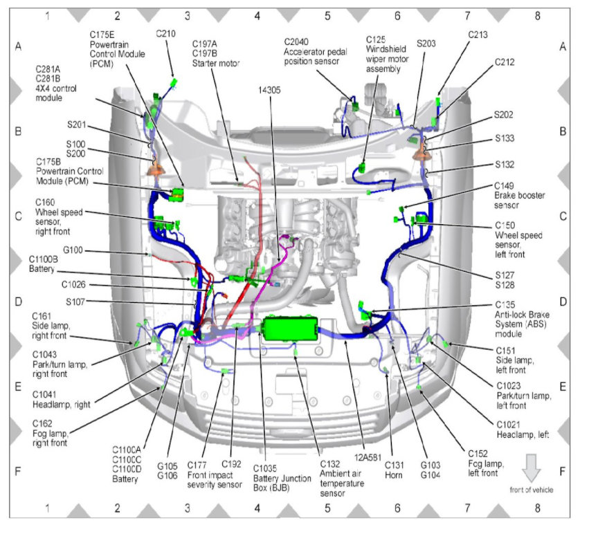

Sorry you said that, lol little slow this morning. I would remove all ABS sensors and do a visual inspection and test the wires if all connection power and ground are good the next step would by the ABS controller is bad and needs to be replaced. You will need a garage to program it for you.
Here is its location (below)
