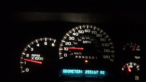

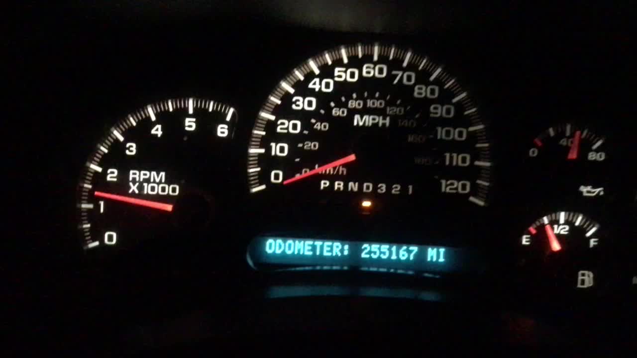

I’ve already scanned it, there are no ABS codes nor are there any codes on the PCM. My speed vehicle sensor did go out, it started jumping around, doing crazy stuff. Replaced the sensor in the transfer case, now the speedo is just delayed. When the Speedo is sticking that’s when abs is kicking it. The wheel speed sensors shouldn’t have anything to do with the speedo, would it? Abs is doing it’s job, however the PCM still thinks the truck is moving due to the delay/hang. I’ll post a video shortly.
Oct 25, 2017 at 2:39 PM
NATHAN BEAN
  • 10 POSTS

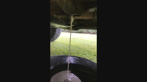

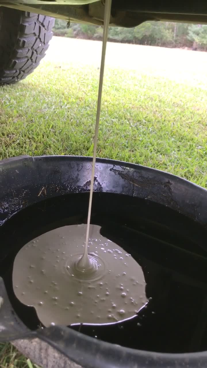

Kind of hard to tell but you you hear abs kick in, the truck is already at a stop. There is also a delay when taking off. I’ve verified this isn’t a problem in the cluster using my code readers live data to view the vehicle speed sensor. There is a delay, just can’t figure where its coming from. Another thing to mention, during the rescues of hurricane Harvey I got about 4 inches of water in the cab of the truck, never had any issues (electrical or mechanical) until now. This all started shortly after changing my transfer case fluid a couple weeks ago, which was quite milkey.

What/how does the pickup work in the transfer case for the speed sensor? Could something have gotten damaged from water being in the fluid? It wasn’t good coming out.

Here is a video
Oct 28, 2017 at 12:21 PM
  • 55,224 POSTS
O that is goopy for sure. Thanks for the video. Can you check the connections for corrosion please?.

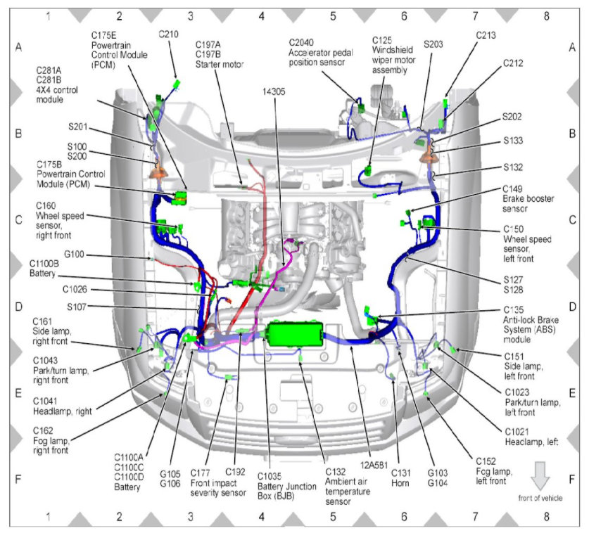

Sorry you said that, lol little slow this morning. I would remove all ABS sensors and do a visual inspection and test the wires if all connection power and ground are good the next step would by the ABS controller is bad and needs to be replaced. You will need a garage to program it for you.
Here is its location (below)
Oct 31, 2017 at 4:41 AM
