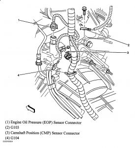

-When the key is in the on position (engine not running) it shows that I have oil pressure. I'm sure its the oil pressure sending unit I am unable to locate the oil pressure sending unit.

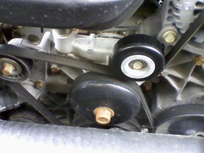

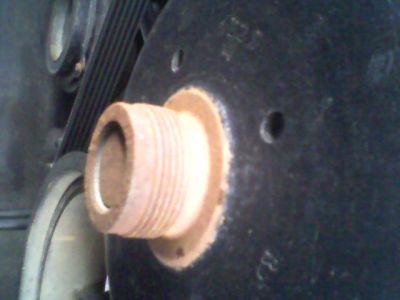

--it appears that something is missing on the front hub of the water pump pulley. I have electric cooling fan BUT you see the belt pulley and the shaft. The shaft is threaded. What is keeping the pulley on the spindle?

The oil pressure sending unit is located on the top rear of the engine block. Here is a picture.
https://www.2carpros.com/forum/automotive_pictures/249084_oil_1.jpg

I have sent you a new list of questions along with pictures still have recieved no reply..
https://www.2carpros.com/forum/automotive_pictures/421369_000002_1.jpg
https://www.2carpros.com/forum/automotive_pictures/421369_000001_3.jpg
https://www.2carpros.com/forum/automotive_pictures/421369_000001_2.jpg

Sorry, I just got the pictures now. As far as I can tell, there should be a fan clutch bolted on there with the fan attached to the clutch.
Here is a picture of a fan clutch. It would screw onto the threaded item and then the fan attaches to the clutch.

As you see in the picture, currently what is really keeping on that fan pulley? Is it a press fit? If the surpentine belt breaks will it come flying off and go through the rad?

It is most likely threaded in the center. As far as the smell, is it a coolant smell?
