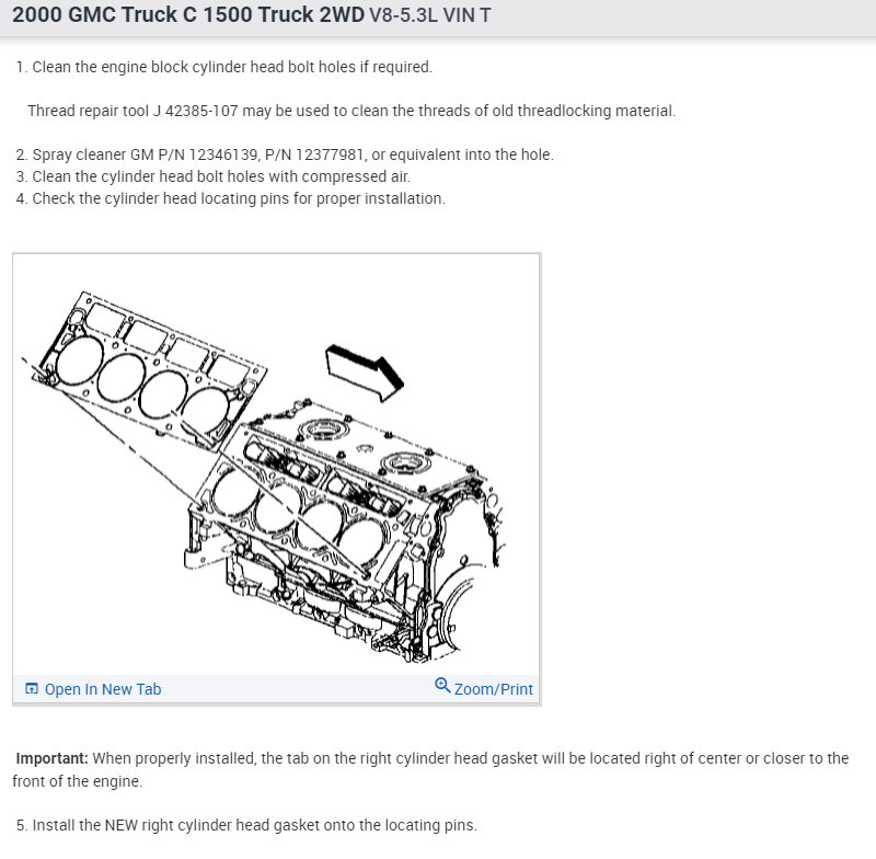

I've been loosing coolant when you take the oil cap off there is a yellow milky subject around the cap. there is no indication of water in the oil. could it be the intake gasket or something major like head gasket, there's no water leaking out of the exhaust and no misfires.
Nov 19, 2008 at 7:54 AM
SQM
  • 6,383 POSTS
The yellow milky residue indicates there is condensation in the oil. It could be due to a head gasket leak.
Best course of action would be to perform a head gasket leak test. There are few different ways to check. One of them is using a head gasket leak test kit. This test uses a chemical that detects any combustion gases in the coolant. It can typically be purchased at your local auto parts store.
Here is a helpful video:
https://youtu.be/5zpNjYmmiYY
Since you are losing coolant, it will be a good idea to do a cooling system pressure test. This can help you determine any leak.
https://www.2carpros.com/articles/radiator-pressure-test
