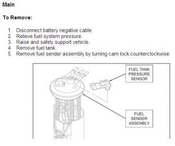

Install a fuel pump in a GMC Sierra 1996 5.7 LT 2500?

Welcome to the forum, my info is fairly generic. First, I'd make sure the pump is the problem. Then, take negative battery cable loose, drain the tank. Safely raise and support the vehicle, where applicable. Remove all connections from pump and tank. Drop the tank. You need to use your own judgement about how and what to take loose.
https://www.2carpros.com/forum/automotive_pictures/170934_fuel_pump_removal_1.jpg
