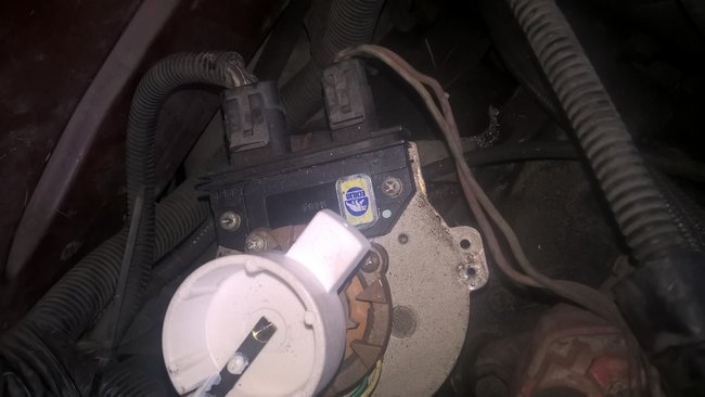

My '88 GMC will start just fine on a cold start. When I drive it for 1 mile and turn it off , it wont start. It turns over but wont fire. I have changed the ignition coil,distributor cap and rotor button. Did not fix problem. It almost feels like it's flooding out. there is a slight gas smell when I try to restart it. thinking maybe it's the fuel pump. would like a second opinion before i dish out more money. your help is needed and very appreciated. thank you

Ignition control module, super easy to fix. They go out in these makes and models often and are hard to pinpoint.
Pop open the distributor cap, its mounted with 2 screws, just a flat semicircle plate. Unplug the two electrical connectors, replace and put it all back together, you are done.
