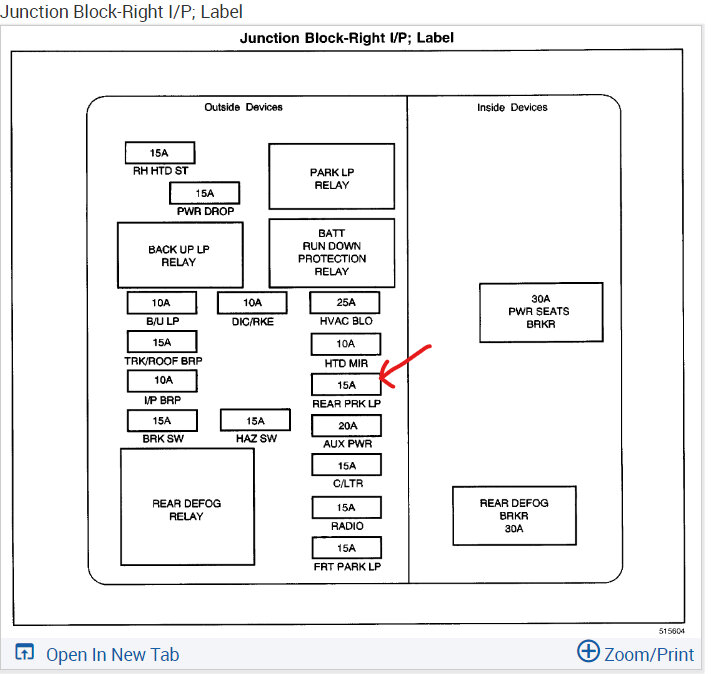

I have a 2001 impala LS with 95,000 miles on it. and my panel lights,stereo lights and air control light are not working when I drive at night. I check all my fuses and they all are good. I mean when I drive my care I can not tell how fast I'm going or see what station I am listening to because my interior lights don't work. What can I do to fix the problem or what's wrong with my car?

I would check the Rear Park LMP light fuse because it powers these systems, here is a guide to help and I have included the location of the fuse in tha images below. The fuse is in the right side interior fuse panel
Check out the images (below). Let us know if you need anything else.
Feb 22, 2006 at 12:14 PM
Suggested Repair
Check the Rear Park LMP fuse in the right-side interior fuse panel, since it supplies power to the instrument panel, stereo, and air control lights.
