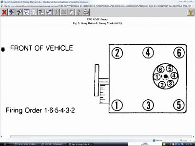

i have a 1992 GMC Jimmy, with 63,000 miles on a new crate 4.3 Vortec that was in truck when i bought it. i had to replace the distributor and distributor cap, but think i have the plug wires connected to the distributor in an incorrect order. what is the correct order??

1,6,5,4,3,2! Need anything else call us!
https://images.2carpros.com/forum/automotive_pictures/62217_4_1.jpg
https://images.2carpros.com/forum/automotive_pictures/62217_30961_mitchell_2_43.jpg

Connect the spark plug wires to the distributor in firing order 1-6-5-4-3-2, using the referenced diagrams to match cap terminals.
