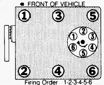

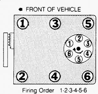

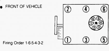

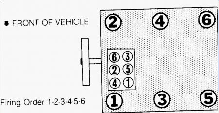

Hey lynda finley, This was good advice, there are several V6 engines and you didnt even bother to tell us which one you have, then we are to get the answer correct or else! img]https://images.2carpros.com/forum/automotive_pictures/62217_JimmyFO_2.jpg[/img]
https://images.2carpros.com/forum/automotive_pictures/62217_3_8.jpg
https://images.2carpros.com/forum/automotive_pictures/62217_38fo_2.jpg
https://images.2carpros.com/forum/automotive_pictures/62217_43fo_2.jpg
So for yours to be at 7 oclock to be striking the #1 firing position while turning it's a 4.3. Have a nice day. Or is it a 2.8? or maybe a 3.1? I did NOT see three oclock in his answer! He properly described set it to #1 cylinder. As you can see they ALL have #1 in the same place in rotation. If it was stated by you that you have a 4.3 maybe the answer could have been less confusing to you.
