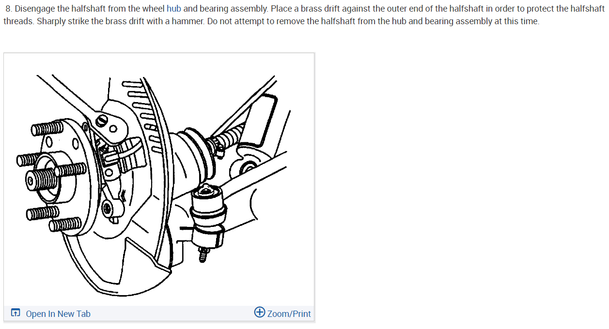

I just bought a used jimmy. I have noticed that when I make a turn that causes the vehicle to lean to the driver side, there is a loud squeaking sound coming from somewhere around the wheel area. This noise is loud and obnoxious. Could the axles need to be greased?

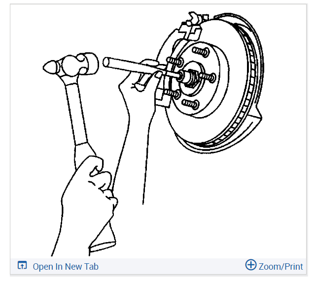

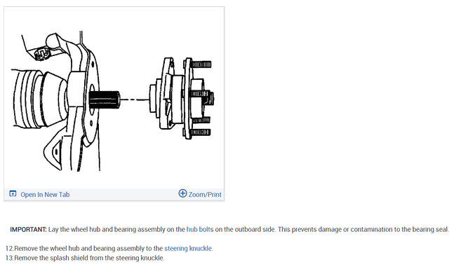

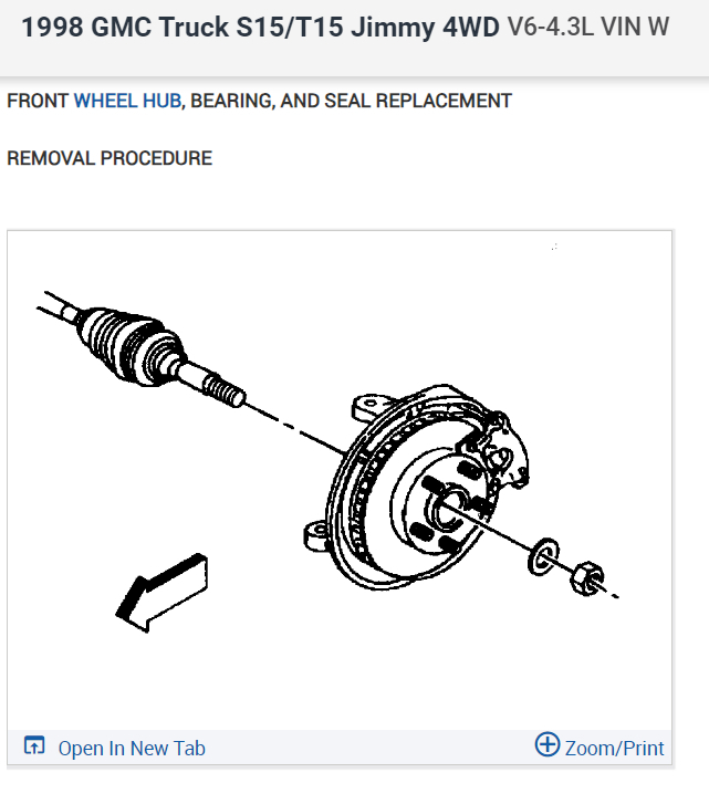

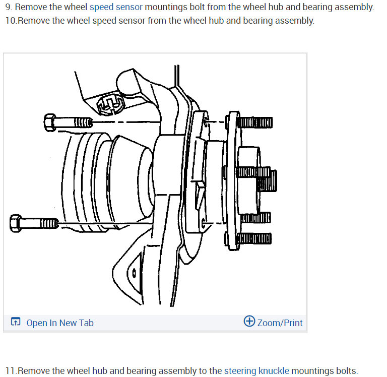

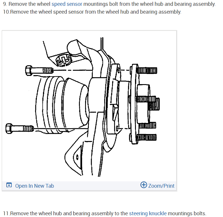

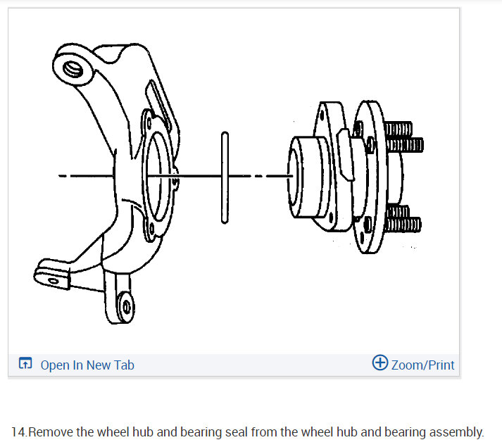

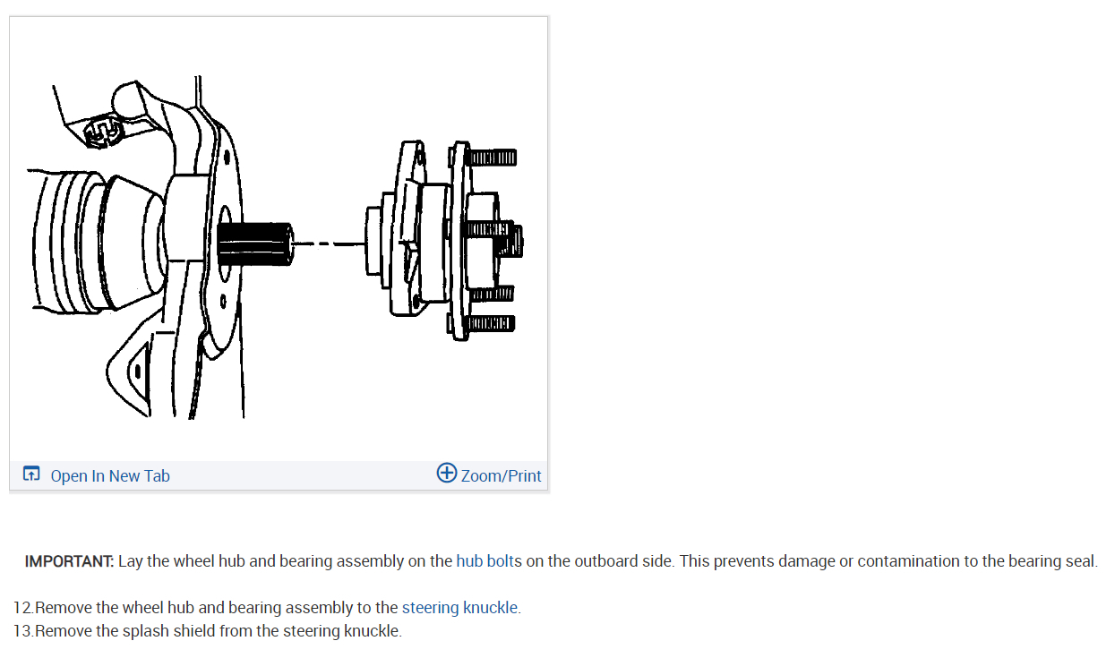

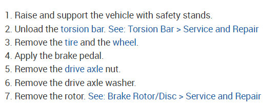

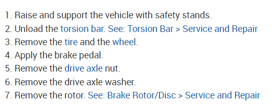

I have seen the bearing hub go out and cause this problem, raise the front of the car and spin the front wheel you will hear the noise.
this video shows how the job is done.
https://youtu.be/ZgiPRG6jffc?si=khWreQcMOCM1-HpA
Check the images below. Check out the images (below). Please let us know what happens.
