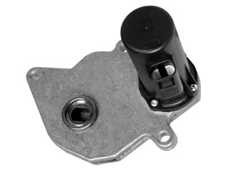

, have some faith in yourself , as a tech of 20yrs i have alot of tools and may have had made or bought a wrench to fitbut i dont think so , before you do pull the shaft look at the bolt really hard and make sure nothing will fit , wait are you looking at the right part , the encoder motor is on the left side of the transfer case , the only thing even close to the driveshaft is the motor housing which has no bolts , yours should have three bolts on the side , maybe im thinking you meant the torsion bar , i did one a few weeks back on a 99 same thing and it was out and in , in approx 15 minutes , let me know what you think and find
i was also sitting here wondering what exactly led you to the encoder motor?? usually when they go outthey will still make noise but not switch gears , i have pulled them apart and found out why , but if you have a different scenario let me knowyou are calling the encoder motor atccm, the tccm is the computer that controls the motor via the switch on the dash , i just want to make sure you are replacing the right part if you wouldnt mind telling me what happened
Feb 26, 2007 at 12:57 AM
CHEVY22
  • 1,375 POSTS
this is the encoder motor
https://images.2carpros.com/forum/automotive_pictures/59481_600906_1.jpg
Feb 26, 2007 at 1:19 AM
CHEVY22
  • 1,375 POSTS
this is the tccm
https://images.2carpros.com/forum/automotive_pictures/59481_0866_2_1.jpg

you will need some help , have someone get in the truck turn the key and start hitting buttons while you check the encoder motor for noise , it should make some if just the motor is bad , aldo check the switch when the lights come on and look for a breif red light on the switch , here is how it works , when you turn the key the tccm cyles and blinks the lights on the switch , when you hit a button the signal goes through the switch to the tccm , and then to the encoder motor and on to the front diff switch telling it to lock the axles in ,
check that and get back to me , these things are hard to diagnose sometimes and every part i spoke of goes bad on these trucks the switch is #1 the encoder mtr is #2 and the tccm is well known for failure
if you had a test light you could do the test above and pull the harness going into the encoder and check for power while the switches were being pushed , test light is a goo and inexpensive tool all beginners must have
