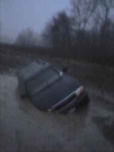

i have a 2000 gmc jimmy 4x4 i went in mud and water and got stuck the truck was sideways in the water on the pass side up to the fender water came in the truck and the right head light was in the water i cant get the front drive shaft to stop turning it wont go in to four wheel drive or just in to 2wd and the lights in side the truck wont come back on to tell me what it is in (like 2wd auto4wheel four wheel hi or low) im not sure what is wrong with this i checked the hoses all look good the actuator seems to work but the cable has no play in it let me now if anyone may no whats wrong[img:2b4bc586bd]http://www.2carpros.com/forum/automotive_pictures/126308_My_Truck_In__1.jpg[/img:2b4bc586bd]

What in the world happened? LOL
Your hubs have an acuator motor that electronicaly engages the hubs. Looks like this electric motor was under water. This may be the cause of your problems.
