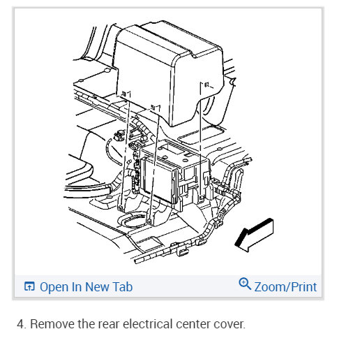

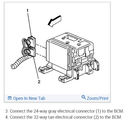

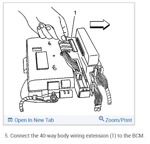

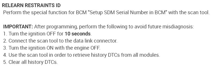

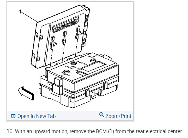

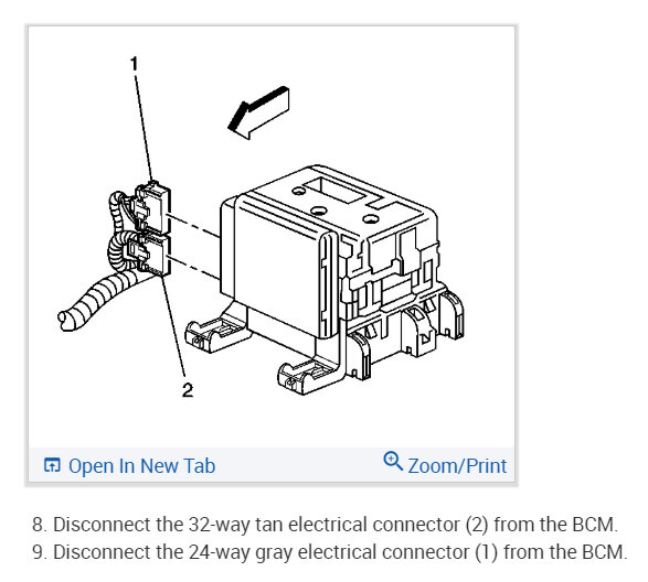

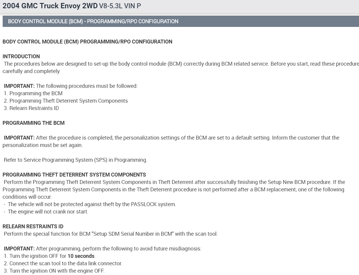

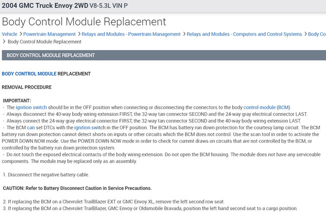

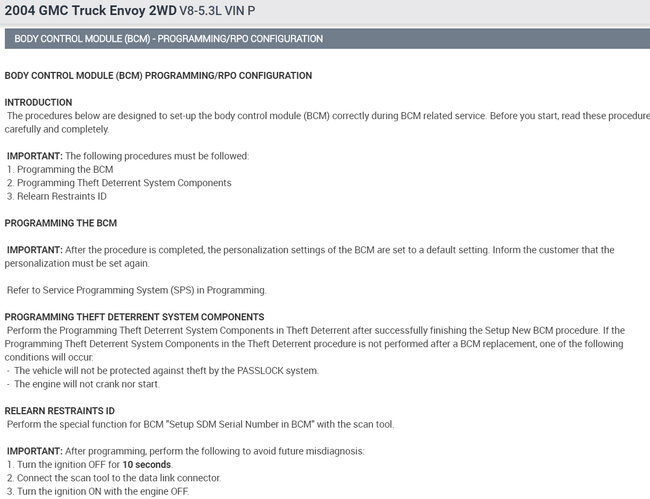

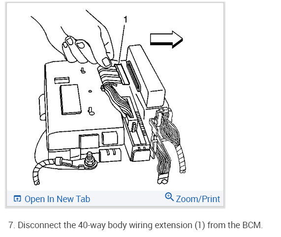

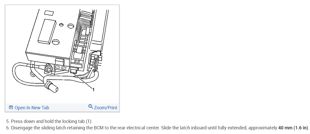

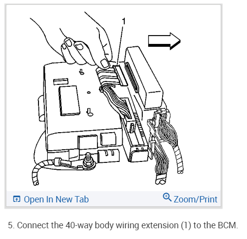

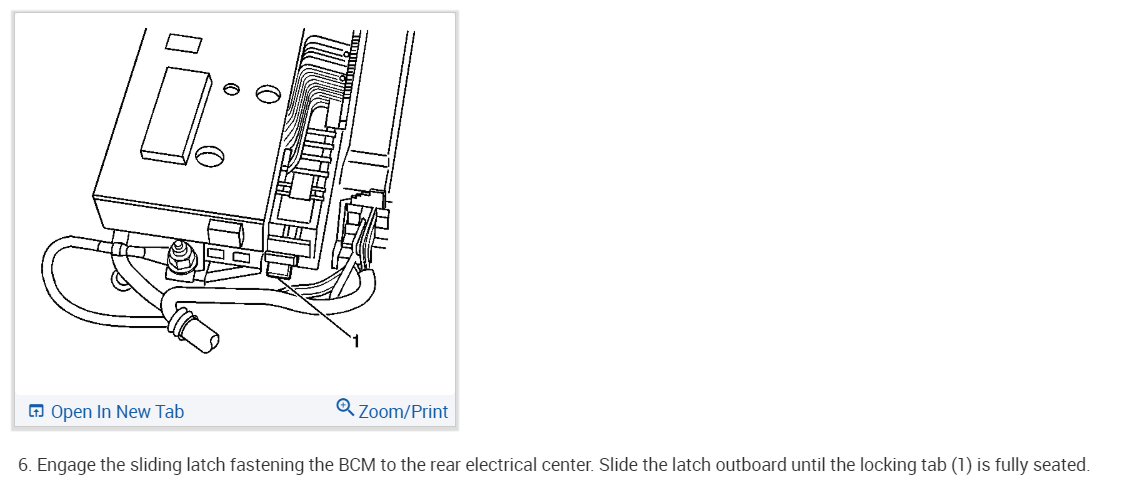

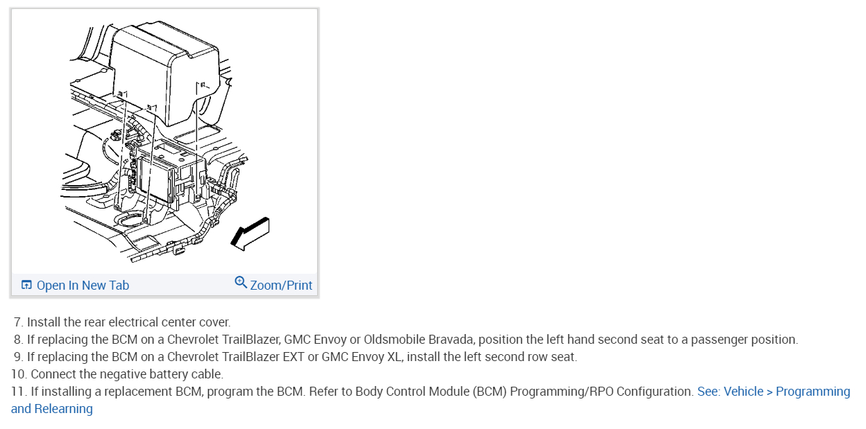

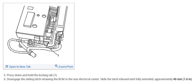

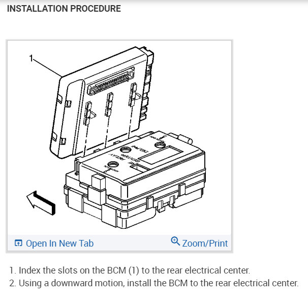

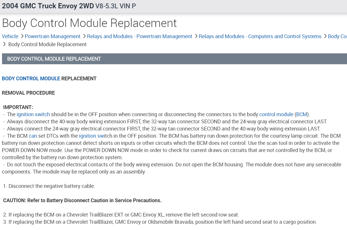

It sounds like you could have a couple different problems, but we should start by doing a CAN scan because it sounds like the BCM is going out. You can get a CAN scanner (Controller Area Network) which will work on most cars from Amazon.
https://youtu.be/u-4syLc-ifQ
Here is how to change the BCM out in case a code comes up for it. You can get a preprogrammed unit by searching Google or Ebay. Check out the images (below). Let us know what happens and please upload pictures or videos of the problem so we can see what's going on.

I have seen the BCM problem be intermittent so I would drive the car to see what happens, maybe it was a bad connection at the BCM and now it is fixed by taking the electrical connectors off and on. Let me know what happens.
