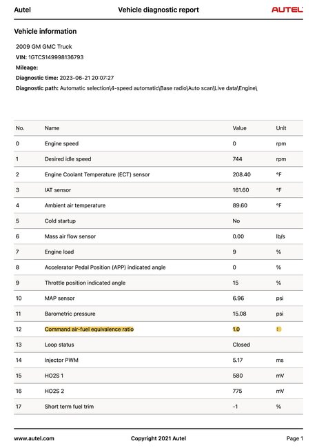

Recently had to replace the crankshaft position sensor (CKP) and attempted to perform a crankshaft variation relearn (P0335). The relearn repeatedly fails. After testing/replacing the ECM, testing the sensor wiring (including the camshaft sensor/wiring), I have discovered the relearn appears to fail due to the OBDII scanner showing "Engine RPM 0" The test appears to fail because the OBDII routine senses the truck is not started and is not idling.
The camshaft and crankshaft sensors are measuring ~750 RPM each. When charted/graphed together each sensor follows the other.The speed sensor (on the transmission) correctly reports the speed of the truck on the road.
When I get to the last page of the crankshaft variation relearn special function in the OBDII, the error message returns something to the effect of 'start engine and idle' before the relearn works. But, the truck is idling.
Swapped OBDII scanner/programmers out. Both return the same error message.
After digging around, every system on the truck passes OK.
Mechanically, the truck has been fully serviced, with no major changes other than brakes, struts, shocks, etc. etc. etc.
However, the Air/Fuel Ratio is stuck at 1:1 and the Engine RPM shows 0 (zero).
With the truck idling (poorly) the RPM is about 750.
I was under the impression the Engine RPM reading is derived from the camshaft and crankshaft sensors. It appears that is not the case.
What I have determined is the relearn test thinks the truck is not even on and idling.

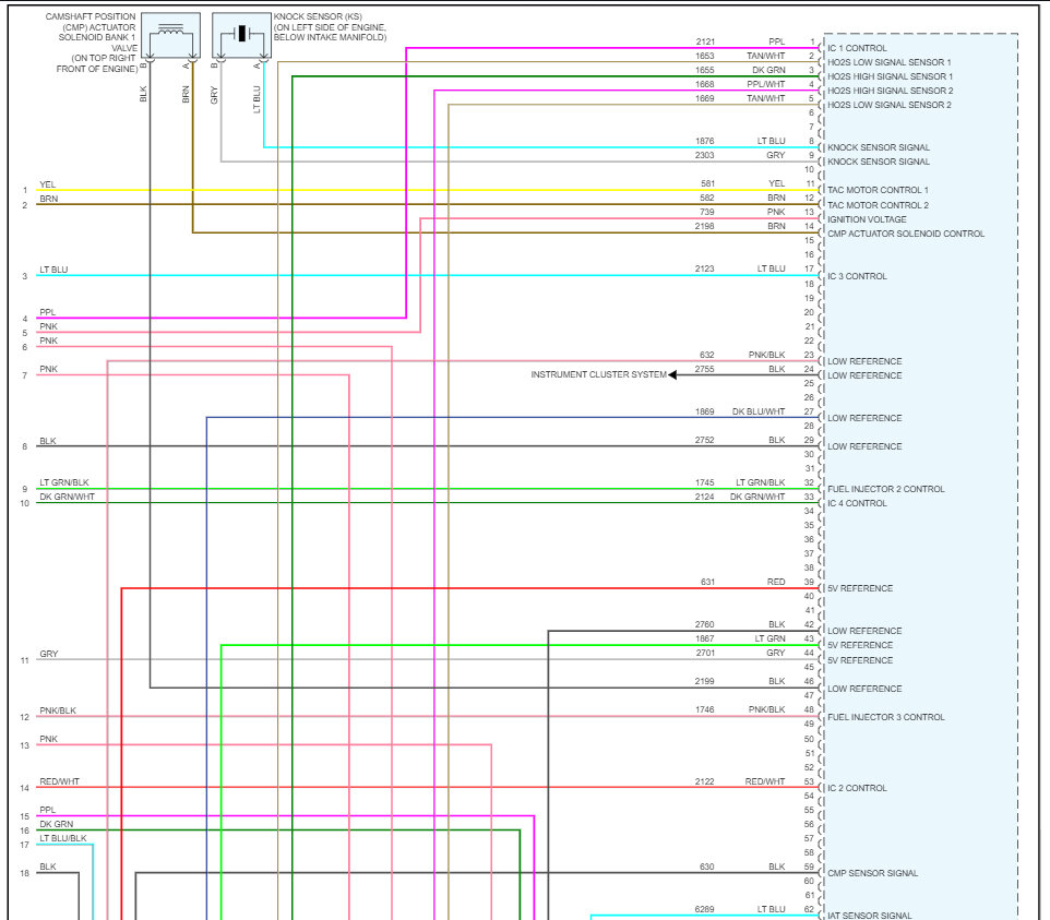

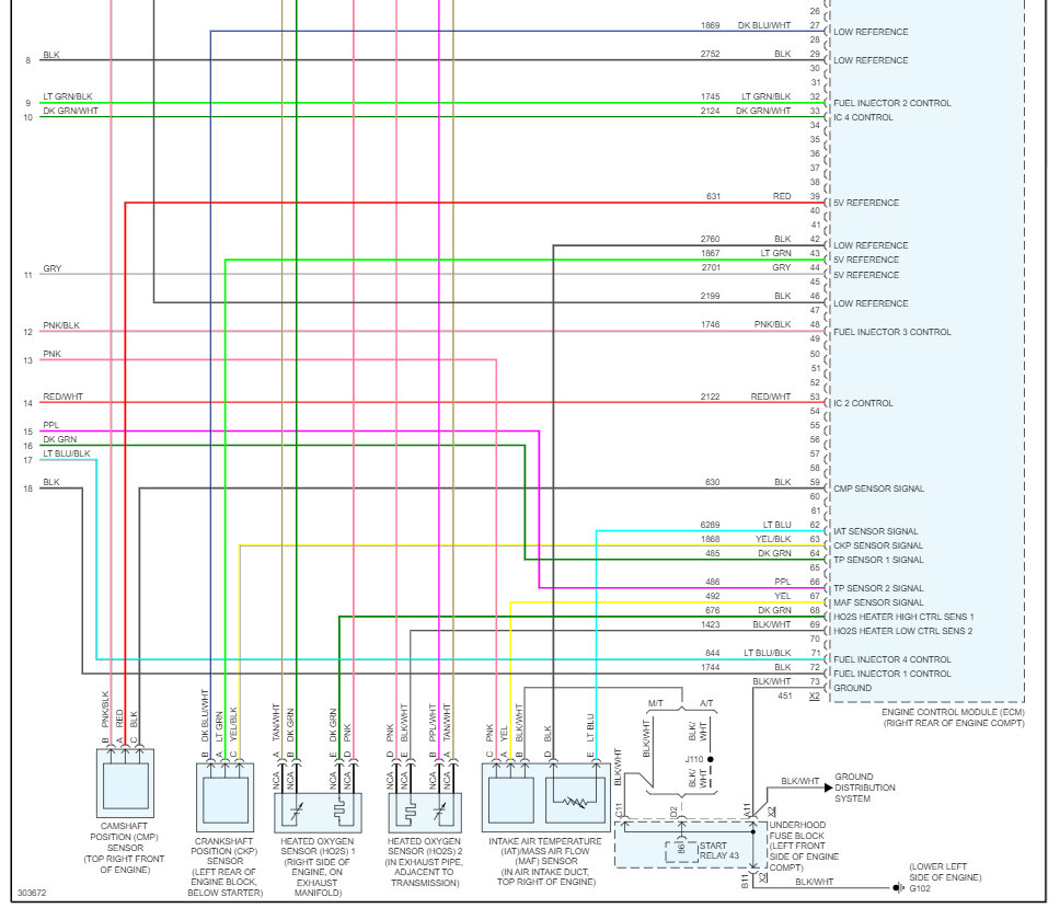

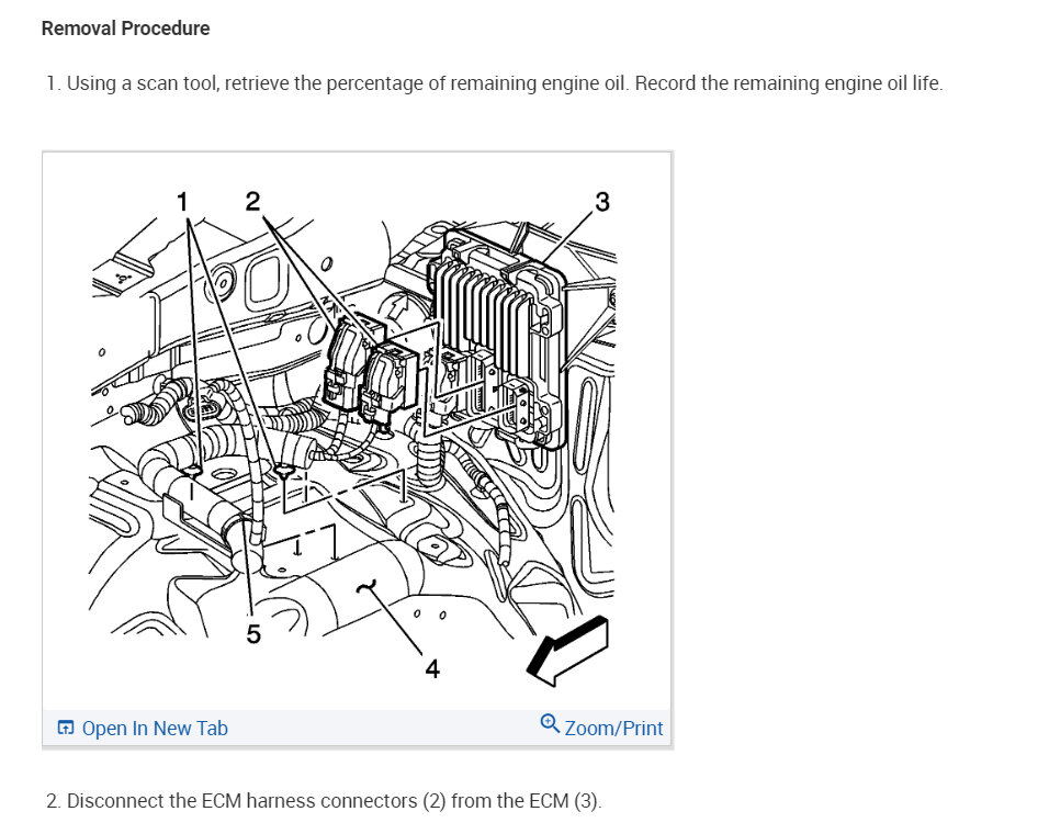

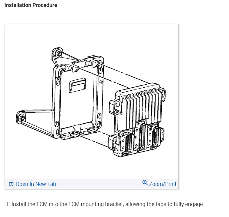

I know you said you replaced the ECM but it still sounds bad, but let's re-check the wiring from the sensors to the ECM here is a guide that can help also I have the crankshaft and camshaft wiring diagrams below so you can see which wires to test and to make sure the wiring connector is correct and in good shape.
Make none of the wires have resistance to ground.
Here is more information on the code:
The P0335 code is a generic diagnostic trouble code (DTC) that indicates a problem with the crankshaft position sensor (CPS).
Check out the images (below). Please let us know how it goes

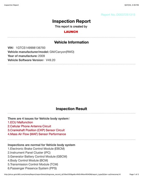

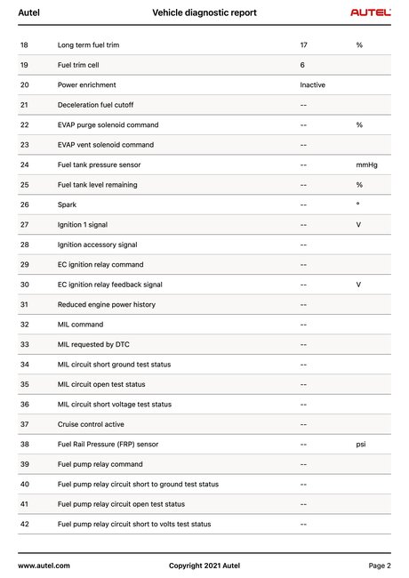

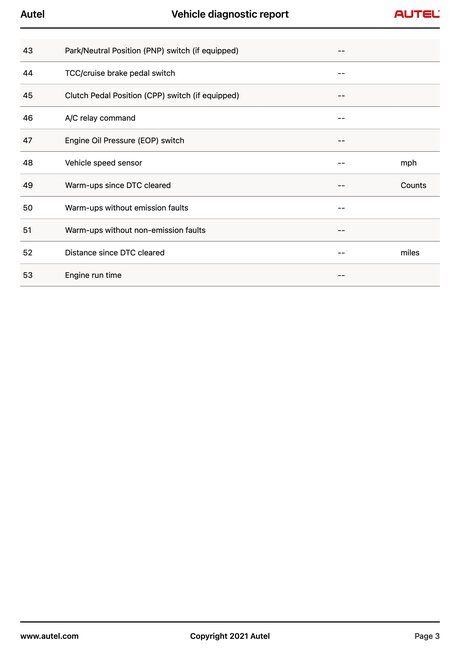

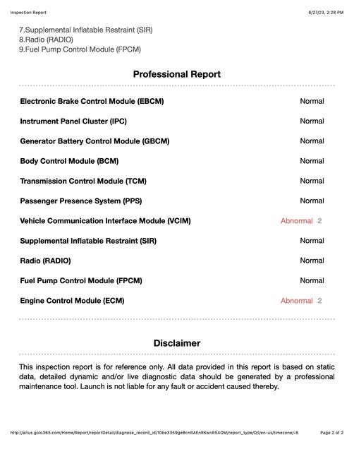

Thanks for the in-depth reply. Having determined the OBDII scanner reads ~750 RPM on the camshaft position sensor (CMP) and the crankshaft position sensor (CKP), I surmise the wiring has no faults. Otherwise, there would be sporadic readings. The readings are rock solid. As a side note, there is a B1000 code in the Vehicle Communication Interface Module (VCIM). There is another code, but it relates to something to do with the On-Star system. I do not subscribe to the On-Star network; however, I thought it was odd there were codes presented. I surmise the codes are related to just the VCIM module. I have come to the conclusion, as you state above, the issue is in the ECM. The one I replaced it with was an aftermarket one. I discovered it was for a 2008 4WD Canyon and I have a 2009 2WD Canyon. It was not programmed for my Canyon. Since then, I have learned more about how these ECMs need to be programmed. Below, are some reports I ran from the OBDII. The Mass Air Flow (MAF) issue was reported because I forgot to reconnect it. That sensor has since been replaced. So far, I believe what I need to do is get an aftermarket ECM programmed for my make, year and model, based upon my VIN, from a reputable company.
I welcome your thoughts and even if you have recommendations for vendors who sell programmed ECMs.

Thank you for the images. It looks like you are on the right track for fixing the vehicle. Please let me know what happens after you get the new PCM installed. The p1000 code should go away as well.
