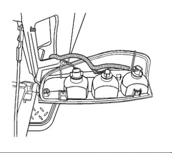

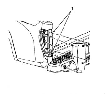

Notes TAIL LAMP ASSEMBLY AND /OR BACKUP, SIDEMARKER, STOP, TURN SIGNAL BULB REPLACEMENT REMOVAL PROCEDURE
https://images.2carpros.com/forum/automotive_pictures/12900_t1_14.jpg
Open the tailgate. Remove the screws from the tail lamp assembly. Remove the lamp assembly.
https://images.2carpros.com/forum/automotive_pictures/12900_t2_10.jpg
Remove the tail lamp and backup lamp sockets, depressing the locking tab and rotating counterclockwise. Remove the bulbs from the tail lamp, backup lamp and/or side marker lamp sockets. https://www.2carpros.com/kpages/auto_repair_manuals_alldata.htm
