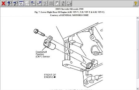

Hello, I have a 2003 2500 hd that has a trouble code of p0336 I am not familar with the GM new models with the 6.0 engine where is the crank position sensor located on the engine.

Its on the lower right rear of engine block see below
https://images.2carpros.com/forum/automotive_pictures/12900_cps_3.jpg
