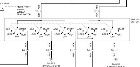

Ok, It may be the ignition switch. When the problem occurs, check ignition fuse A and ignition fuse B in uderhood fuse block, they supply voltage to the ignition switch, red wires at the switch connector.
https://images.2carpros.com/forum/automotive_pictures/170934_ignition_switch_wiring_1.jpg
I wasn't trying to be stingy with the diagram, I have to enlarge to make it readable, when I enlarge, I can only capture part of it.
