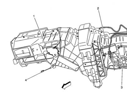

I had the a/c charge, it is cold but not enough air comes out, I replaced the evaporator core thinking it was that but it is the same way, what could it be?

Check the actuators to make sure they are working ok, they may not be, that controls air going through the a/c-heater system. it should be similar to the one in the picture i'm sending. it's under the dash and not eay to get to....
https://www.2carpros.com/forum/automotive_pictures/406719_actuator_4.jpg
