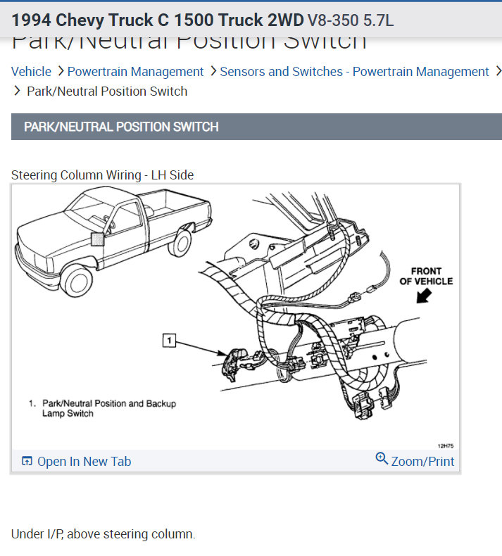

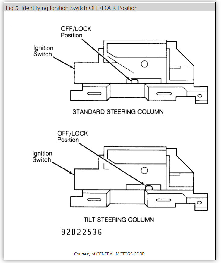

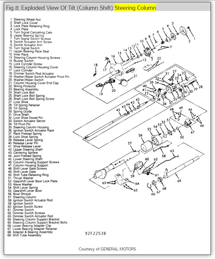

My truck was running just fine until i turned it off yesterday, i tried to start it right after shutting it off but it wouldnt start.....It did not make clicking noises like the battery was dead....all the interior lights came on but no power was getting to starter it seems like could it be the neutral safety switch....where is it located on a 94 gmc sierra
May 27, 2008 at 5:44 AM
MERLIN2021
  • 17,250 POSTS

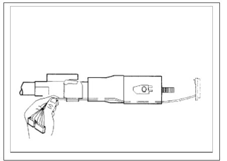

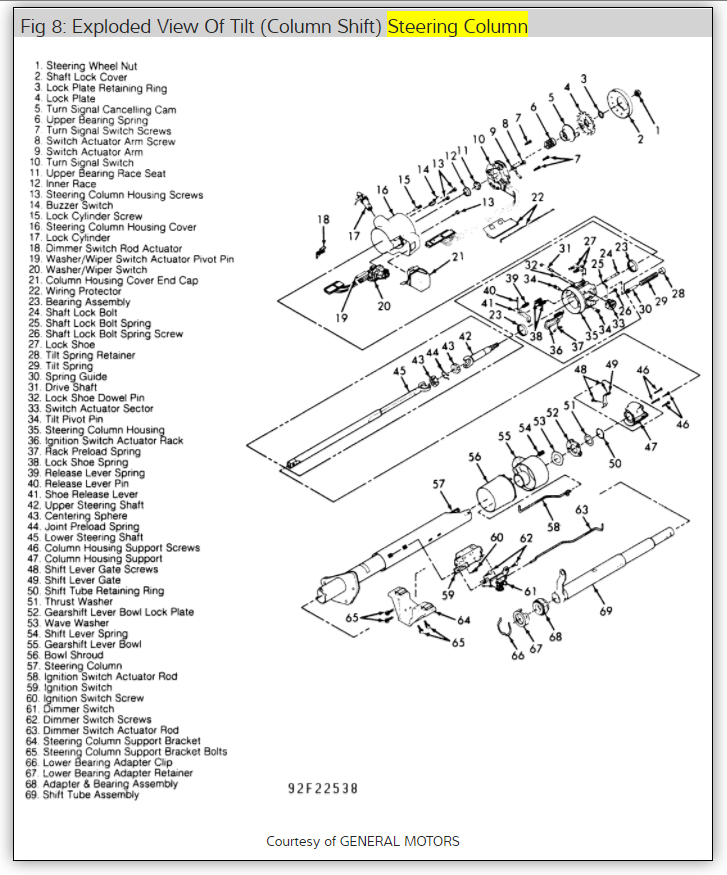

The neutral safety switch is under the dash on the column here are diagrams to show you below. . Please let us know if you need anything else to get the problem fixed..................................................................................
