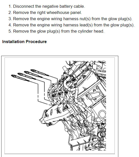

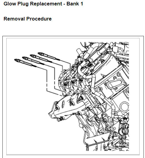

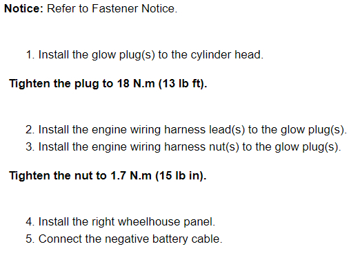

tips to get glow plugs out of Duramax lbz without breaking them.
Nov 26, 2016 at 8:17 AM
  • 55,433 POSTS
Start with the engine warm not hot. Spray WD40 around the glow plugs and let them sit for at least an hour. Then crank them loose two turns then go back in 1 turn continue to do this until they are completely loose.
Here are some diagrams of how the job is done (below)
