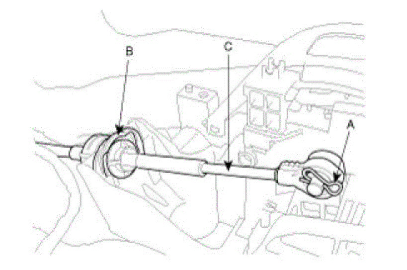

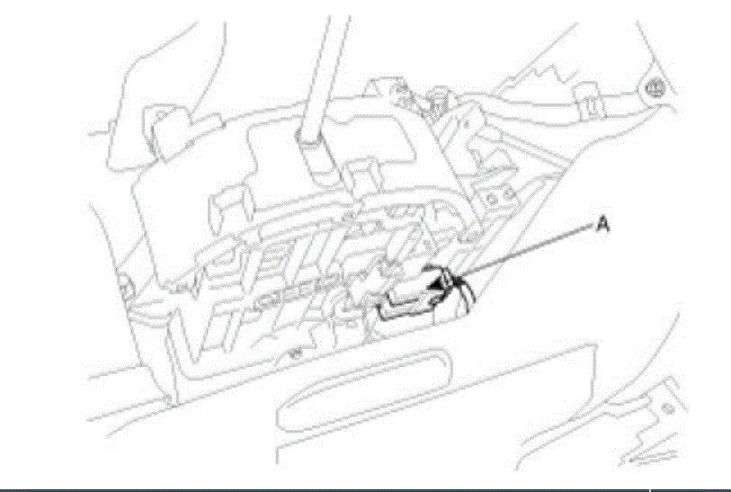

It drives fine, the electronic stability control light comes on while driving. If I try to put in reverse to park it will not move out of drive. I have been lucky and been able to pull into a parking space. Then I can't get it in park. After several minutes of wiggling and pushing the gear back and forth, I get it in neutral I turn the car off then start it back up and put it in park. This has happened 3 times today. I was trapped in my in garage for about 5 minutes because it wouldn't go out of drive.

This sounds like the shift cable is not working correctly.
I attached the procedure for you for replacement.
Removal
1. Remove the center console assembly.

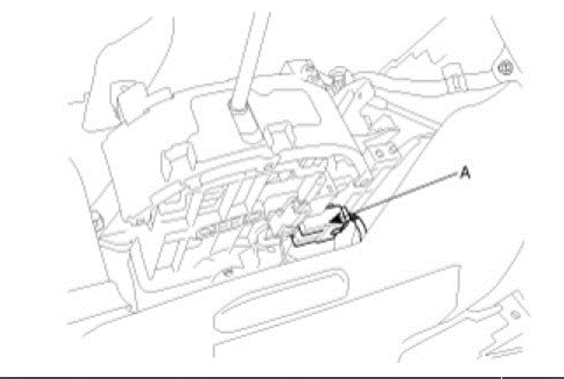

2. Disconnect sports mode connector (A).

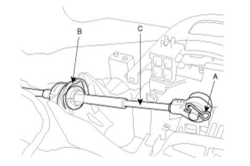

3. Take off the clip (A) and the clamp (B) and then remove the shift cable (C).
4. Remove the shift lever assembly (B) by removing the four bolts (A).
Tightening torque:
8.8 - 13.7 N.m (0.9 - 1.4 kgf.m, 6.5 - 10.1 lb-ft)
