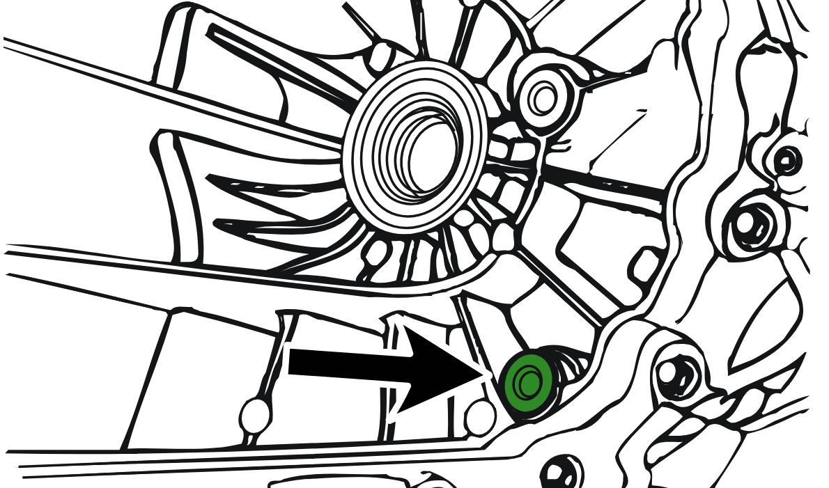

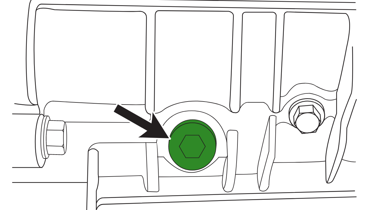

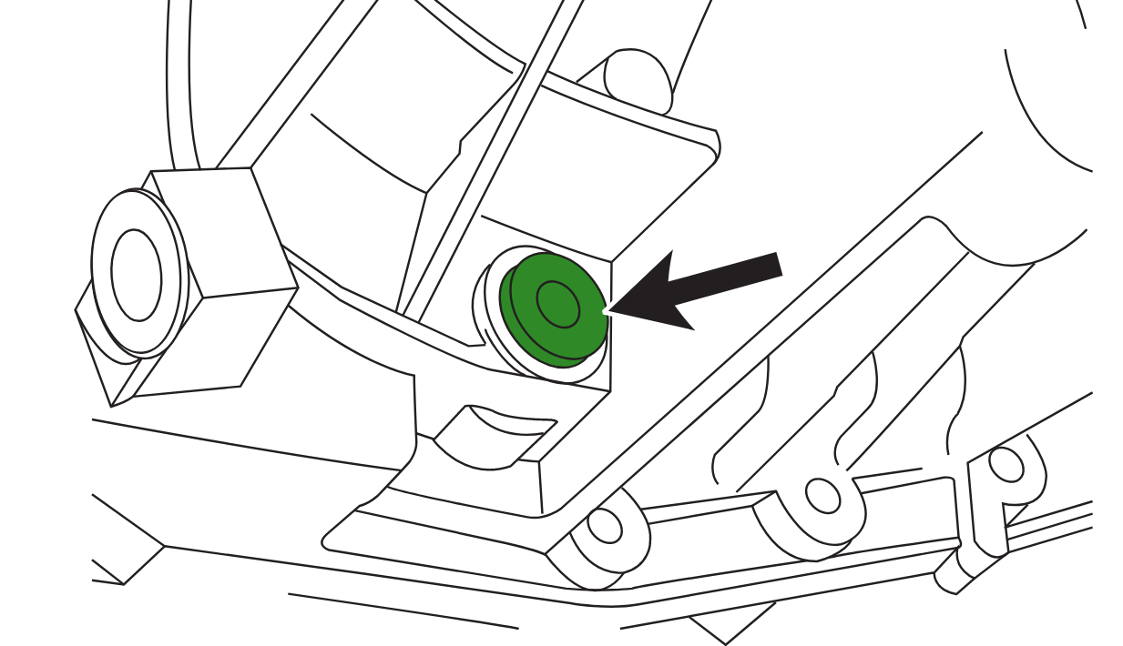

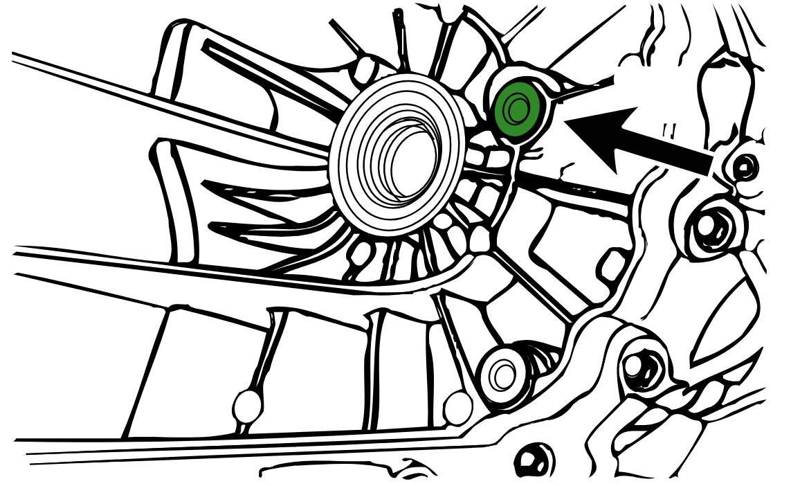

Hallo, I need to change the gearbox oil on this car, can you send me a step-by-step guide?

There are 2 types of manual transmission fitted to this vehicle.
A 5 or 6 speed transmission.
Both use the same specification transmission oil SAE75W,
Ford WSS-M2C200-D2
The 5-speed unit has a 1.9L capacity, the 6 speed 1.75L capacity.
Drain and fill plug locations are in images below.
Image 1+2 for 5 speed transmission, 3+4 for 6 speed transmission.
How to service a manual transmission:
https://www.2carpros.com/articles/how-to-service-a-manual-transmission
Hope this helps.
Cheers, Boris
